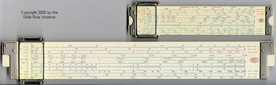

My first introduction to a slide rule was something my father used as a navigator/bombardier during WWII. I never did figure out how to use all its features, but it was circular, about six inches diameter, and therefore equivalent to about an 18-inch linear slide rule. See a picture of it here (front and back sides) and also below:
Much later, as a teenager, I purchased a metal linear slide-rule mail-order from Lafayette Electronics in the 1950s. And much later than that (while attending college) I was able to afford a very nice bamboo slide-rule manufactured by Post, their 1460 Versalog, which competed with the K&E Log-Log Duplex Decitrig but sold for less. I still have this slide rule and take it out of its case to admire it once in awhile. Below is a picture of my Post slide rule, the one on the bottom:
I never could justify purchasing the smaller "pocket size" slide rule shown in the above picture, but admired the engineers I knew who owned one.
As it turned out, I also carried around the eleventh edition of "Mathematical Tables from the Handbook of Chemistry and Physics" published by Chemical Rubber Publishing Company. This fine little (almost pocket sized) text had five decimal-place tables of logarithms and logarithms of trigonometric functions, as well as several other function tables with somewhat less precision. When the first "four banger" calculator with tiny red LED displays from Texas Instrument appeared I bought one, because the major disadvantage of using a slide rule was it didn't add or subtract numbers. That calculator, when used with the mathematical tables, allowed me to solve just about any engineering problem. The slide rule pretty much languished after that, and was replaced permanently when the first "scientific" calculators appeared. Again, I chose Texas Instruments for my first scientific calculator, but I toyed off and on with Hewlett-Packard RPN calculators, and once owned an HP 35 and later an HP 65, complete with magnetic card reader/writer. Eventually both HP calculators were stolen, so I dropped back to inexpensive Casio calculators and very expensive personal computers for my mathematical calculations.
And that's where things have remained, computation-wise, as I skated into the 21st Century.
Just thought I would get that off my chest... maybe I am getting old(er).
