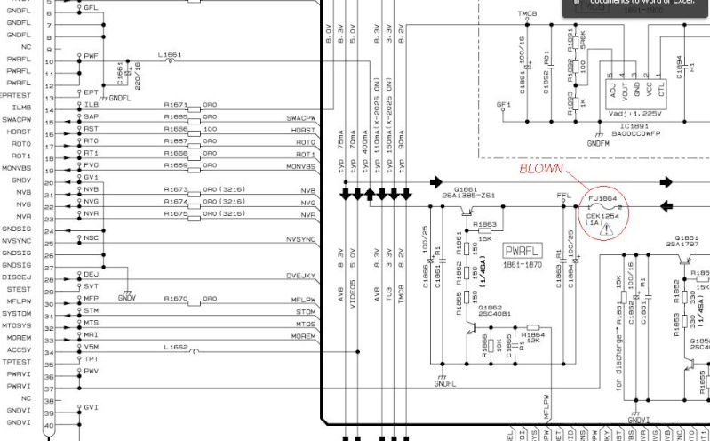

UPDATE:
I decided to test the voltages on the monitor board and found all voltages to read low. The 5v regulator had no input so i traced it back to the main board and found a blown SMD fuse rated at 1A. I have uploaded at snap shot of the circuit diagram. FU1864 was blown and i have checked C1863 and C1864 for short circuit but both test ok. I will continue testing. I have to order some SMD fuses but while i wait can i solder in a larger 1A rated fuse to test the circuit?
markm6164
Jan 22, 2012
118
Jan 22, 2012
118

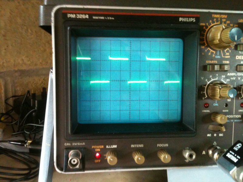

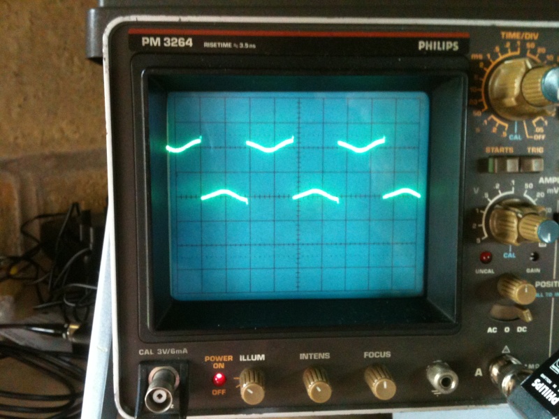

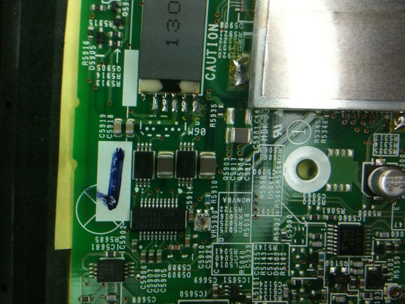

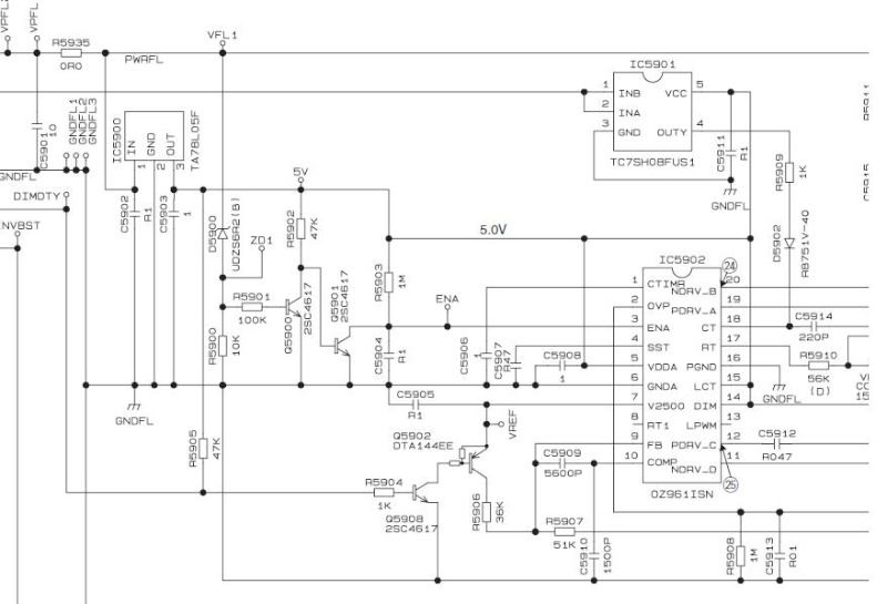

Ok so i replaced the 1A SMD fuse but it hasn't made any difference to my original fault but all the TP voltages are good now. I have scoped the output signal from the two switching mosfets.
Here is a picture of the inverter circuit (not much use)
Here is the output of the fet Q5903 after the capacitors. I measured it at the transformer pin 3.
Here is the output of the other fet Q5904 which has no capacitors in circuit. i measured this at the transformer pin 5.
The scope is set to 0.5v per division but my scope probes are x10 attenuated so thats 5v per division. The time base is set to 5µs per division.
The signal can only be measured for a few seconds at power up when the back light briefly comes on then turns off and won't come on.
If the cold cathode tube was at fault wouldn't i still get a signal there even it it doesn't light? Seems to me the tube isn't being driven??
I really need some help with this please.

The AVIC-D3 is a car audio unit with touch screen. The backlight for the screen is a cold cathode fluoresent lamp. When i power the unit the backlight comes on for about 2 seconds the shuts down. Everything else works because if i put a seperate light source behind the display i can see clearly everything on the display and the touch screen responds. It just seems to be the backlight that isn't on.
The back light is driven by a OZ961ISN ccfl driver chip. I can't find a data sheet for this only the OZ962 16pin driver chip. The OZ961 drives two TS8M1 fet chips which provide a square wave 50kHz signal to the boost transformer to drive the ccfl. I can't find the ccfl specs sorry but in a previous post i have included a link and download to the service manual, which is very good, with relevent pages listed. Also i have provided 2 pdf's of just the inverter circuit.
A post from another user suggested the ccfl may have failed hence why i want to power the ccfl to see if infact it has failed. The signal i measued, on a previous post, is when the screen lights and i measured it from the transformer primary side. The 50Khz signal i get corresponds to what the service manual describes in the adjustments section. There is no signal there when the ccfl isn't lit. If it was just a faulty ccfl would the signal still be there all the time? The driver chip has a feed back circuit and overload protection circuit. Maybe this is why the screen shuts down or maybe the ccfl is infact faulty.

The enable pin (pin3) on the driver chip has a 5v feed all the time. If i short out the ''enable pin'' pin 3 on the driver chip the chip shuts down. When i remove short the driver chip restarts and the backlight comes on then turns straight off. It like its sensing a fault with the over voltage protection but on the ovp pin when the backlight lights i read 4v and when the backlight is off i read 0v.
markm6164
Jan 22, 2012
118
Jan 22, 2012
118
I got this unit working guys. I found i had 4v on pin 10 of the OZ961 driver chip. The threshold is 2.75v i believe. Anyways i connected a LED from pin 10 to ground and now everything works perfect. Anyone got any thoughts on a true fix? I might leave led in if not. All seems ok with it in. Not sure on life of led in there though.
