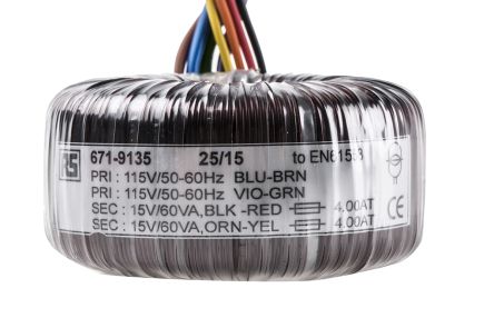

I have found a nice toroidal: http://www.communica.co.za/Catalog/Details/P4292902673 I have never played with a toroidal before. They say nothing about input so I hope it's 220V in. Will have to phone them Monday.

The voltage from the little transformer is too high for the opamps in the cheapo Chinese kit. but then the opamps will burn out before the overloaded little transformer burns your house down.

@Audioguru.: Thanks for replying. I am sure you are dreading what this thread could turn into.
Are you talkig about the transformer I chose?

The little 50VA toroidal transformer will burn up when it powers the new kit and the output of the kit is 2A.
The peak voltage from the transformer is 1.414 x 30V= 42.4V that the rectifier bridge uses to charge the main filter capacitor. When the DC output of the kit is 2A then the transformer must supply 42.4V x 2A= 84.8VA.

The voltage from the 2x25V transformer is too low at 25V and it is too high at 50V.
You need a transformer that produces 28V at 119VA or 30V at 127VA.Then if the circuit is modified to the latest improvements it will reliably produce 30VDC at 3A. But I do not think the larger more reliable parts will fit on the Chinese pcb.

Apologies for this question but is there any leeway in the VA numbers?

Looks like its 60 VA per secondary winding, or 4 A at only 15 VAC. That's waay too small for a 30 V, 3A power supply. See @Audioguru post #36.
