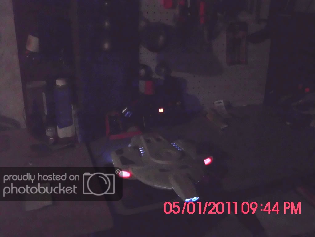

Update:
After completing the power supply used to test the models on the bench I have gotten the first model painted and wired. I am just starting on sealing the seams but she's lit up. I started with this one because it was extremely simple to light and good practice for a noob. 2 jumbo white led's and one 3.3 white for the nose.
The U.S.S. Defiant
Now before I can mount this in the Star Trek Room, I need to wire that room and get another 6v power supply. I have found that I can purchase a 6v wall wart that will push 1.5 or 2A so that will be the way to go. No need to modify another ATX power supply for that.
