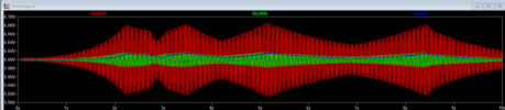

Maglatron
Jul 12, 2023
2,025
Jul 12, 2023
2,025
so I have noticed that the envelope detector still envelops the smaller signal which I think is wrong red is output from the filter, green is after the pre-amp and before the amp and the dark blue is the envelope, surely it should be enveloping the red!!1702214393739.png1702213770632.png
the colour in the middle of the blue is actually green although it doesn't look it, it is the signal from the pre-amp the blue is after the amplifier are the numbers good? room for improvement?(bottom pic)

bertus
Nov 8, 2019
3,877
Nov 8, 2019
3,877
Hello,
To much signal gets lost in the capacitors C15 and C17 at 45 Hz.
Increase the value to 10 uF and see the result.
Bertus

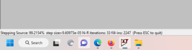

cool thats good I've run into a small problem my ltspice program is not showing the black box when I press run do you know how to fix?
Maglatron
Jul 12, 2023
2,025
Jul 12, 2023
2,025
so I've put it in the way the image was shown I put 1k for the Rx how do I get the black box back !!??

Maglatron
Jul 12, 2023
2,025
Jul 12, 2023
2,025
the black box won't appear but it's running in the bottom left corner without errors1702219621666.png1702219588078.png
bertus
Nov 8, 2019
3,877
Nov 8, 2019
3,877
Hello,
I seem not to have the LM3914 for the simulation.
Bertus
