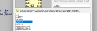

Hello,
Yes, I have the ZZZ collection. In wich folder is the LM3914?
Bertus

Hello,
LTspice is showing that it can not find the LM3914 on my side.
Bertus

I am still having the black box problem and for your problem with the LM3914 I don't know not sure can I give it to you??

I am still having the black box problem and for your problem with the LM3914 I don't know not sure can I give it to you?? extension .asy
when I hit run the box isn't popping up

turned the computer off and on again and it is working again now but dead slow it's ok back to normal! did you get the file for the LM3914 that I sent, I sent it as .txt file you need to change the extension back to .asy!!
