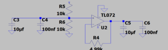

so heres the files of the 6kHz wav and asc, It doesn't look like it's doing the job!

so here, how do I set the gain so that the millivolts from the signal is enough to be read by the lm3914
also if you can remind me how to link a power supply to the filter circuit power without connecting with leads I've forgot REF too

so I have written out all of the combined resistors and the capacitors for the series of frequencies you provide from 45 to 7000 hz took a while may sound stupid because its really novice but what are the type of capacitors in the buffer circuit (they're not polorized)

Hello,
The TL072 is the dual version of the TL074.
I have an alternate setup for your spectrum display.
In stead of making 16 amplifiers between the filter and detectors, you could make one amplifier in front of all 16 filters:
Bertus

ok makes sense what would be a good amplification factor??? thanks oh I just read (3-4 times)

In spice, I want to create a point on the buffer called ref, and connect the refs of the filters to it without wires also the same with the 12v power supply I did it before but forgotten how!

when the original signal is 31.4millivolts and times by 4 only gives 0.1256, and you said that the range is from 0 to 2.4v, 0.1256 is only 5.23% of 2.4 am I missing something here?

Hello,
Line level for consumer audio is about 0.9 Vpp:
With a gain of 5 the peak would be about 0.45 X 5 = 2.25 Volts.
The VCC+ is 12 Volts, VCC- is 0 Volts. REF would be 6 Volts.
