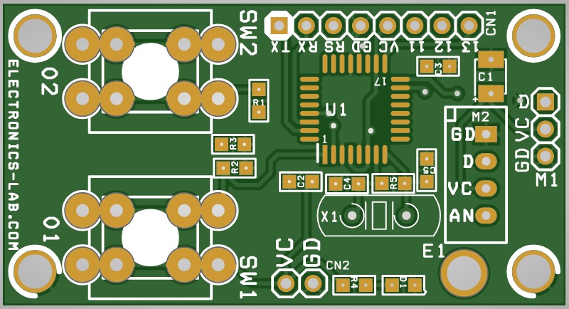

This is a two-channel RF Transmitter unit that consists of, Atmega328 microcontroller, 2 Tactile switches with pull-down resistors, a programming port, and a 315Mhz RF transmitter module. It is an Arduino compatible open-source project that can be used for many RF transmitter applications.
This is a two-channel RF Transmitter unit that consists of, Atmega328 microcontroller, 2 Tactile switches with pull-down resistors, a programming port, and a 315Mhz RF transmitter module. It is an Arduino compatible open-source project that can be used for many RF transmitter applications. It is advisable to use 1 Foot hook-up wire as Antenna to enjoy a maximum range of the transmitter.

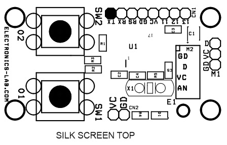

Arduino Pins: D3, D4 Tactile Switch and D12 data out for AM transmitter
Note1: The PCB is compatible with 2 types of RF modules, 3-Pins or 4-Pins. Use a suitable connector as per module.
Note2: This project is compatible with our 1 channel RF relay board. The Arduino code is available as a download for the transmitter.
  • Supply 5V DC @ 20mA
  • 2 Tactile Switches with Pulldown Resistors
  • PCB Dimensions 52.71 x 28.26mm

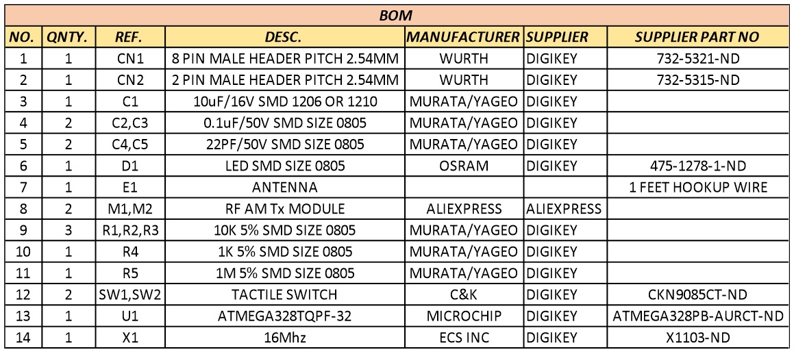

Parts List
NO.QNTY.REF.DESC.MANUFACTURERSUPPLIERSUPPLIER PART NO
11CN18 PIN MALE HEADER PITCH 2.54MMWURTHDIGIKEY732-5321-ND
21CN22 PIN MALE HEADER PITCH 2.54MMWURTHDIGIKEY732-5315-ND
31C110uF/16V SMD 1206 OR 1210MURATA/YAGEODIGIKEY
42C2,C30.1uF/50V SMD SIZE 0805MURATA/YAGEODIGIKEY
52C4,C522PF/50V SMD SIZE 0805MURATA/YAGEODIGIKEY
61D1LED SMD SIZE 0805OSRAMDIGIKEY475-1278-1-ND
71E1ANTENNA1 FEET HOOKUP WIRE
82M1,M2RF AM TX MODULEALIEXPRESSALIEXPRESSFS1000A ALIEXPRESS
93R1,R2,R310K 5% SMD SIZE 0805MURATA/YAGEODIGIKEY
101R41K 5% SMD SIZE 0805MURATA/YAGEODIGIKEY
111R51M 5% SMD SIZE 0805MURATA/YAGEODIGIKEY
122SW1,SW2TACTILE SWITCHC&KDIGIKEYCKN9085CT-ND
131U1ATMEGA328TQPF-32MICROCHIPDIGIKEYATMEGA328PB-AURCT-ND
141X116MhzECS INCDIGIKEYX1103-ND

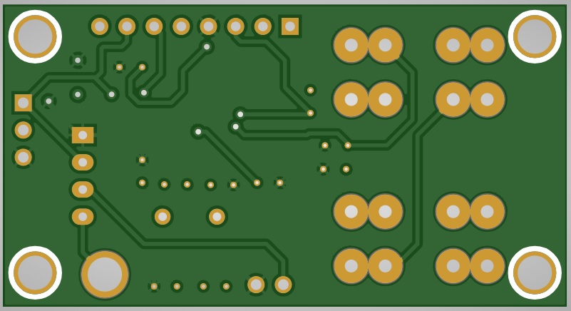

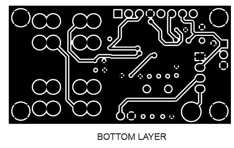

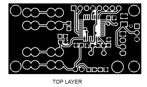

Gerber View
