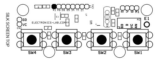

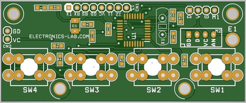

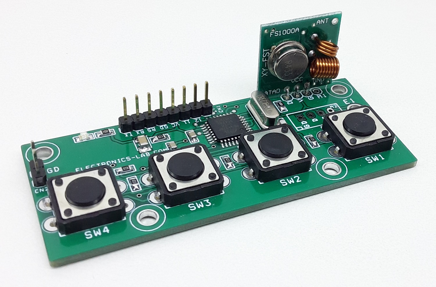

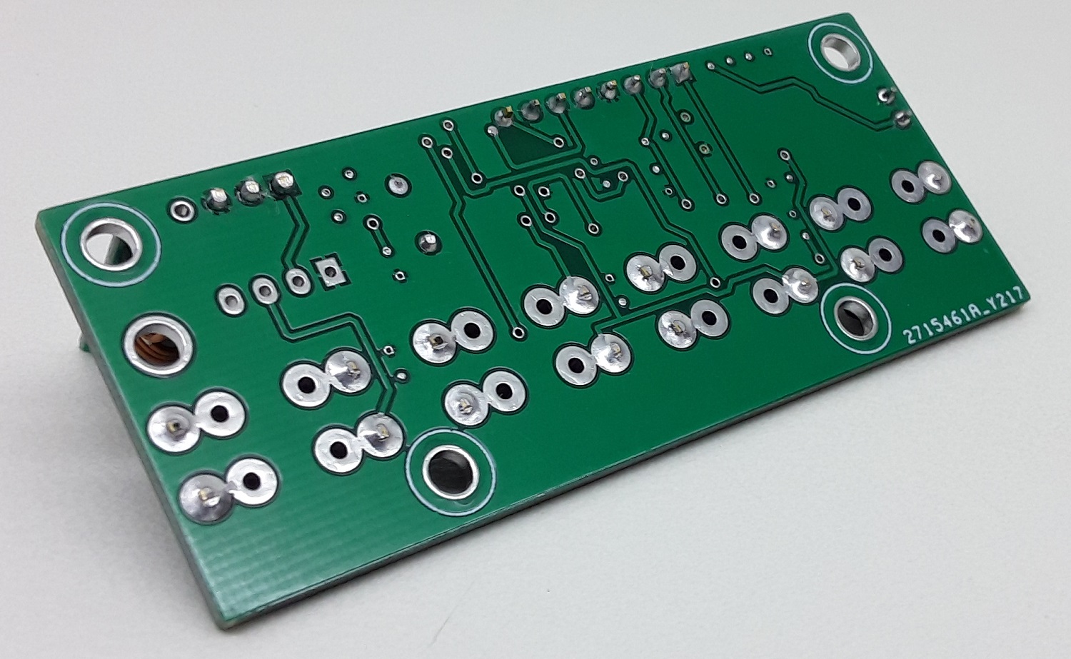

This is a 4 channel RF Transmitter unit that consists of an Atmega328 microcontroller, 4 x tactile switches with pull-down resistors, programming port, and 315Mhz RF transmitter module. It is Arduino compatible open-source project that can be used for many RF transmitter applications.
This is a 4 channel RF Transmitter unit that consists of an Atmega328 microcontroller, 4 x tactile switches with pull-down resistors, programming port, and 315Mhz RF transmitter module. It is Arduino compatible open-source project that can be used for many RF transmitter applications. It is advisable to use a 30cm hook-up wire as an antenna to enjoy a maximum range of the transmitter.

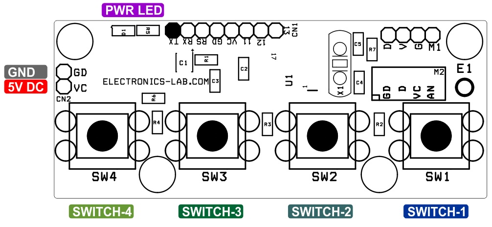

Arduino Pins: D3, D4, D5, D6 Tactile Switch, and D12 data out for AM transmitter module.
- Supply 5V DC @ 20mA
- 4 Tactile Switches with Pulldown Resistors
- PCB dimensions 75.09 x 30.80 mm
Applications

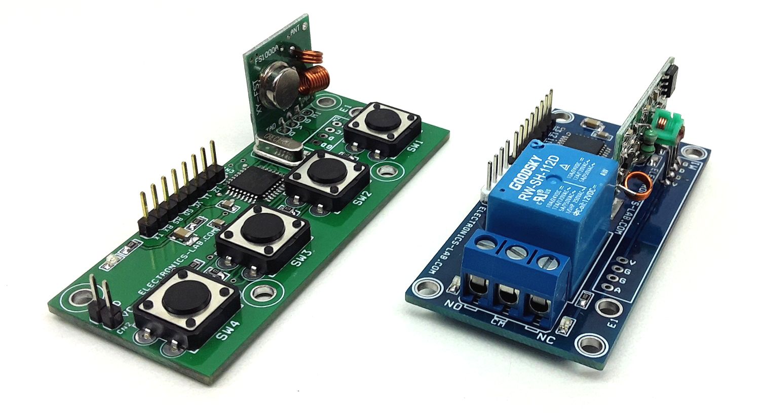

- RF Remote ON/OFF AC or DC loads like Fans, Lights, Home Appliances, Door control. This transmitter is compatible with 315Mhz RF Remote Receiver with On-Board Relay.
Arduino Code

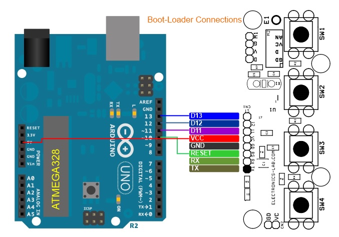

Arduino Code is available as a download. The code works with a single SW1, it toggles the Receiver Relay when the switch is pressed. A new Atmega328 chip requires a Bootloader and Arduino firmware, check the link below to learn more about programming the new Atmega328.
Transmitter PCB has an onboard programming port.
https://www.arduino.cc/en/Tutorial/BuiltInExamples/ArduinoToBreadboard

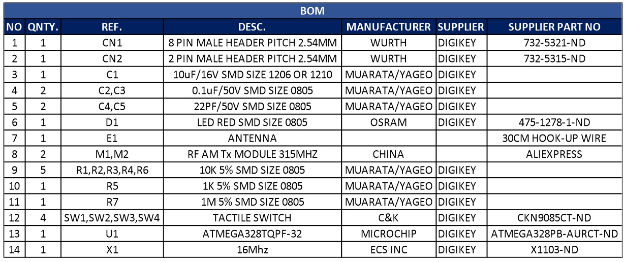

Parts List
| NO | QNTY. | REF. | DESC. | MANUFACTURER | SUPPLIER | SUPPLIER PART NO |
| 1 | 1 | CN1 | 8 PIN MALE HEADER PITCH 2.54MM | WURTH | DIGIKEY | 732-5321-ND |
| 2 | 1 | CN2 | 2 PIN MALE HEADER PITCH 2.54MM | WURTH | DIGIKEY | 732-5315-ND |
| 3 | 1 | C1 | 10uF/16V SMD SIZE 1206 OR 1210 | MUARATA/YAGEO | DIGIKEY | |
| 4 | 2 | C2,C3 | 0.1uF/50V SMD SIZE 0805 | MUARATA/YAGEO | DIGIKEY | |
| 5 | 2 | C4,C5 | 22PF/50V SMD SIZE 0805 | MUARATA/YAGEO | DIGIKEY | |
| 6 | 1 | D1 | LED RED SMD SIZE 0805 | OSRAM | DIGIKEY | 475-1278-1-ND |
| 7 | 1 | E1 | ANTENNA | 30CM HOOK-UP WIRE | ||
| 8 | 2 | M1,M2 | RF AM TX MODULE 315MHZ | CHINA | FS1000A ALIEXPRESS | |
| 9 | 5 | R1,R2,R3,R4,R6 | 10K 5% SMD SIZE 0805 | MUARATA/YAGEO | DIGIKEY | |
| 10 | 1 | R5 | 1K 5% SMD SIZE 0805 | MUARATA/YAGEO | DIGIKEY | |
| 11 | 1 | R7 | 1M 5% SMD SIZE 0805 | MUARATA/YAGEO | DIGIKEY | |
| 12 | 4 | SW1,SW2,SW3,SW4 | TACTILE SWITCH | C&K | DIGIKEY | CKN9085CT-ND |
| 13 | 1 | U1 | ATMEGA328TQPF-32 | MICROCHIP | DIGIKEY | ATMEGA328PB-AURCT-ND |
| 14 | 1 | X1 | 16Mhz | ECS INC | DIGIKEY | X1103-ND |
Connections
