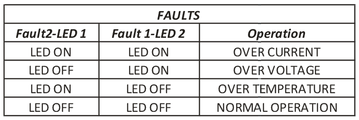

  • Fault LED for Over Current, Thermal & Under Voltage Conditions

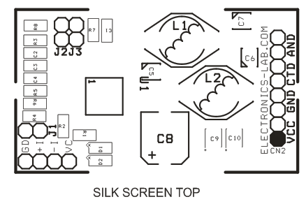

  • When J3-Jumper is closed, the board is configured for 500-kHz operation.
Connections
  • J2-Jumper closed for normal operation
  • J1-Jumper closed for normal operation when the jumper is open device goes into shutdown mode

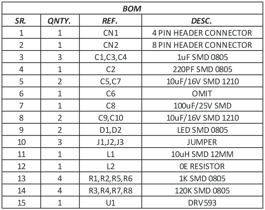

Parts List

Fault Table

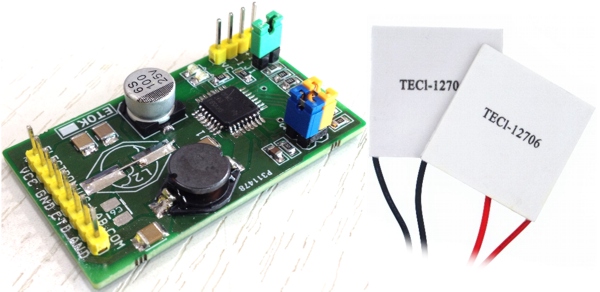

Photos
