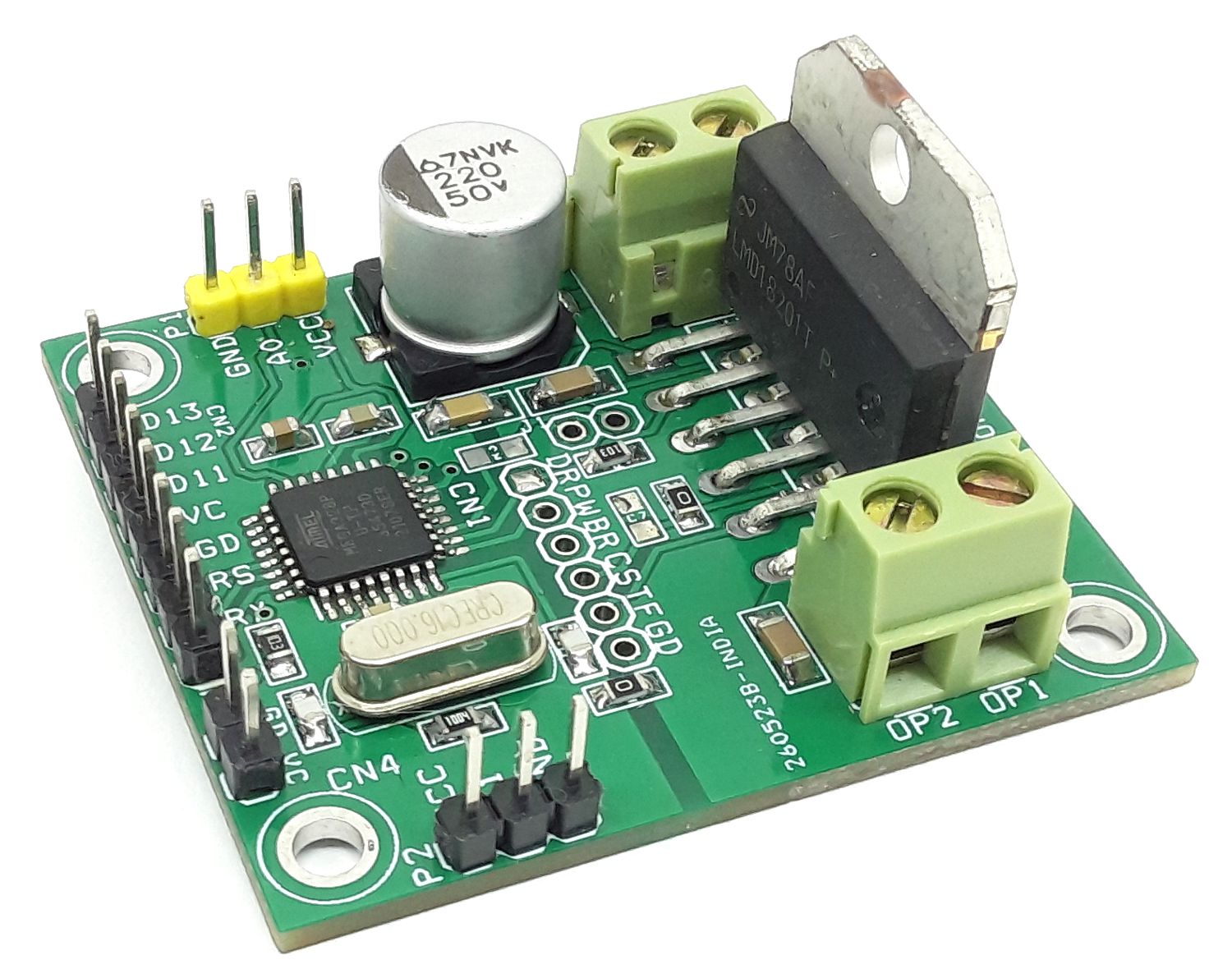

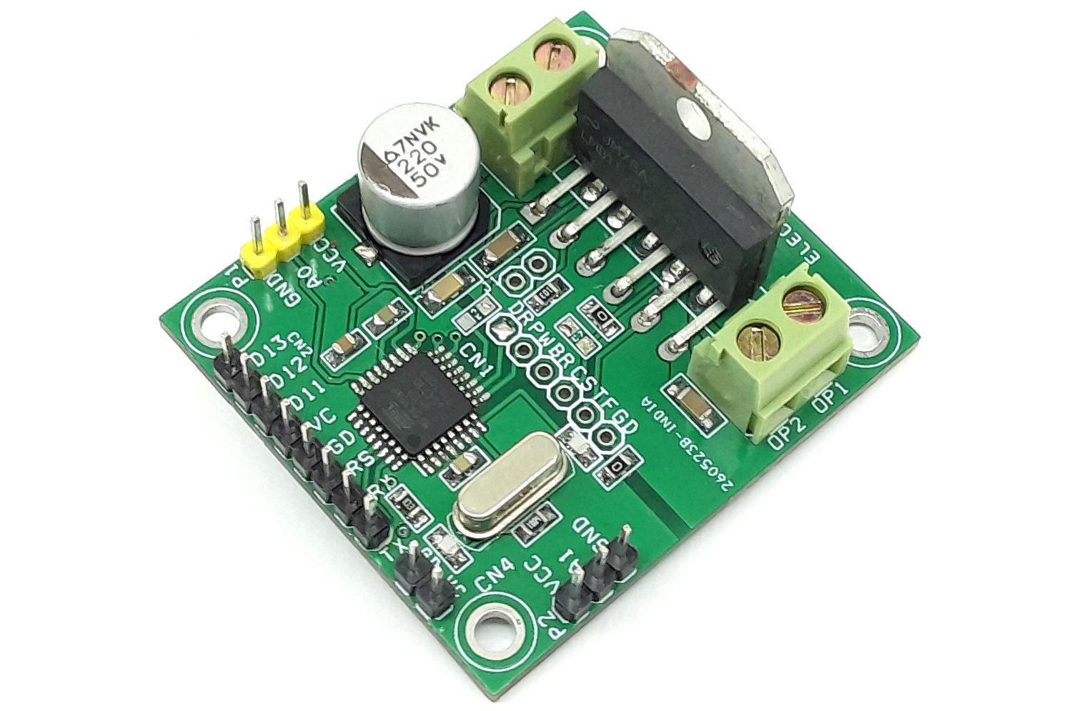

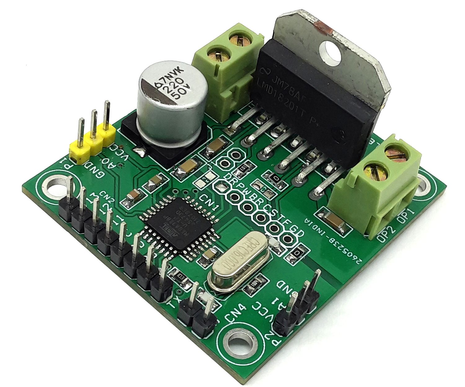

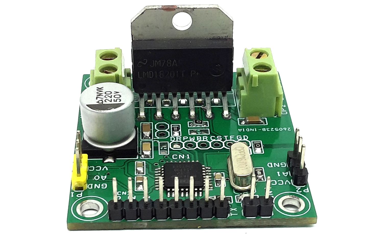

The project presented here is an Arduino-compatible motor control board. The board consists of an ATMEGA328 microcontroller, LMD18201 H-Bridge, and 2 x potentiometers.
Motor Control by mixos

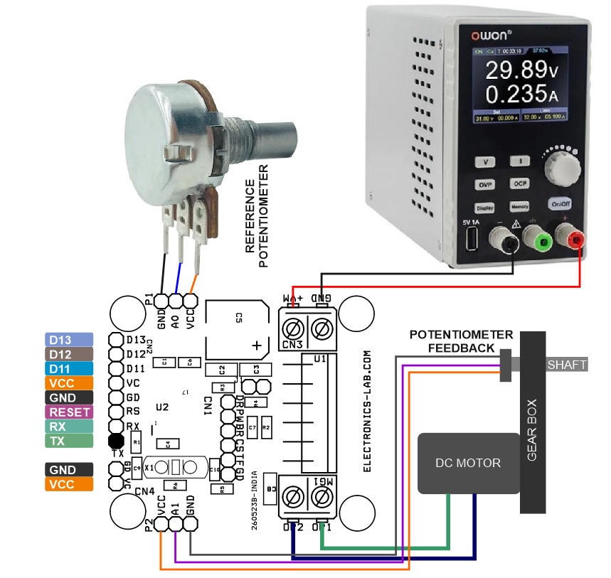

The project presented here is an Arduino-compatible motor control board. The board consists of an ATMEGA328 microcontroller, LMD18201 H-Bridge, and 2 x potentiometers. This closed-loop servo system provides position control using a feedback potentiometer mounted on the output shaft of the gearbox and provides position control by turning the shaft of the reference potentiometer, the motor-gearbox output shaft follows the reference potentiometer. The project can also be used in other applications that require Arduino-compatible hardware and H-Bridge.
The project requires a special mechanism, where the DC motor’s output shaft is mechanically coupled with the potentiometer shaft using a reduction gear. Approx. reduction ratio 15-50: 1. When the reference pot is turned, the motor shaft follows the position. This will provide a maximum rotation of 270 degrees. Multi-rotation is possible with the help of a multiturn potentiometer.

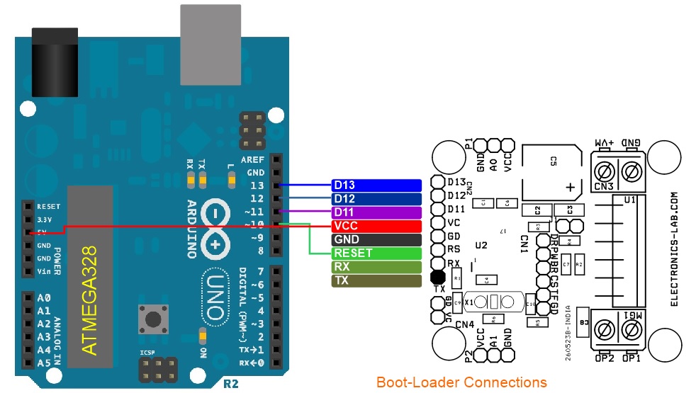

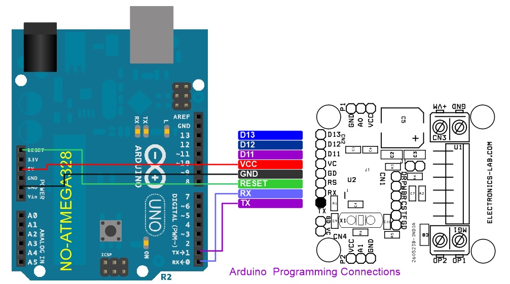

Arduino example code is available and the board can be programmed using the CN2 connector, the same connector helps burn the boot-loader to a new ATMEGA328 chip.
Refer to the following link for more info about Arduino programming: https://docs.arduino.cc/built-in-examples/arduino-isp/ArduinoToBreadboard

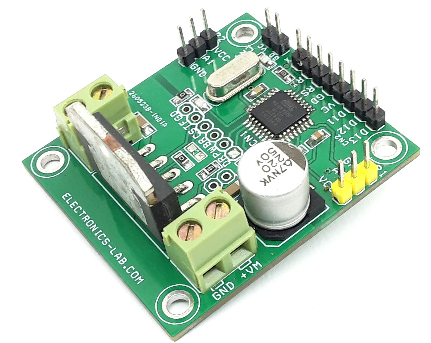

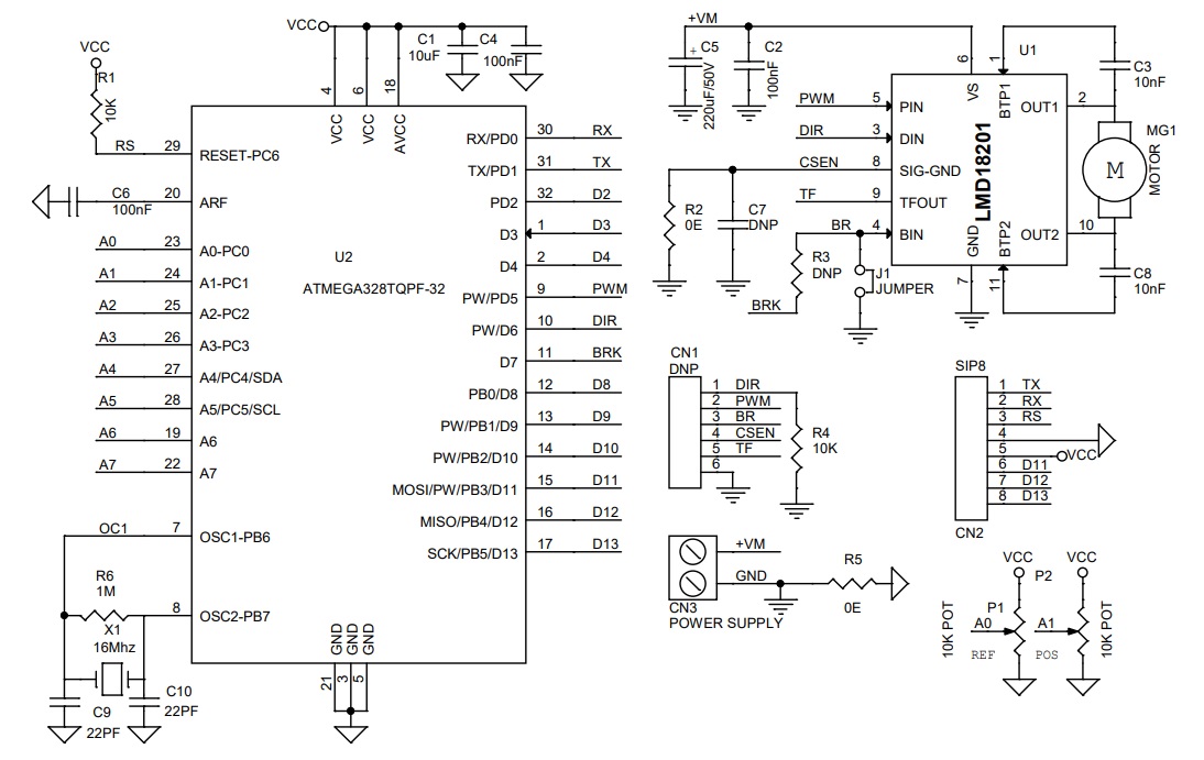

Arduino Pins vs H-Bridge LMD18201
  • Arduino D5 = PWM
  • Arduino D6 = Direction
  • Arduino D8 = Brake (Not Used -Optional)
  • Arduino A0 Reference Potentiometer, A1 Feedback Potentiometer
  • Power Supply Motor 12V to 40V (48V Max)
  • Motor Load 3A (Peak 6A)
  • Logic Supply 5V DC @ 20mA
  • On Board Jumper J1 for Brake, Closed for Normal Operations
  • On Board Programming Connector for Arduino IDE
  • Screw Terminals for Motor and Power Supply
  • 2 X 3 Pin Male Header for Feedback and Reference Potentiometers
  • Arduino Compatible
  • PCB Dimensions 47.63 x 42.55mm
  • 4 x 3MM Mounting Holes

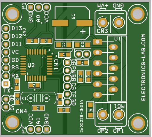

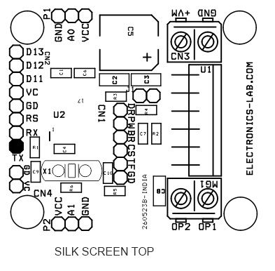

Connection & Other Details
  • CN1: Optional Do Not Install
  • CN2: Programming Connector Pin 1 = Tx, Pin 2 = Rx, Pin 3 = Reset, Pin 4 = GND, Pin 5 = VCC, Pin 6 = D11, Pin 7 = D12, Pin 8 = D13
  • CN3: Pin 1 = Motor Power Supply, Pin 2 = GND
  • MG1: Pin 1 = Motor 1, Pin 2 = Motor 2
  • P1: Reference Potentiometer
  • P2: Feedback Potentiometer
  • J1: the jumper must be closed to enable the Brake for normal operation.
Schematic

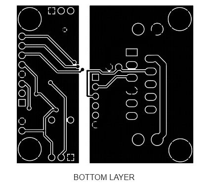

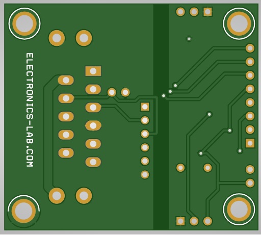

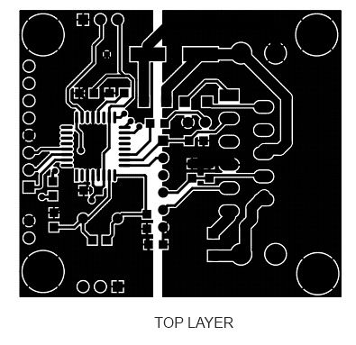

Gerber View
