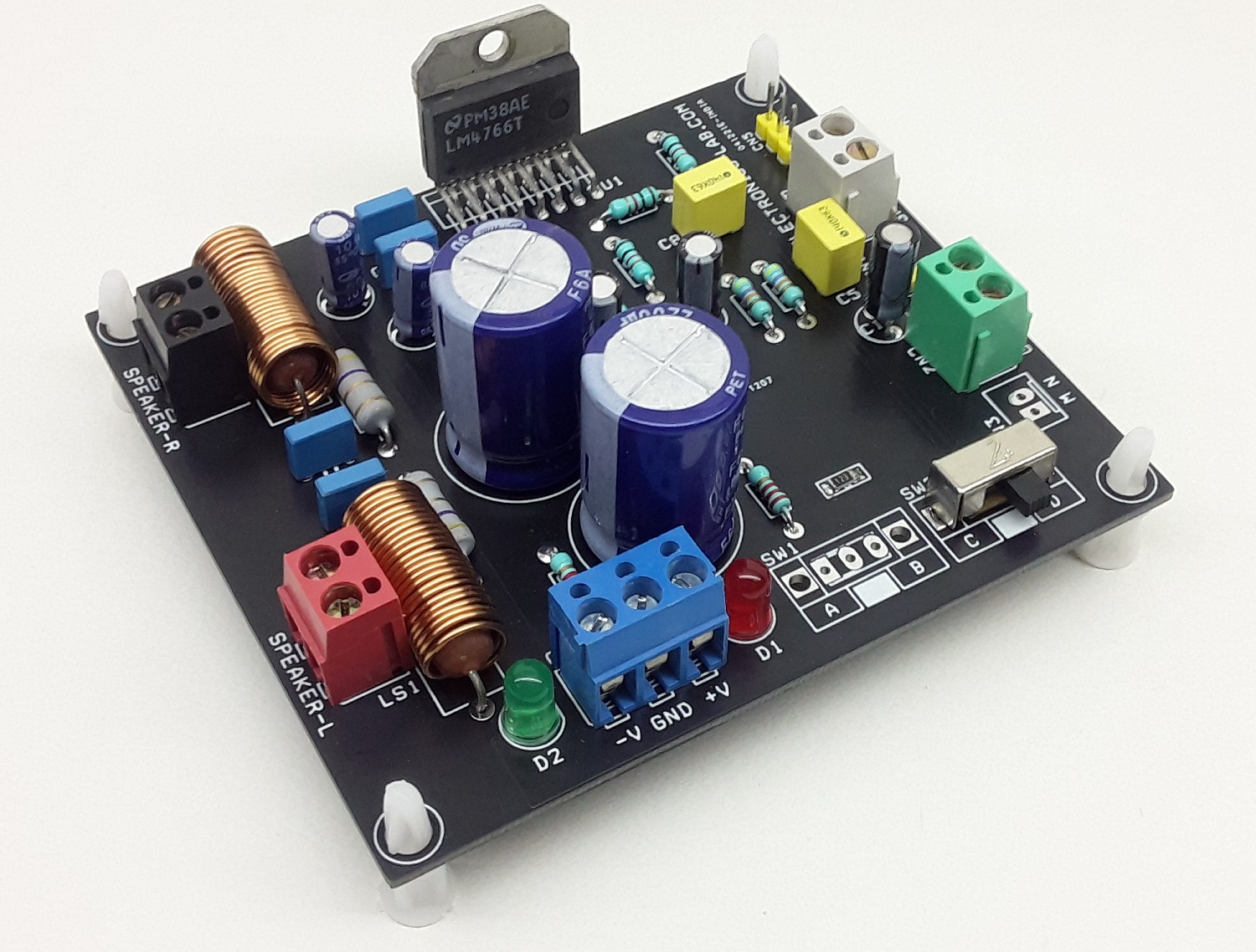

The stereo audio amplifier project shown here is capable of delivering typically 40W per channel continuous average output power into an 8Ω load with less than 0.1% (THD+N). The project is built using an LM4766 chip from Texas Instruments, The performance of the LM4766, utilizing its Self-Peak Instantaneous Temperature (°Ke) (Spike) Protection Circuitry, places it in a class above discrete and hybrid amplifiers by providing an inherently, dynamically protected Safe Operating Area (SOA).
The stereo audio amplifier project shown here is capable of delivering typically 40W per channel continuous average output power into an 8Ω load with less than 0.1% (THD+N). The project is built using an LM4766 chip from Texas Instruments, The performance of the LM4766, utilizing its Self-Peak Instantaneous Temperature (°Ke) (Spike) Protection Circuitry, places it in a class above discrete and hybrid amplifiers by providing an inherently, dynamically protected Safe Operating Area (SOA). Spike Protection means that these parts are safeguarded at the output against overvoltage, undervoltage, overloads, including thermal runaway and instantaneous temperature peaks. Each amplifier within the LM4766 has an independent smooth transition fade-in/out mute that minimizes output pops. The IC’s extremely low noise floor at 2µV and its extremely low THD+N value of 0.06% at the rated power make the LM4766 optimum for high-end stereo TVs or mini-component systems.

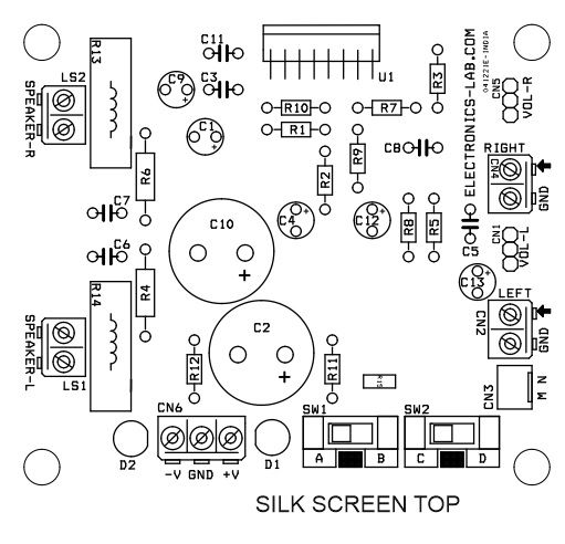

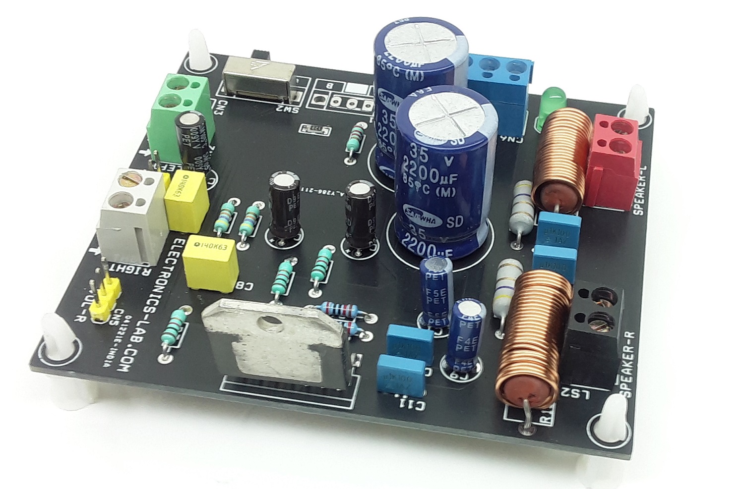

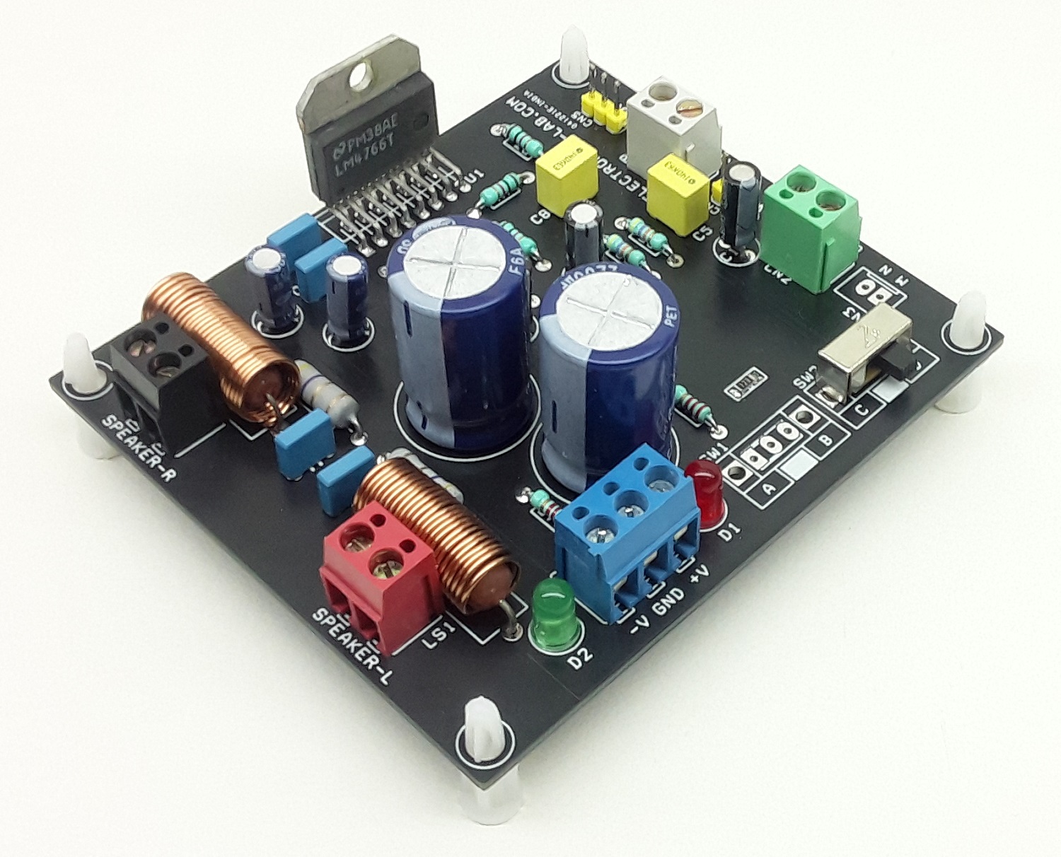

- Inductor L1 and L2: L1 and L2 Inductors: wind 20 turns around resistors R13 and R14 with 1 mm Enameled Copper Wire.
- Heatsink: It is advisable to use a large-size heatsink with a fan for IC, refer to the datasheet of LM4066 for heatsink calculation.
- Volume Control – Potentiometer: Use Shielded wire for a 10K potentiometer to avoid unusual noise.
Connections

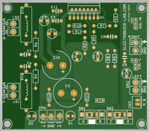

- Screw Terminal Connector LS1: Speaker Connection Left Channel
- Screw Terminal Connector LS2: Speaker Connection Right Channel
- Screw Terminal CN6: Power Supply Input Maximum Dual 32V DC (+/-32V DC)
- Screw Terminal CN2: Audio Signal Input Left
- Screw Terminal CN4: Audio Signal Input Right Channel
- 3 Pin Header Connector CN1: 10K Ohms Trimmer Potentiometer – Volume Control Left Channel
- 3 Pin Header Connector CN5: 10K Ohms Trimmer Potentiometer – Volume Control Right Channel
- Switch 2 Slide Switch: Mute Function
- LED1 and LED 2: Power LEDs

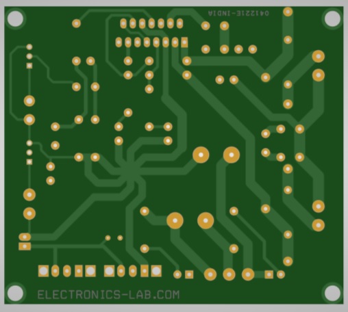

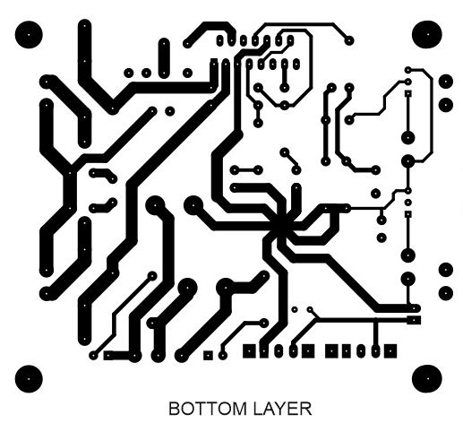

- PCB Dimensions 93.35 x 81.92 mm

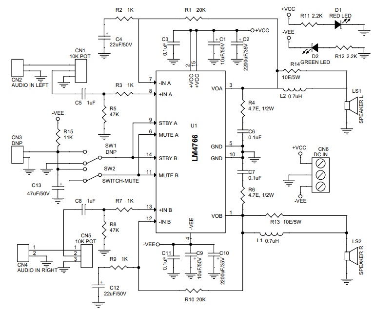

Slide Switch 2 is provided to apply mute operations. The muting function of the LM4766 allows the user to mute the music going into the amplifier by drawing more than 0.5mA out of each mute pin on the device.

Schematic

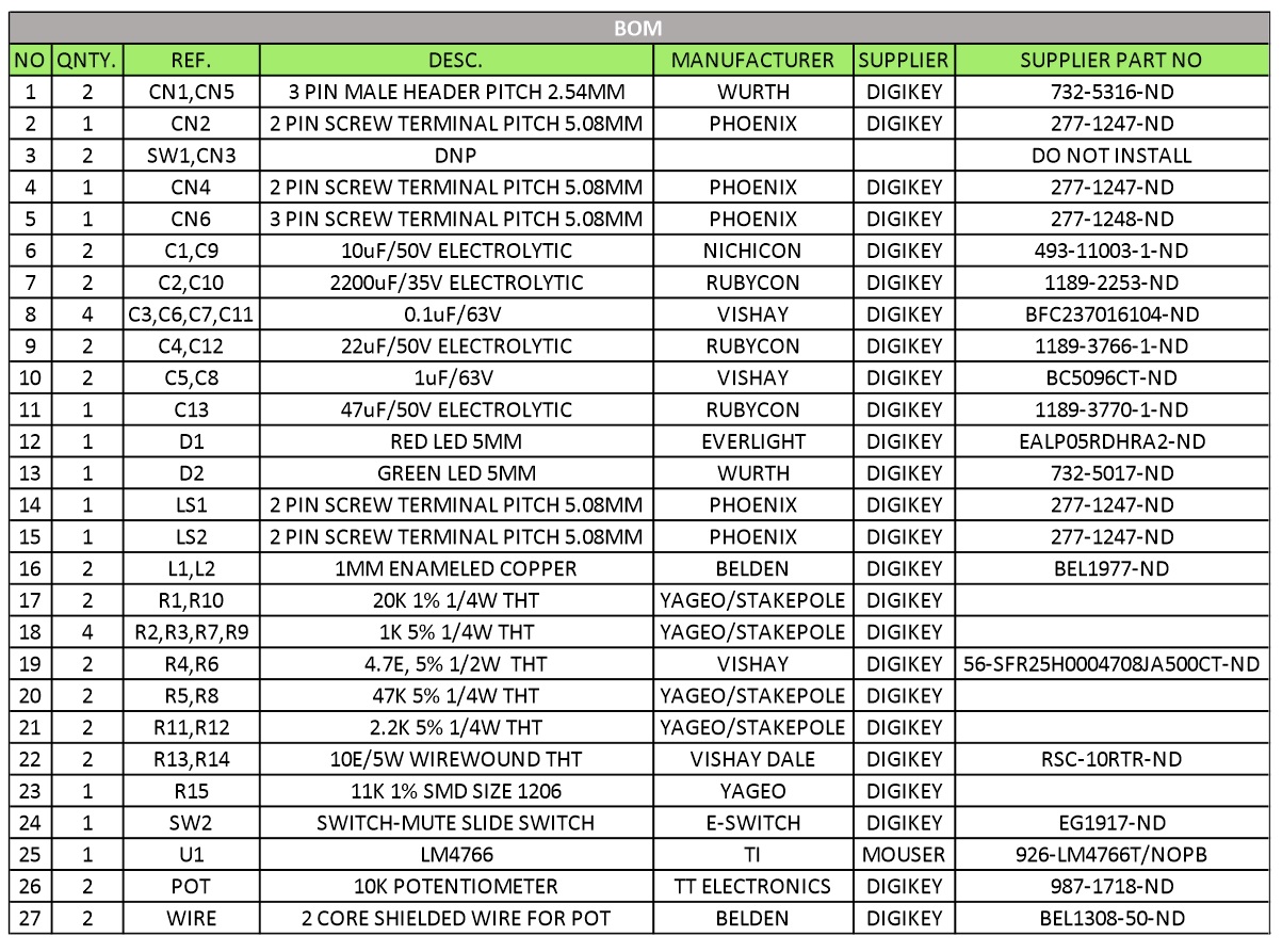

Parts List
| NO | QNTY. | REF. | DESC. | MANUFACTURER | SUPPLIER | PART NO |
| 1 | 2 | CN1,CN5 | 3 PIN MALE HEADER PITCH 2.54MM | WURTH | DIGIKEY | 732-5316-ND |
| 2 | 1 | CN2 | 2 PIN SCREW TERMINAL PITCH 5.08MM | PHOENIX | DIGIKEY | 277-1247-ND |
| 3 | 2 | SW1,CN3 | DNP | DO NOT INSTALL | ||
| 4 | 1 | CN4 | 2 PIN SCREW TERMINAL PITCH 5.08MM | PHOENIX | DIGIKEY | 277-1247-ND |
| 5 | 1 | CN6 | 3 PIN SCREW TERMINAL PITCH 5.08MM | PHOENIX | DIGIKEY | 277-1248-ND |
| 6 | 2 | C1,C9 | 10uF/50V ELECTROLYTIC | NICHICON | DIGIKEY | 493-11003-1-ND |
| 7 | 2 | C2,C10 | 2200uF/35V ELECTROLYTIC | RUBYCON | DIGIKEY | 1189-2253-ND |
| 8 | 4 | C3,C6,C7,C11 | 0.1uF/63V | VISHAY | DIGIKEY | BFC237016104-ND |
| 9 | 2 | C4,C12 | 22uF/50V ELECTROLYTIC | RUBYCON | DIGIKEY | 1189-3766-1-ND |
| 10 | 2 | C5,C8 | 1uF/63V | VISHAY | DIGIKEY | BC5096CT-ND |
| 11 | 1 | C13 | 47uF/50V ELECTROLYTIC | RUBYCON | DIGIKEY | 1189-3770-1-ND |
| 12 | 1 | D1 | RED LED 5MM | EVERLIGHT | DIGIKEY | EALP05RDHRA2-ND |
| 13 | 1 | D2 | GREEN LED 5MM | WURTH | DIGIKEY | 732-5017-ND |
| 14 | 1 | LS1 | 2 PIN SCREW TERMINAL PITCH 5.08MM | PHOENIX | DIGIKEY | 277-1247-ND |
| 15 | 1 | LS2 | 2 PIN SCREW TERMINAL PITCH 5.08MM | PHOENIX | DIGIKEY | 277-1247-ND |
| 16 | 2 | L1,L2 | 1MM ENAMELED COPPER | BELDEN | DIGIKEY | BEL1977-ND |
| 17 | 2 | R1,R10 | 20K 1% 1/4W THT | YAGEO/STAKEPOLE | DIGIKEY | |
| 18 | 4 | R2,R3,R7,R9 | 1K 5% 1/4W THT | YAGEO/STAKEPOLE | DIGIKEY | |
| 19 | 2 | R4,R6 | 4.7E, 5% 1/2W THT | VISHAY | DIGIKEY | 56-SFR25H0004708JA500CT-ND |
| 20 | 2 | R5,R8 | 47K 5% 1/4W THT | YAGEO/STAKEPOLE | DIGIKEY | |
| 21 | 2 | R11,R12 | 2.2K 5% 1/4W THT | YAGEO/STAKEPOLE | DIGIKEY | |
| 22 | 2 | R13,R14 | 10E/5W WIREWOUND THT | VISHAY DALE | DIGIKEY | RSC-10RTR-ND |
| 23 | 1 | R15 | 11K 1% SMD SIZE 1206 | YAGEO | DIGIKEY | |
| 24 | 1 | SW2 | SWITCH-MUTE SLIDE SWITCH | E-SWITCH | DIGIKEY | EG1917-ND |
| 25 | 1 | U1 | LM4766 | TI | MOUSER | 926-LM4766T/NOPB |
| 26 | 2 | POT | 10K POTENTIOMETER | TT ELECTRONICS | DIGIKEY | 987-1718-ND |
| 27 | 2 | WIRE | 2 CORE SHIELDED WIRE FOR POT | BELDEN | DIGIKEY | BEL1308-50-ND |
