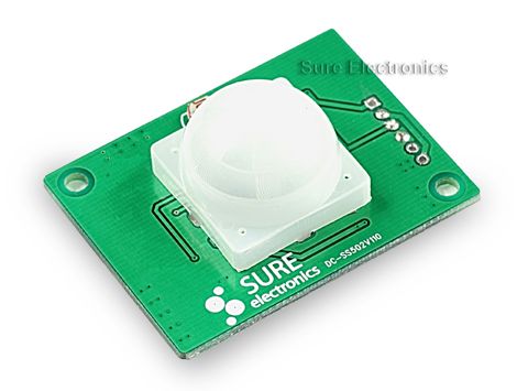

Sensor
PIR sensor I had use in this project

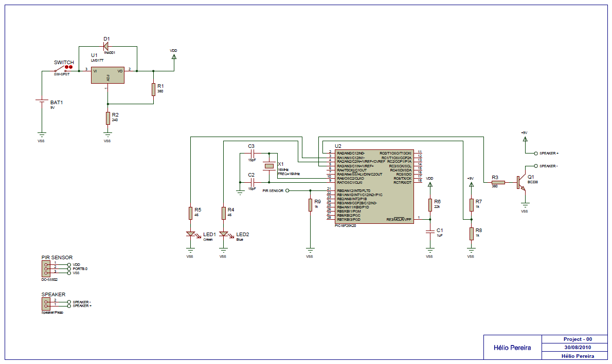

Schematic
Schematic
Power Supply
I use a 9V battery and it´s connect to a switch and as a voltage regulator I use an L317T and it will have an output of 3,3V to make that possible I use two resistors R1 and R2 to set the output, i use this equations to calculate R1 and I set R2 to 240 ohms:

POR (Power on reset)
I had to add a RC delay on VPP pin because when I switch on/off the circuit there was a voltage drop because the PIR Sensor and that would generate an unknown state when the MCU was restarted to solve that I add a RC delay, you can use this equations to calculate the delay

Speaker or Piezo
I use an 8 ohm speaker but you can use a piezo, i use a transistor BC338 (Q1) because the sound wasn´t too loud and should be able to ear that from a different division, with that transistor i get a HFE = 35. You can calculate ic with this equation.

PIR Sensor
This PIR Sensor works with only 3.3V like the MCU so it´s connect to the output of LM317T it can be connect to a voltage of 8V to 24V, because I use a 9V battery and if the battery gets lower than 8V the PIR sensor won’t work that is why I connect the output of LM317T. The Vout of the sensor it is connected to PORTB.0 and when it occurs a change it will cause an interrupt I use a pull down resistor to make sure the PORTB.0 it is in a low state. The sensor takes 10 to 12 seconds to cause another interrupt and the range is between 2m and 3m. There are the graphs of this sensor and the delays.

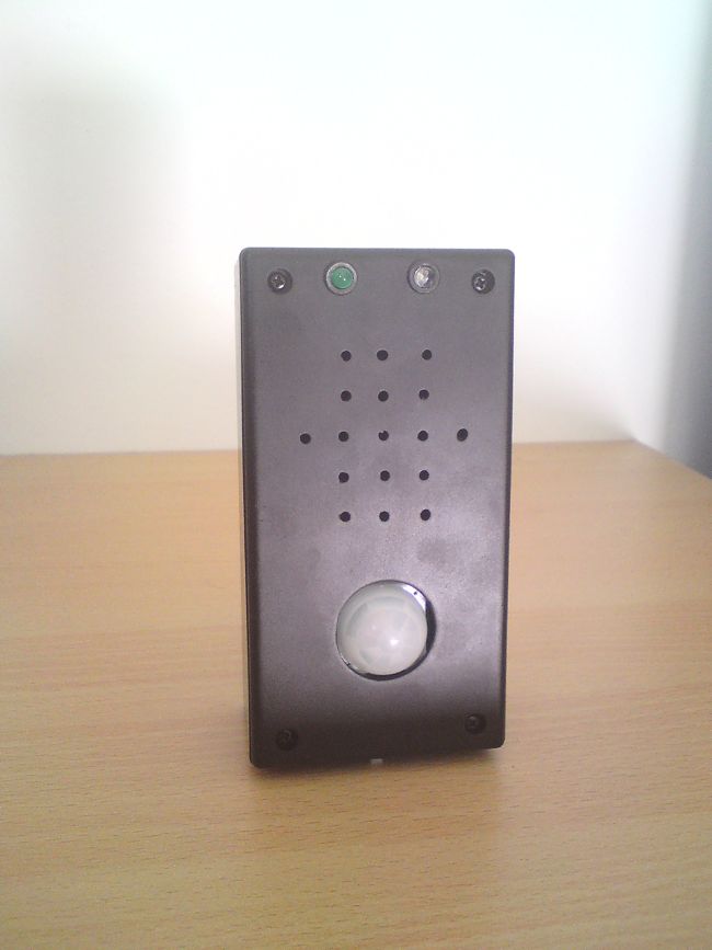

Algorithm
At startup both LEDs are on and then it will test the battery if is good Led1(Green) will switch on/off three times, if battery it is low Led2(Blue) will switch on/off three times, next it will put the Led1(Green) on, if PORTB.0 doesn´t change state the circuit will remain the same until a change happen and when a change happen it means the sensor detects some movement and a interrupt will occur and Led1 will be turn off and Led2 will be on and a sound will be generate during 5 seconds and then Led2 will switch off and return to the main routine.
