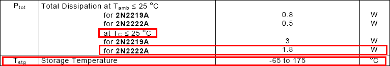

Guest Alun Posted April 3, 2005 Report Posted April 3, 2005 Connect 2 in parallel, and connect a 4.7ohm emitter resistor in series with each of them, and a heatsink would also be a good idea.The 2N2222A is also rated for 1.8W at <25OC Quote
audioguru Posted April 3, 2005 Report Posted April 3, 2005 Hi Alun,Philips and a few others rate it at 1/2W. They dont talk about using a heatsink on such a small transistor. I wonder if a heatsink could be soldered to their metal case, not the plastic one though, duh!That's a good idea to parallel them. Quote
Guest Alun Posted April 3, 2005 Report Posted April 3, 2005 Well here it says 1.8W for Tc of <25oC and 0.5W for Tamb <25oC so am I rightly assuming Tc means case temperature?I don't know about soldering to the case as it would exceed it's storage temperature. Quote
audioguru Posted April 3, 2005 Report Posted April 3, 2005 The project's author would expect you to fasten a refrigerator to it. ;DOtherwise operating it at 1.8W would exceed its storage and operating temps.A big high-velocity fan would do wonders for it! Quote

audioguru Posted April 5, 2005 Report Posted April 5, 2005 Hi Platonas,Q1 will dissipate about 750mW in this circuit. Little transistors like BSX20, 2N2222 and 2N3904 can't dissipate so much power without melting. Quote
