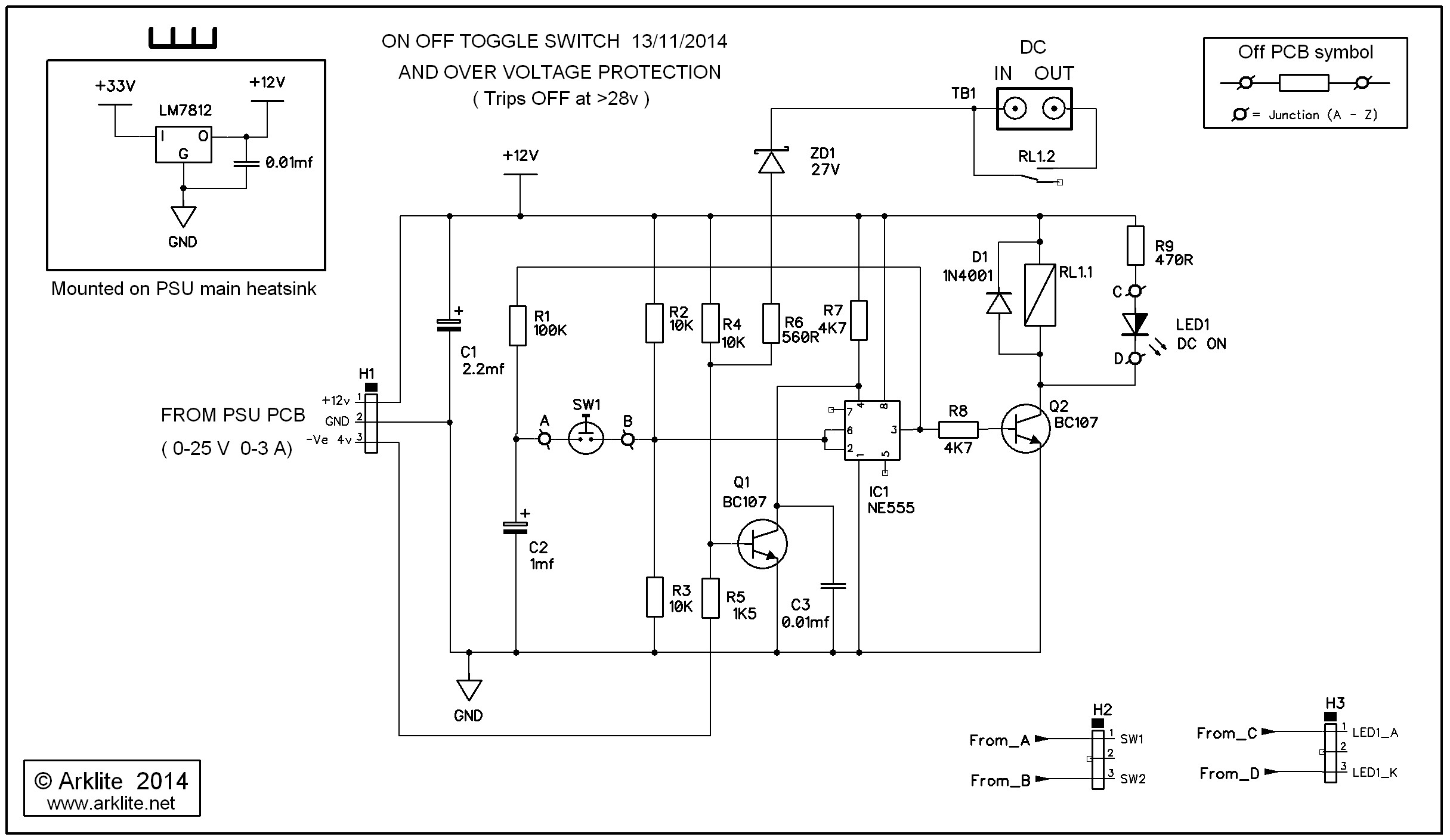

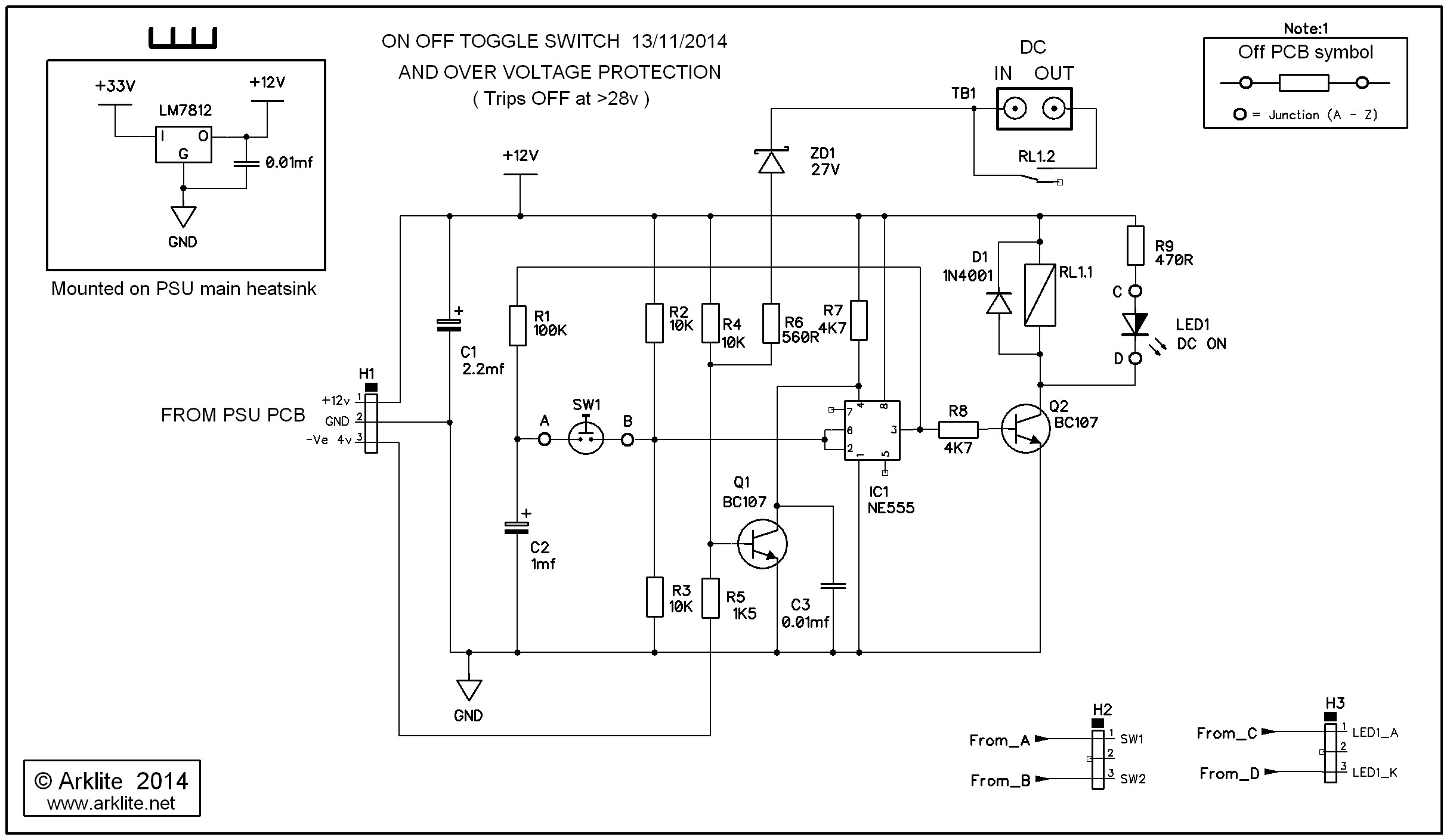

Guest elboa8 Posted November 13, 2014 Report Posted November 13, 2014 This is just an update on the “stand alone” switch for the PSU. It goes between the output of the PSU and the output terminals. I’ve tested it over a few days now and it’s performing well. I found with the addition of two components, a zener diode and resistor, the switch becomes an over voltage monitor. If the pass transistors fail (the most likely scenario) the output voltage rises to the “rail” value, in my case 33v. If this happens the 27v zener (ZD1) conducts and turns ON Q1 this resets the NE555 which turns OFF Q2 and the relay “drops out” A bonus is the switch is now inoperative, i.e. it will not turn ON the output again until the fault is rectified. The 12v is derived from a 12v regulator mounted on the PSU heat sink. The GND and the -4v are also from the PSU. The -4v comes from the junction (on the original circuit) of D6 anode,C3 –ve and R3 (220R) .To sum up…1) The output is OFF at mains switch ON.2) If the PSU is switched OFF by the mains the output voltage is turned OFF.3) If the “pass transistor(s)” fail the output is turned OFF and cannot be turned back ON.4) It is a “stand alone” circuit. i.e. it is an addition to the PSU not part of it. I’ve really put this together for my own use. Saying that, if anything is not clear, please let me know. Quote
Guest liquibyte Posted November 13, 2014 Report Posted November 13, 2014 That's really clever and some good work. I think red baron should add this to his and try again with the battery charging to see how well it holds up. Quote

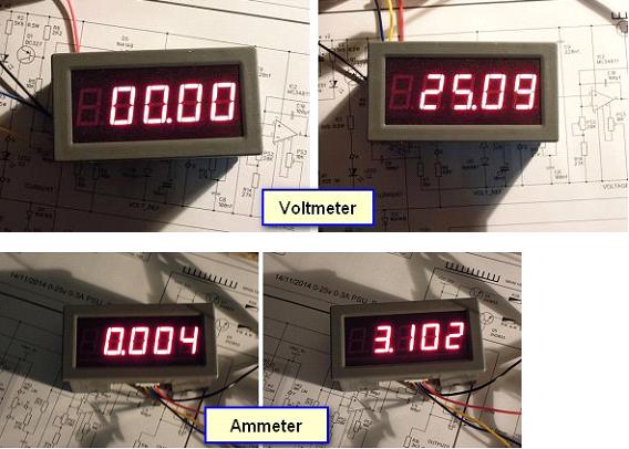

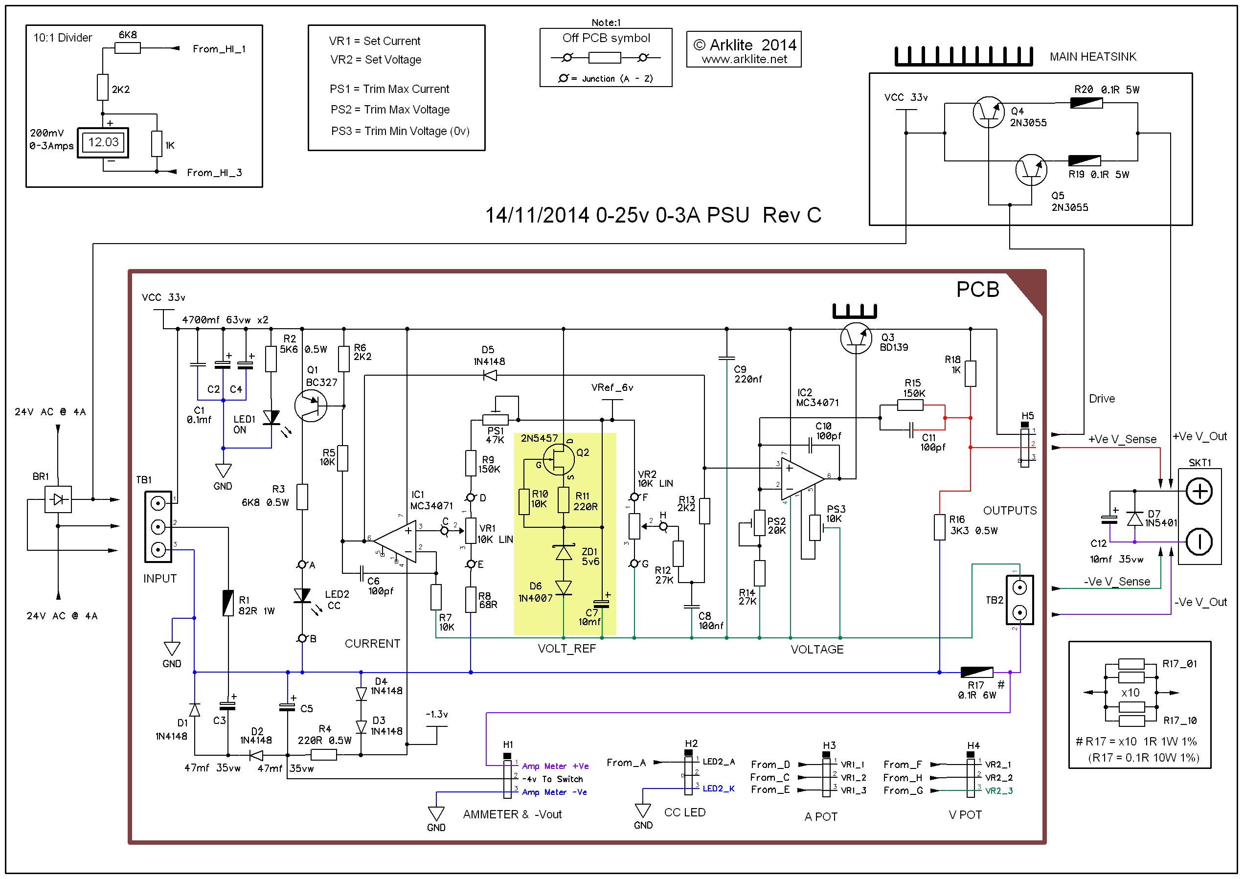

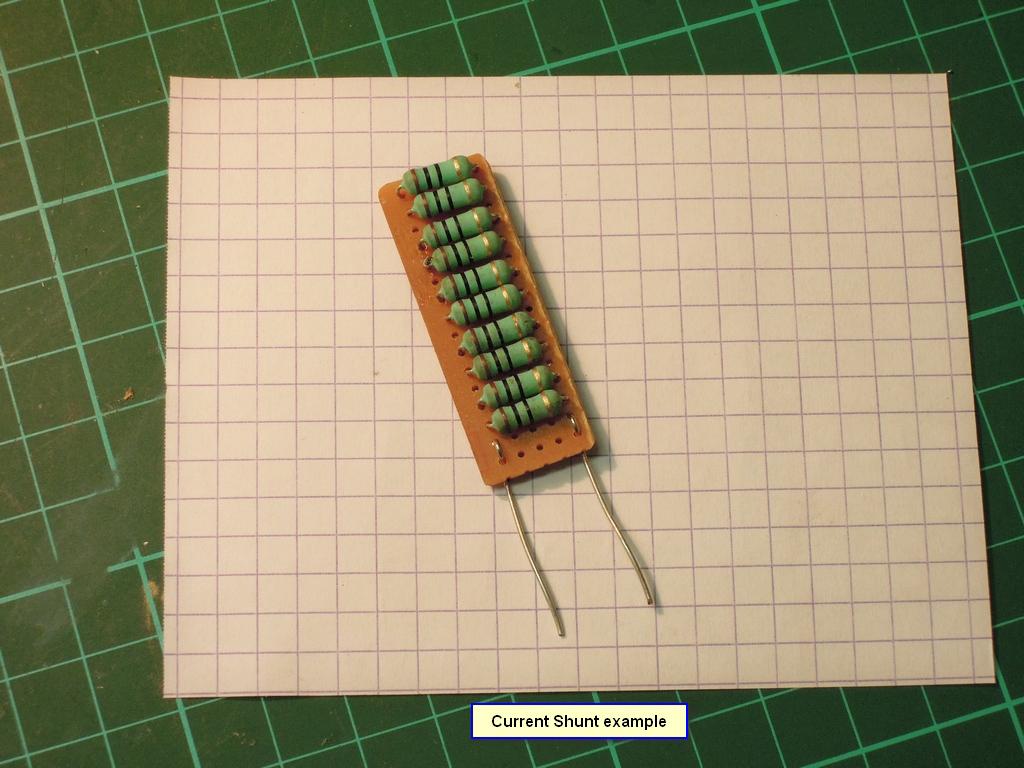

Guest elboa8 Posted November 17, 2014 Report Posted November 17, 2014 PSUOK, I’m happy with the PSU performance now, and I’m ready to put it into a case.Again this is my take on a popular project. I’ll try to outline some changes I’ve made, and why.First a few general specs:1: 0 – 25 V 0.04 – 3 A. (10 mV and 1 mA meter resolution).2: Regulation @ 3 A <0.01%.3: Stability @ 1 A after 1 hr <0.01%.4: Ripple @ 3 A < 100 mV.5: Push ON /OFF toggle switch that defaults to OFF, with over volts cut-off.References are from the original circuit.The voltage and current range were dictated by the transformer I had (24 V @ 6 A ). This gives a NO LOAD voltage of 33 V. Adding the -1.3 V to this gives a voltage range of 34.3 V. As the IC’s are rated at 44 V I could dispense with the zener diode D13.Reading through the various posts it’s apparent that a lot of problems are caused by trying to use a transformer with different specifications! Unless you are prepared and able to make circuit changes, stick as close as possible to the original specified transformer.The heart of a good PSU is the voltage reference performance. After doing a number of tests of voltage and temperature stability on the original, built around D8 and U1, I changed it to a constant current FET circuit. The component count is slightly less and the performance is better. As the reference is 6 V not 11 V the gain of the OP Amp U2 was increased from 3 to 4 (approx).I changed the current sense resistor from 0.47 R to 0.1 R @ 1%. The gain of U3 was also increased to account for this. I made the resistor from 10 x 1 R 0.6 W 1% in parallel. This gives a 0.1 R 6 W 1% resistor. The advantages of this is reduced voltage drop and reduced heat dissipation. (0.1R @ 3A = 300 mV - 900 mW, 0.47R @ 3A = 1.41 V – 4.23 W ). It also neatly drops 100 mV per 1 Amp of current. i.e. 300 mV at the 3 A max. As I used a 4 ½ digit 200 mV LED display (19999 max) I put a 10:1 3 resistor divider on the input of the meter and set the decimal point to 19.999 this gives a me a 1 mA to 3 A reading with a meter resolution of 1 mA ( 0.001 - 3.000 A ). I’m not pretending the precision is as good as the resolution, but it’s within a few mV. To further improve performance I separated the sense outputs and joined them directly to the output terminals, I could have brought them out to the front panel but it meets my requirements as it stands. I also used a 4 ½ digit 200 V LED display (19999 max) for the voltage display. This time the decimal point is placed at 199.99 giving a meter reading of 10 mV to 25 V with a meter resolution of 10 mV. (00.01 – 25.00 V ). As I wanted a push ON/OFF DC switch, I made a “stand alone” toggle circuit. (See previous post for details). This is not directly incorporated into the PSU and can be omitted. Some DC switch should be fitted however and turned ON after the AC power up and OFF before the AC power down. This is important as there are some voltage spike issues! The toggle switch defaults to OFF and incorporates an over voltage (pass transistor fail) shutdown function. I will post some pictures of the built PSU when it’s finished. (I’m still waiting for the push switch with built in LED).I’ve inc. a few pictures including the final circuits. Again this is my own take on the “old” design. Why I made the changes may be of interest to someone. Quote
deepak.roy.alchemist Posted November 21, 2014 Author Report Posted November 21, 2014 hello Arklite! your on off switch is excellent! i have a 0-350volt 0-0.25A dc variable power supply and i want to use this circuit there as a load switch with a soft touch. but the problem is that i am getting no such relays which can switch 350volts dc. plz help. Quote
Guest elboa8 Posted November 22, 2014 Report Posted November 22, 2014 Hi. I got the relay from Ebay (were else), but my requirements were more modest. anything over 3A and 50V. Anyway try searching there. If you just want to use the switch as a simple ON/OFF switch, you must remove ZD1,R6,R4,R5 and Q1. It will not work otherwise. Note also the driver transistor, the BC107 has a MAX rating of 100mA! Regards Quote

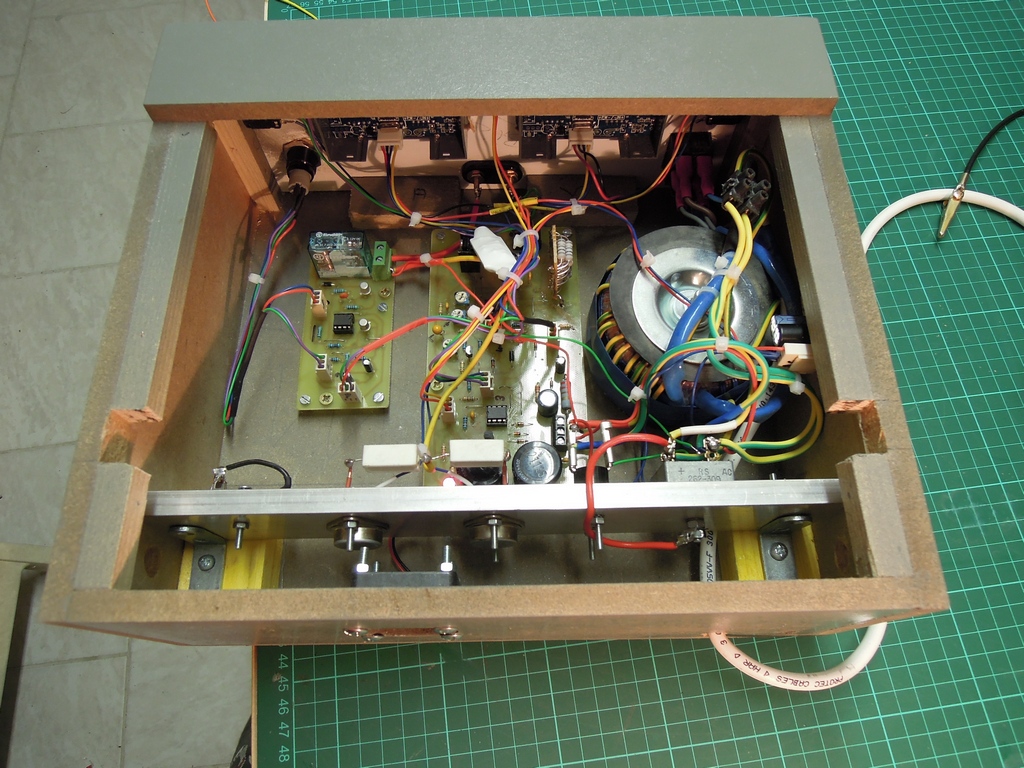

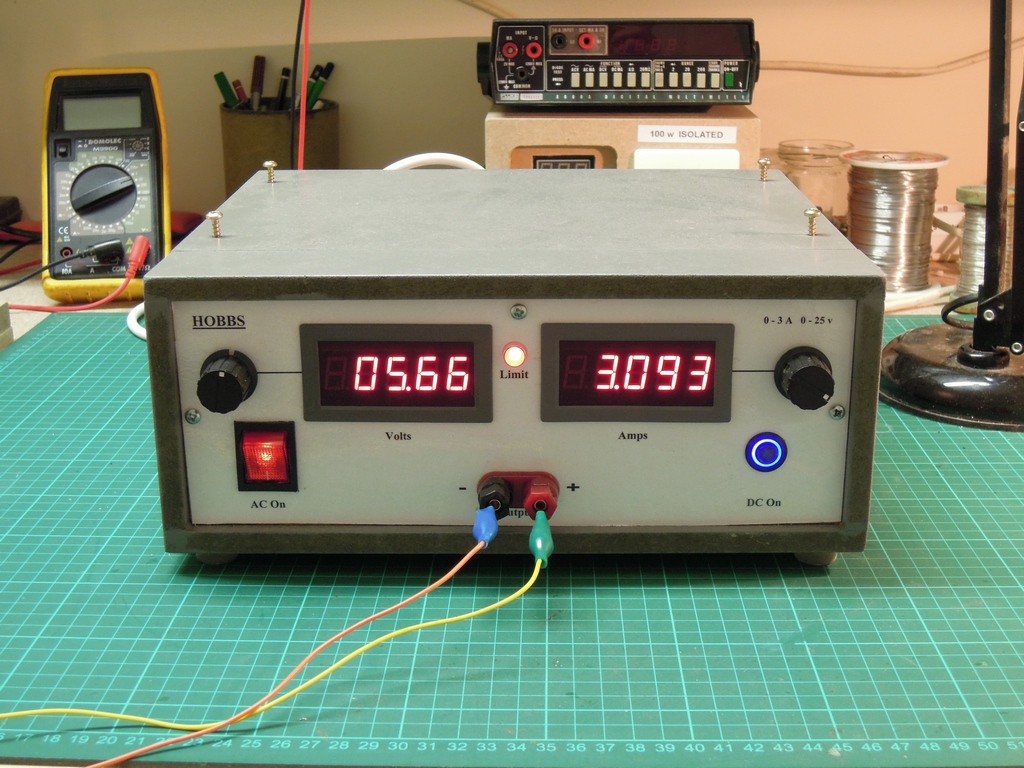

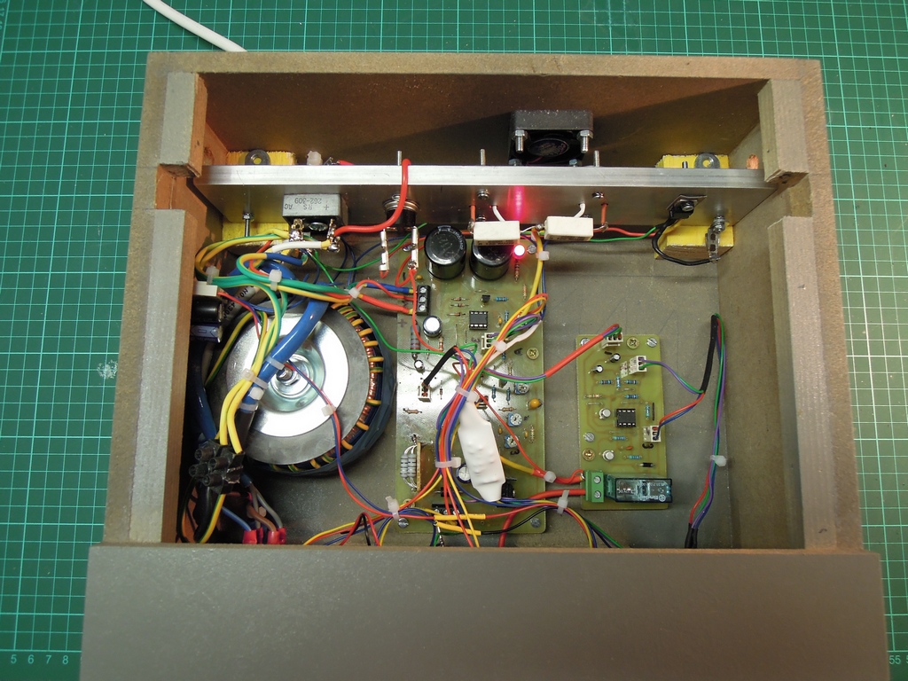

Guest elboa8 Posted November 23, 2014 Report Posted November 23, 2014 Hi I thought I might as well finish off with a block diagram of the PSU project. As always there is more to it than the main PCB!Also some pictures of working PSU. Quote
Guest zbb Posted November 26, 2014 Report Posted November 26, 2014 I thought I would outline the voltage spike problems with the PSU...........I spent a good while on this problem but as the supply spikes at switch on as well, and the PSU works very well in all other areas, I’m going to leave it, as is (no switch off clamp transistor) and look at a separate on off switch, perhaps using a FET. More later.A solution that works guaranteed is reasonably simple: put a single throw switch between the point R8/R9/C4 and the ground tab of the voltage pot. Use this switch to easily switch the output on and off without switching the whole supply on or off. Make it a habit to have this switch in the output-off-position, switch closed, before you switch the supply on or off. If you are adverse to having a second switch:Did you try putting a capacitor parallel to R13? As the lower base resistor is very small, it should be a bigger one; a wild gues would be an elco of at least 47-100microFarad. That capacitor is charged by the rise of the positive supply rail and discharges over R14. If the capacitor is large enough to delay 1/50th of a second to hold Q1 open, the negative supply is about where it should be. In order to use much higher resistance values and have longer delays with a smaller capacitor, try replacing Q1 by a MOSfet. Quote
Guest zbb Posted November 26, 2014 Report Posted November 26, 2014 I have to add a comment to the above: If at switch-on there is a delay because of the capacitor discharging from the full positive tension, say 36V, to less then Vbe, there will also be a very much smaller delay at switching off, the voltage rising from -1.3V to +Vbe. The latter delay is an order of magnitude smaller than the former, but still it means that the value of capacitor can not be made unlimitedly big. Quote
Guest elboa8 Posted November 27, 2014 Report Posted November 27, 2014 Hi I think that at some point you have to stop and say I'm happy with this as it is. Look at the 100's of threads on this project.With all respect to the original design a lot of the problems is the use of a _ve supply on the current control IC. As it stands switching OFF by the DC switch before switching OFF my the AC switch does not of course give a spike. Also setting the voltage level only slightly above the current set value minimizes the spike. I did spent quite a bit of time playing around with cap values (not simulation) on a breadboard before building the supply. I guess at the end of the day this is a hobby. The reality is you could buy a better spec PSU from Ebay! But were is the fun in that. Also at the moment there are several different topics all on the same supply. It certainly got people interested. For me I think it's time to move onto something else. Regards Quote

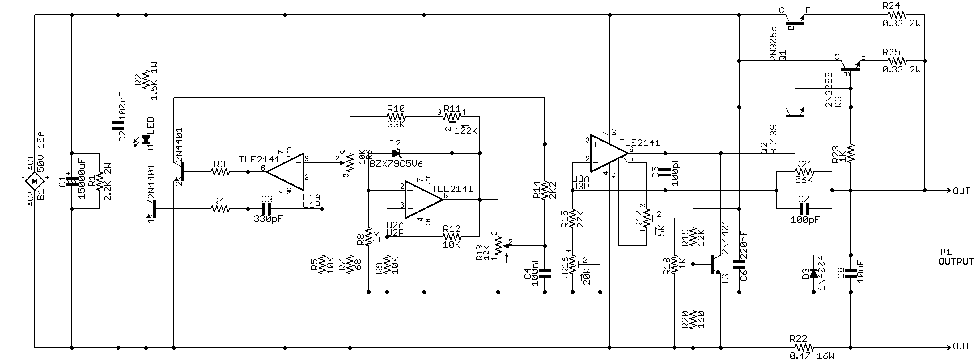

burrap Posted August 31, 2017 Report Posted August 31, 2017 On 2014-11-06 at 2:55 AM, Guest liquibyte said: Wouldn't elimination of the negative rail mean that we could get rid of the 10V zener as well? Something like this? I tried simulating this. Works beautifully. I think I had to switch the inputs U1 though. I have the simulation at work. But in this design, Q1 is pointless though. So I will either remove it or modify the negative supply to work with Q1 only. I think I'll go with the latter. Don't need a good neg supply since it's only purpose is to die at shutoff :-) I love getting rid of the neg supply in current limiting mode though. Otherwise I would feel the need to improve it. I will also move most ground connections to go after the current sense resistor. As it is now the 6mA going from the reference zener to ground (and also other small currents) goes through the current sense resistor which I don't like. Thanks for the idea! :-) On 2014-11-05 at 3:56 PM, audioguru said: When the load current is higher than the current regulator setting and the voltage is set high, the "on" voltage spike is caused by the time it takes for the negative supply to reach a low enough voltage (-1V?) for the current regulating opamp to pull down the voltage feeding the voltage output amplifier. Here is my proposed fix: Do you still have this pic audioguru? I'd love to see it and the link doesn't work for me. Quote
audioguru Posted September 1, 2017 Report Posted September 1, 2017 (edited) I cannot remember my fix for the "on" voltage spike. If you remove the negative supply then you will not be able to limit shorted output current less than about 0.43A since the transistor that replaces the diode cannot go lower than its max saturated output of about 0.2V. 0.2V/0.47 ohms= 0.43A. Edited September 1, 2017 by audioguru Quote
burrap Posted September 1, 2017 Report Posted September 1, 2017 Oh. Ok. I thought your fix was for the peak that occurs when you are in current limit mode and turn the supply off (since the current limit function collapses faster than the output is pulled down. Then it's ok. Turn on transients shouldn't be as tricky. 0.2 volt on the base of a 2n4401 shouldn't open it, so it should be ok. Quote
