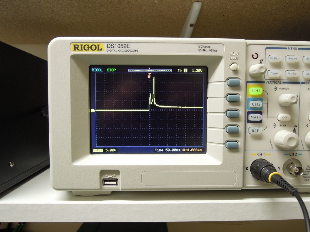

Guest elboa8 Report post Posted November 5, 2014 Hi, Yes, adding the “shut off” transistor helps, but it’s not the full answer. The collapse of the -1.3v rail is causing the problem and at the same time is trying to clamp the output via the “shut off” transistor.! Looking at the switch ON spike, I used the following test set up. I connected a 12v 500mA bulb to the supply. I set the voltage to maximum and the current limit to 50mA. At turn on you get a huge (repeatable) spike. (See att. Jpg) , before the current limit “kicks in”. Quote Share this post Link to post Share on other sites

audioguru 34 Report post Posted November 5, 2014 When the load current is higher than the current regulator setting and the voltage is set high, the "on" voltage spike is caused by the time it takes for the negative supply to reach a low enough voltage (-1V?) for the current regulating opamp to pull down the voltage feeding the voltage output amplifier.Here is my proposed fix: Quote Share this post Link to post Share on other sites

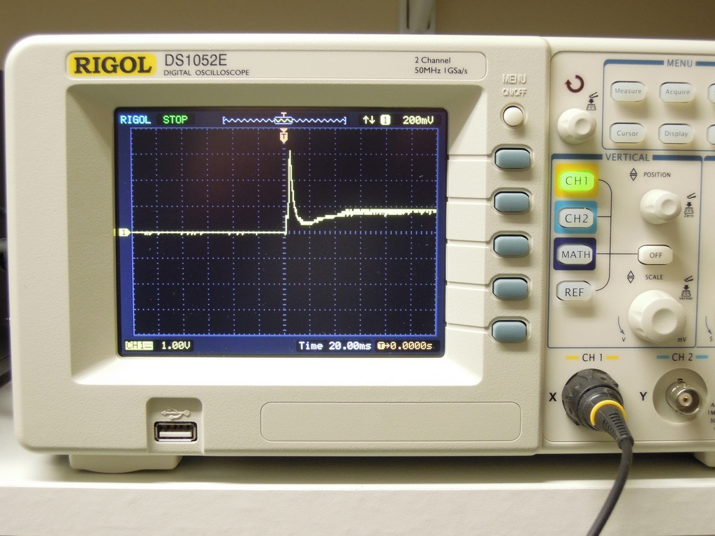

Guest elboa8 Report post Posted November 6, 2014 Hi. Out of interest I set up the same test as before. Max voltage low current set into a bulb. Only this time I supplied the -1.3v via a permanent external source. Remember I’m not using a “clamp” transistor. The switch off and switch on were reduced but NOT eliminated. So it would appear reworking the –ve supply will help, but will not solve the problem completely! I’m going to stick with my original thoughts, the supply as it stands works well (except for the spikes). So I’m working on a separate DC toggle switch. I’ve attached, my final circuit, the switch on spike with permanent –ve 1.3 and my prototype toggle switch with fast close down. Quote Share this post Link to post Share on other sites

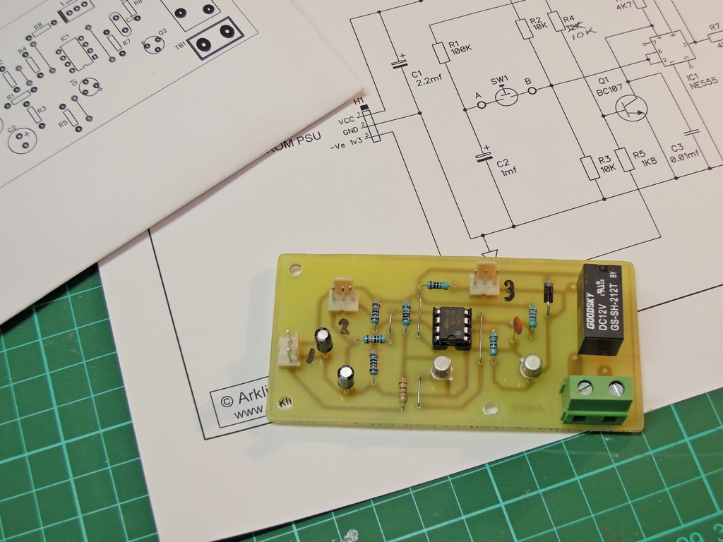

Guest elboa8 Report post Posted November 6, 2014 Quick update on the toggle switch. After a couple of tweeks it's working fine. It defaults to OFF at startup. No spike! And it closes down fast at switch off. I'll play around a bit more and get some scope waveforms. Quote Share this post Link to post Share on other sites

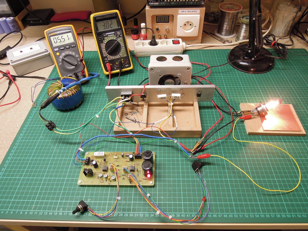

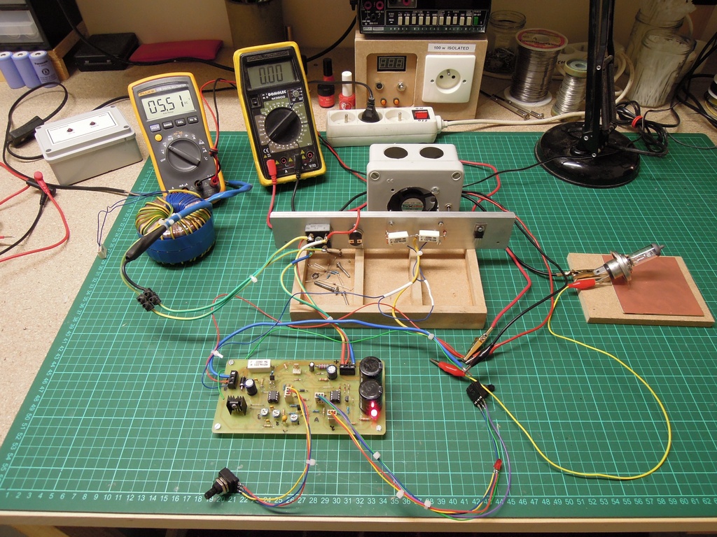

Guest elboa8 Report post Posted November 7, 2014 Leaving aside the problems for a minute I’m very happy with the overall performance of the PSU. The two pictures show the supply with a 3A load, voltage at 5.51v and with no load the voltage is still showing 5.51v.The two pass transistors are dissipating approximately 60W. Yes, you need a big heat sink and fan. I obtained these regulation figures by returning the voltage control IC 0v rail to the “other side” ( –Ve sense ) of the current sense resistor.Footnote: The temp. stabilizes at about 53 c. Quote Share this post Link to post Share on other sites

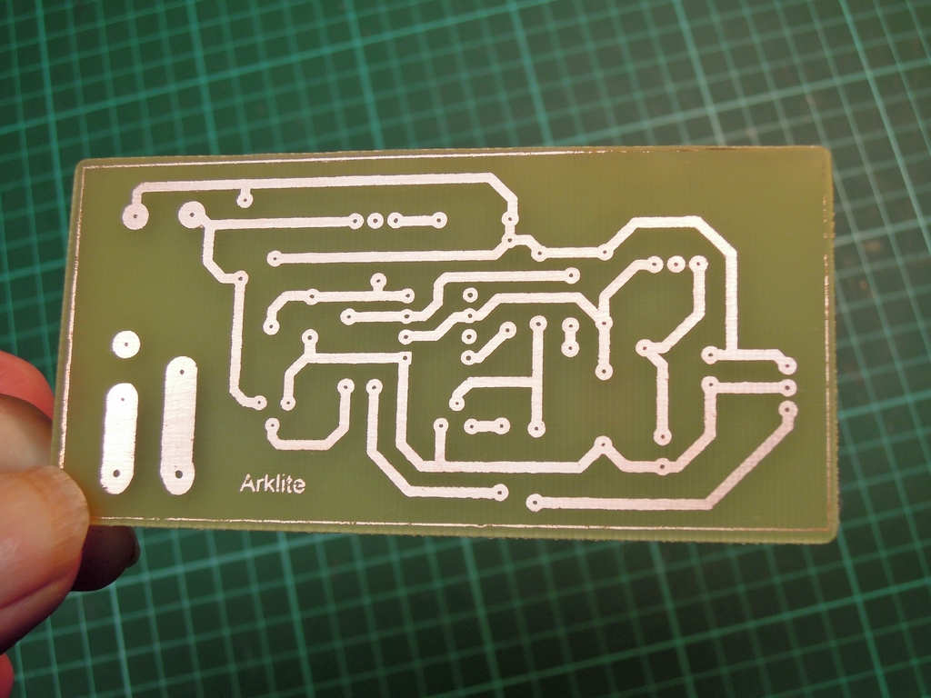

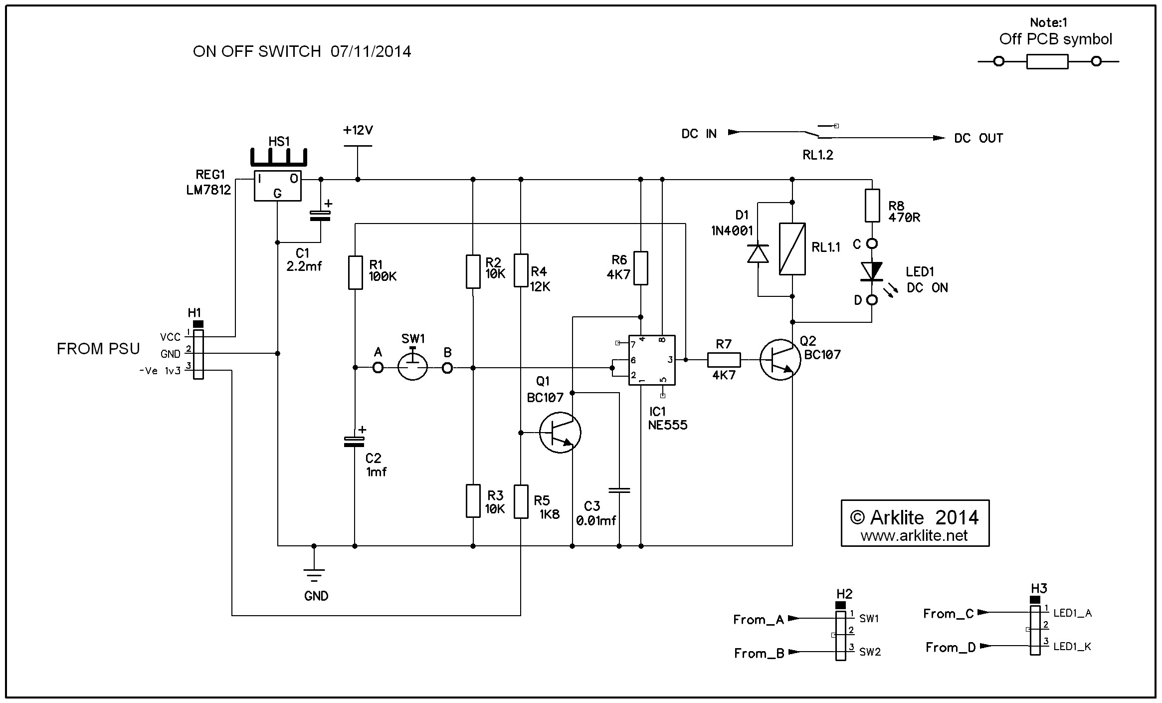

Guest elboa8 Report post Posted November 9, 2014 I went ahead and made a PCB (Diptrace) for the toggle switch. It all works fine. After some more tests I'll buy, or make a case for it. I found some nice 5 digit LED displays on eBay (where else) for the finished PSU. Quote Share this post Link to post Share on other sites

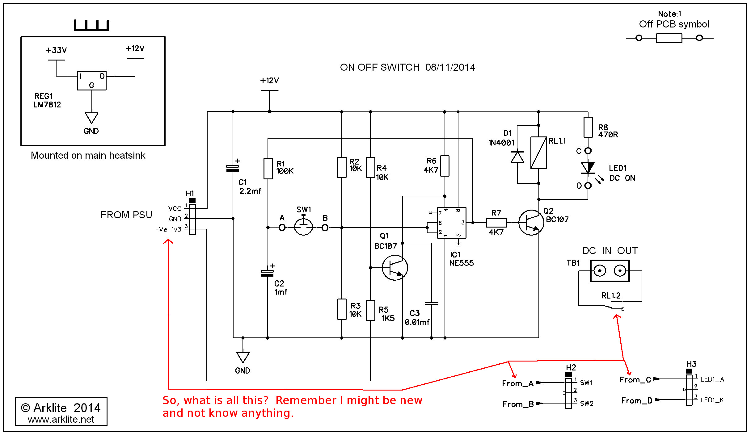

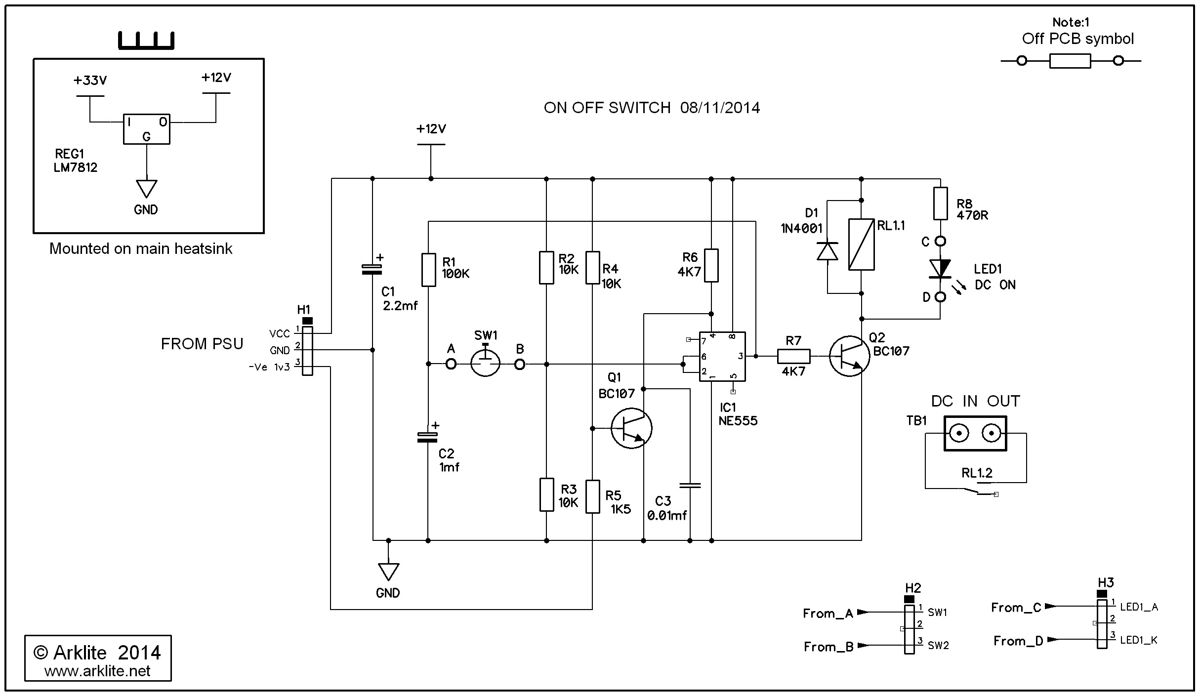

Guest liquibyte Report post Posted November 9, 2014 Breaking a simple schematic apart into subsections makes it confusing and hard to follow and is basically unnecessary. For one thing, what is A, B, C, and D? Where in the grand scheme of things are you inserting this into the PS circuit? Quote Share this post Link to post Share on other sites
Guest elboa8 Report post Posted November 9, 2014 I did not break it apart into sub sections! The switch is a separate entity from the main PSU. It's what I am doing for myself.I am sharing for anyone who may get something from it. Quote Share this post Link to post Share on other sites

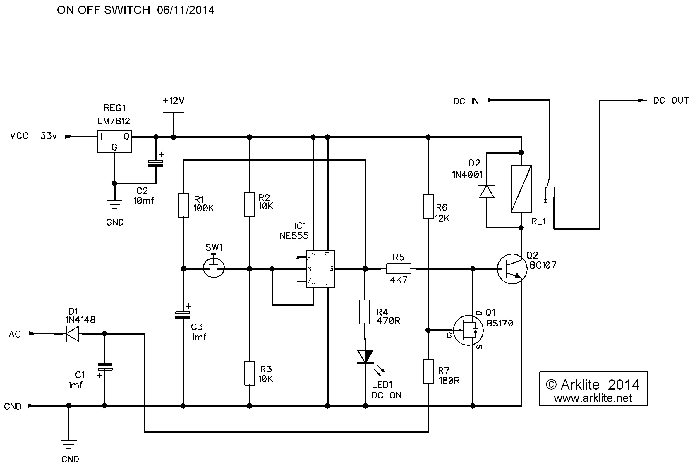

Guest liquibyte Report post Posted November 9, 2014 Yeah, but I believe switch in and of itself may be a misnomer. This is a soft-start circuit using a 555 timer am I correct? There's a reason that I try and keep all my nets connected is that it's less confusing for a newbie. Now say that someone that knows very little about electronics comes along and successfully builds the power supply but wants to integrate your circuit into it to fix the startup transient issue. Does your schematic explain to them in any meaningful way on how to integrate this into their build? I'm not criticizing the circuit by the way, I have a version of this sitting on a breadboard right now that I put together for the same reasons you did before you posted this, so I understand the impetus behind it. Quote Share this post Link to post Share on other sites
Guest elboa8 Report post Posted November 10, 2014 That's fine. I just feel if you had expressed your concerns and explained how this forum works it would have been more helpful. I thought I was sharing some thoughts ideas with Redwire et al. Do I post things like the switch for example, on a new thread? Quote Share this post Link to post Share on other sites
Guest Jaxelo Report post Posted November 10, 2014 I think what he wanted was a circuit with that switch being a part of the PS, which I want to see also - I'm new and can't really see where that fits in.. Quote Share this post Link to post Share on other sites

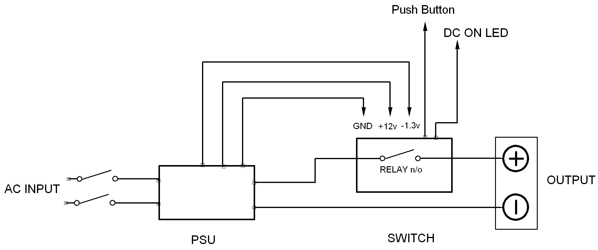

Guest elboa8 Report post Posted November 10, 2014 Hi I've attached a very rough block diagram which may help. The three feeds come from the PSU. GND, -1.3v and +12v. The +12v is from a 12v regulator mounted on the PSU heat sink. When you switch ON the PSU at the mains the "switch" is always OFF. You press the push button to toggle the output ON and OFF. If you switch the PSU OFF by the mains the relay on the "switch" disconnects the output very quickly. I really was doing this for my own use. So sorry for lack of information. Quote Share this post Link to post Share on other sites
