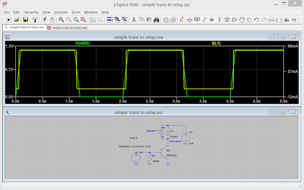

HarryA Posted September 12, 2019 Report Posted September 12, 2019 Lets see if this is readable. Using a 2n2222 - about 10 cents apiece. Current from the source is 40ma with a base resistor of 1000 or 10k. In the view the yellow trace is the current through the relay; scale on the right . Green is the voltage at the base; scale on the left. I have no idea what the inductance would be so I set it at 0.001 henry. Quote
audioguru Posted September 12, 2019 Report Posted September 12, 2019 Your simulation is cheating because it uses a very high base voltage that has almost unlimited current and no voltage drop. Quote

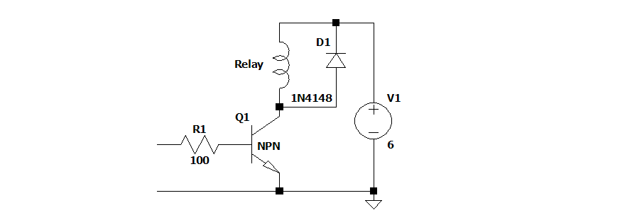

MAJ Posted September 12, 2019 Author Report Posted September 12, 2019 Hello everyone, I got a suggested simple NPN circuit that worked fine with the 1.2V trigger signal. Here it is Thanks everyone. Quote
