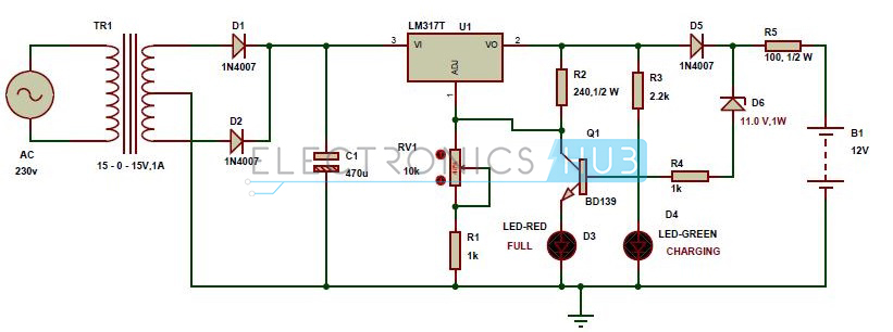

I have a 12v 3amp transformer. I want to make a chsrger for my 12v 9ah lead acid battery. Pls give a simplest circuit. Also with charge indicator.

Dave, I like the circuit but why isn't D6 connected directly to the battery? Am I missing something?

How does 3AC (RMS) convert to 2ADC?

Just use the transformer, 4 diodes and a resistor.
The 3A transformer is 2A DC
I'm referring to the statement in bold. If a transformer has 3A rating it's specifying 3A RMS output not input. How does 3A RMS output translate to 2A DC?

Imagine you have a 10V RMS AC 100VA transformer. We will assume nice sine waves and that the current drawn is 10A RMS.
We know that RMS measurements create an equivalency in the ability to heat something, and thus they allow us to measure power.
If we assume that current and voltage are exactly in sync, we can deliver 100W of energy. If voltage and current are 90 degrees out of phase, the load is still 100VA, but the power is zero watts. We will initially assume everything is nicely in phase and track where that 100W is spent.
Lets assume we have a perfect bridge rectifier and a perfect capacitor, and a perfect linear regulator.
The capacitors charge up to the peak voltage of 14.14V. Then the regulator reduces the voltage to 10VDC which is passed to a load.
Let's assume the load draws 7.07A.
What is the total power being delivered by the transformer? Well it is equivalent to the voltage on the caps multiplied by the current through the load. 14.14 x 7.07 = 99.97W. And remember that the peak power our transformer can supply is 100W.
In this case 71W goes to the load and 29W is dissipated by the regulator.
Assuming a linear regulator, no matter what the voltage output, the output current should not exceed 0.707 times the rated transformer current.
It's also interesting to note that the actual current drawn from the transformer may peak at 30 or 40 A as ALL the power is delivered in short high current pulses at the peak of each half cycle. The larger the filter capacitors, the shorter duration and higher current these peaks are.
Different transformer, rectifier, and filtering topologies have different multipliers, but bridge rectification and capacitive filtering is so common that the figures get etched into your mind. (a different set would be etched into your mind if you were supplying HV using a vacuum tube double diode, a centre tapped transformer, a small capacitor, and the field coil of your loudspeaker as an inductor).

The 3A transformer is 2A DC.
It's not the fault of the transformer.
It's just that can only take 2 amps from the output of a bridge circuit that has a filter capacitor because the output voltage will be 40% higher than the voltage-rating of the transformer.
This means we will be getting about 18v from a 12v transformer. We are happy with the voltage increase of 40% but we must take 30% less current so that the multiplication of the two values remains the same.

We are happy with the voltage increase of 40% but we must take 40% less current so that the multiplication of the two values remains the same.
40% higher, therefore 30% lower. It's multiplication and division, not addition and subtraction.

Steve I get that but this statement says nothing about filter caps, voltage regulators or anything else. 3A RMS is equivalent to 3A DC.

Yes, it requires filter caps for this statement to hold true.
Its the filling up of the bits between the half waves which causes the issue.

That makes a hell of a lot more sense. The way Colin wrote that is misleading,.. to say the least. That said a filter cap is a superfluous component for a basic lead acid battery charger that Colin's describing. On that note I wouldn't use a resistor as he described either. An incandescent lamp is a better choice. It also seconds as a charging indicator. ;)

I prefer some form of current limited voltage source. Sure, an incandescent bulb is a great current limiter, but without some form of voltage limit, it is very easy to overcharge lead acid batteries. For flooded cells this can actually be useful, but not for gel cells.
