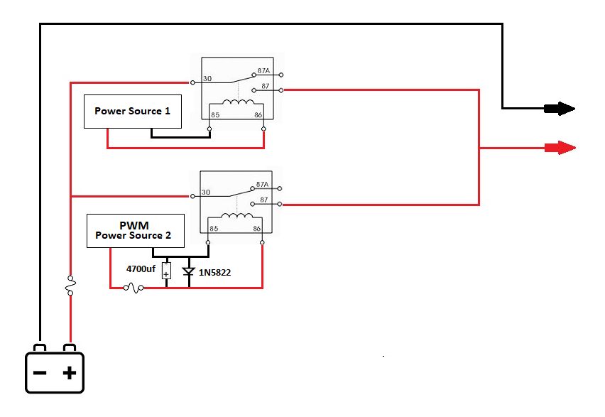

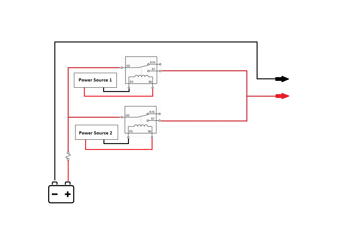

I've got the following relay design where I've got two relays sharing the same common directly from +12v of a car battery. The relay coil is powered by two different circuits. In most cases only Power Source 1 or Power Source 2 will be on. However, there will be occasions where power source 2 may be on for about a minuate max when power source 1 is also on. Questsion is, will that be ok? I can't see why not because technically if both are on at the same time, then all that's happening is the same +12v power is getting merged. As a precaution I could put a diode but i'm thinking is it necessary?
Any advice will be appreciated.

I see no problem. Should work just fine. No diode is needed. What did you use to draw the schematic?

Perfectly o.k.

What about adding a signal diode and a 4700uF capacitor in line across the PWM positive and negative terminals as pictured below?
Or are there any types of relays that can handle PWM? So that I can possibly just put a different relay for the second relay? i read something about solid state relays.
Also, this PWM circuit is never on for more than a maximum of 1 to 2mins

You're dealing with a few different issues here:
  1. The pwm source may not be designed to handle inductive loads (such as the relay). The diode is a good start but may not be sufficient.
  2. The pwm source is definitely not designed to drive a huge capacitive load.
  3. Smoothing out the pwm will make moot the whole point of using pwm in the first place.

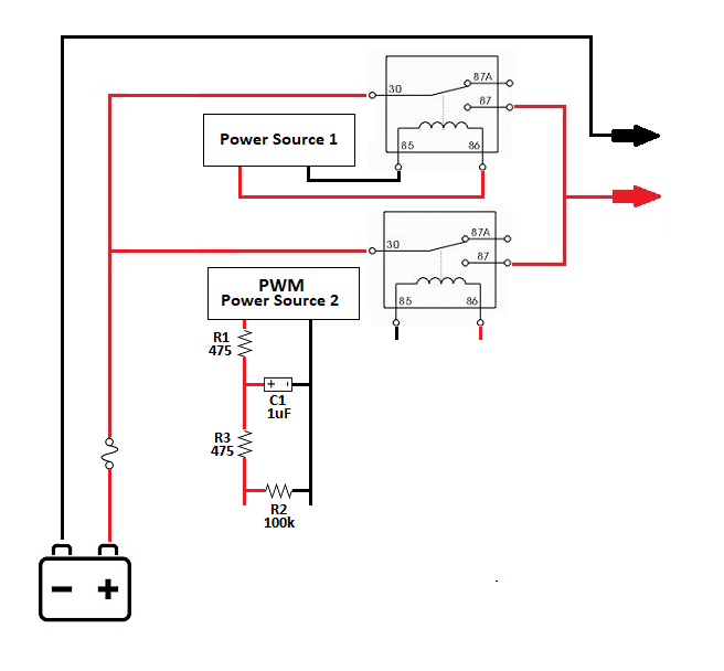

You need to decouple the pwm from the relay, for example like this:
R1, C1 will smooth out the pwm.
R3 will limit the base curent into Q1.
R2 will discharge C1 in case pwm id off, thus turning Q1 securely off.
D1 protects Q1 from teh flyback voltage when current through L1 is interrupted.

Thank you @Harald Kapp I've tried to visually understand it by putting your decoupling example into my diagram below. But i'm little lost at the transistor part. I believe a transistor has 3 pins, which pins will connect where and how does it connect to the relay?
Also, is R1 and R3 a 475ohm resistor? and R2 is a 100k ohm resistor? any particular type?
Thank you
It is all shown in my diagram, post #11.
The relay pins 85 and 86 are where L1 is in my schematic (lacking a relay symbol)..
Yes, they are.
No, Use e.g. 1/4 W types.
Note that the 2N2222 is good for max. 800 mA. Your relay coil must operate on less current, otherwise the transistor will blow.

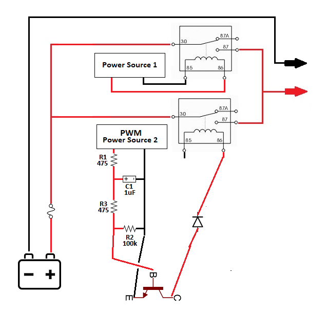

Still a little confused after looking at your diagram with the final connections to the relay. Is it something like my diagram below? i think something is wrong :eek:
You think right:
  • the diode has to be parallel to the relay coil
  • the other end of the relay coil needs to go to the positive supply of the pwm source

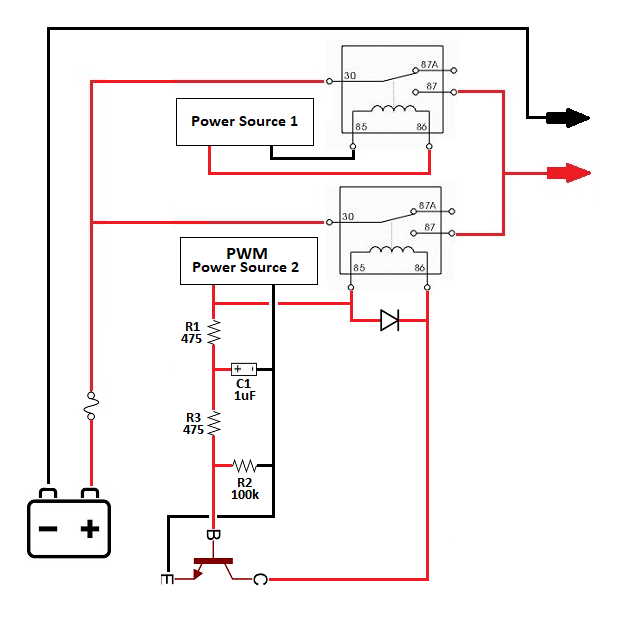

I've tried again below, but i still think something wrong :eek: the relay coil seems like it has two positive connections on the 85 and 86 o_O

No. The connection from pin 85 of the relay to the pwm output negates the meaning of the whole rest of the circuit. You need to connect pion 85 to the positive supply of the pwm source.
