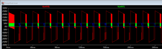

so it appears as whats know as noise is happening any idea how to reduce it

is this looking correct to you?
No. That 'noise' shouldn't be there, and certainly not at only node N008. Nodes N007 and N008 (i.e. the two half-bridge outputs) should have near-identical waveforms. Double-check all connections/values.
how do I change the rate that thee simulation runs?
You can't, unless you change the IR2110 model. I note that the pinout and symbol of yours are quite different from those of the model I use, so I can't easily use your .asc file.

running one more time to check that I told you right, can I have the model you use please may remake again
also the ringing is on both not just blue its directly underneath the blue

Here are my model files (zipped .sub and .asy). The IR2110 model is one I created years ago because the 'official' one ran incredibly s-l-o-w-l-y, or not at all.
I don't have the IRF640 model, so I used a similar one from the standard LTS library.
Here's a simplified version of your sim using my model.

so this looks good I think red is 230v ac and green and blue are the signals from the H-bridge.

actually I think it may be wrong have a look and see what you think
If you'd used the Label net tool you (and others) would know for sure!
There is spurious oscillation showing. Probably due to some inductive effect feeding back to the gate drive.
enough dead time?
I would think so. In post #114 you are looking at the rise and fall ramps of the P1 and P2 pulses, which are specified as 1us. If you were using an MCU to provide those pulses they would likely be much briefer.

so still can't find the label option but the red = pulse1 blue = anti-phase pulse2 green equals higher voltage side of the transformer (output)
why is there ringing on the green?
