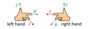

for example if you put a magnet in a copper tube without it moving the copper would heat up I got to be strait on this one I think that you are wrong! also if you're not moving the magnet in comparison to the coils the you can alter the magneting field by use of electromagnets so what I'm saying is it's the CHANGE in magnetic flux in the field that induces currents and eddies currents which are still just currents, no moving magnetic field, no current of any sort! what it boils down to is the very simple and basic right hand rule, which I think you have clearly over-looked Mr Delta Prime, the force of moving an inductor through the magnetic field creates currents! or moving the magnet past an inductor induces current flow! It's about CHANGE in position with respect to the magnetic source and the inductor in use!!

If you draw current from your coil, that will produce a changing magnetic flux through the coil. Since the penny would experience that flux change there would be eddy currents in it (albeit perhaps not significant in the grand scheme of things).

anyway you are plain wrong to induce a current you need to either create a moving magnetic field by electromagnet or move a permanent magnt in relation the coil either way for a current to form you need moving magnetic flux field, otherwise you could draw a current off of the magnet in situ next to a coil this does not happen and if you don't have anything constructive to say do say anything at all!

same with a transformer you have to put an alternating current to change the flux with a frequency you don't listen yourself. you think you know it all!

I think it does. If the coin is between the magnet and the coil surely it will experience the vector sum of the coil-generated field and the magnet's field? That sum is changing because the coil-generated field is changing. The change in the sum won't be much though, if the magnet's field is a lot stronger than the coil's field. Also, the coil's field presumably extends into the magnet, rather than stopping abruptly at the magnet face, so would affect the magnet's net internal field slightly.
It's also possible by varying the strength of the magnetic field with no movement involved.

but this still implies that you need a moving magnetic field to induce the current make the current
and I would do this by electromagnetism, varying a current through a coil
did you read my post about the magnets themselves
in any case the magnet its self is made of ferromagnetic material by nature of how magnets are made, so then you should say that there are eddies present in the magnets when they are generating power
would this be correct thinking?? I think the eddies must be present in both the coin and the magnets if the field of the coils affects the coin it must affect the magnets too?
