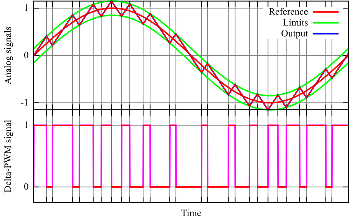

The source sound is PCM but I'm sampling it with PWM (I use the uC for that ) , the original PCM raw file ( I generated from my PC using Audacity and xxd command ) is 8bit 8Khz signal but the uC generate it at twice bandwidth 16KHz to catch up (with the real wave shape ) , (the uC have timer that handle this ) when I set PWM frequency at 8KHz the sound were too noisy with a lot of cracks .
Unfortunately I don't have oscilloscope but the output signal should look similar to this (this is not the actual wave ) .

Thanks for the waveforms. I see the lower one is marked "delta PWM"
I'm not sure that I follow this.
The PWM signal appears to follow the slope rather than the voltage. This is as also suggested by the "delta".
It is as if there is an integration somewhere.
I guess for a sineusoid, this would only be a phase change without the integral,. but still, am I missing an extra stage in your processing? Do you have an integral somewhere?
As Audioguru points out, the 16kHz carrier is a little low in that people will hear it directly.
Not familiar with modern PWM. Do you have a high enough clock behind the PWM to move the clock up a bit and still get the resolution you want?

OK, so if you have enough clock cycles to use a higher carrier, and still get the resolution you want, then higher is better.
If you arrange a low pass filter on the output, then this may cut the amount of carrier that the speaker sees. As I mentioned, I don;t know much about speakers: they are mechanical and so some will act as a low pass filter naturally. Audioguru said they have a resonance. Maybe that will workj for you.
Your waveforms show the PWM matching the slope of the signal.
In a simple sense, thje higher the carrier, the easier filtering it becomes as the filter cutoff to pass the audio spectrum, but eliminate the carrier gets easier: not as steep.
If you put the PWM signal to a low pass system, then it will see the local average signal, not the slope.
If your PWM waveform represents the audio voltage it will more faithfully represent the audio.
Unless I have missed a filter somewhere in your plan.
