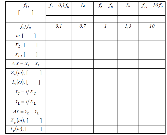

I have also got LC circuit task.
I add table, where are values, which I have to calculate (I guess all denotations/symbols are international):
1.1 We have got parallel LC circuit.
Have to calculate frequency f0, ratio of charge Q and total impedance Z(w) in the range (0.1 .. 10)f0.
And have to calculate input current (effective value) using given frequencies in the table, if we know that is added sinusoidal voltage amplitude 1 V to the circuit.
1.2 We have got series LC circuit.
GIVEN:
Rp = 180 kOhms = 180 * 10^3 Ohms
C = 2200 pF = 2200 * 10^(-12) F
L = 20 mH = 20 * 10^(-3) H
What I have already done:
I calculated frequency f0 for parallel and series circuits: w0 = 2*pi*f0 = 1/sqrt(L*C)
w0 = 1/sqrt(20*10^(-3) * 2200*10^(-12)) = 500000/sqrt(11) = ~150755.7
f0 = w0/(2pi) = (500000/sqrt(11))/2pi = 250000/(sqrt(11)*pi) = ~23993.5 Hz
XL = XC
XL = w * L = (500000/sqrt(11)) * 20*10^(-3) = 10000/sqrt(11) = ~3015
XC = 1/(w*C) = 1/((500000/sqrt(11))*2200*10^(-12)) = 10000/sqrt(11) = ~3015
for parallel circuit: Q = Rp/(w0*L) = 180*10^3/((500000/sqrt(11))*20*10^(-3)) = 18 sqrt(11) = ~60
Yc = 1/Xc = 1/(10000/sqrt(11)) = sqrt(11)/10000 = ~ 0.00033
YL = 1/XL = 1/(10000/sqrt(11)) = sqrt(11)/10000 = ~ 0.00033
I have got lack of understanding, why I have to calculate delta Y and delta X? Or I have done something wrong? XL = XC and YC = YL.. where is the point?
And speaking about parallel circuit, how to do this task - calculate input current (effective value) using given frequencies in the table, if we know that is added sinusoidal voltage amplitude 1 V to the circuit?
Later I will start to solve other tasks with series circuit, but yes, can someone can explain my questions..

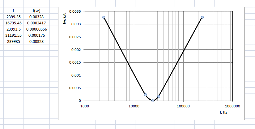

evol_w10lv
Feb 19, 2013
73
Feb 19, 2013
73
Great tutorial. It will help for me not just for this task. :)

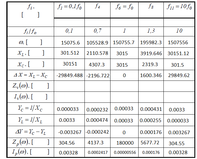

I used this formula:

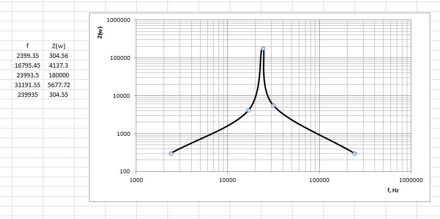

I calculated 5 values. Yes, it is not enough to get perfect graphic, but here is result:
All calculations I did by this algorithm:
f1:
f0 = ~23993.5 Hz
f1 = 0.1f0 = 2399.35 Hz
w = 2*pi*f1 = 2*pi*2399.35 = ~15075.6
XL = w * L = 15075.6 * 20*10^(-3) = 301.512
XC = 1/(w*C) = 1/(15075.6*2200*10^(-12)) = ~30151
delta X = XL - XC = 301.512 - 30151 = -29849.488
Yc = 1/Xc = 1/30151 = ~0.000033
YL = 1/XL = 1/301.512 = 0.0033
deltaY = YC - YL = 0.000033 - 0.0033 = -0.003267
Z = 1/(sqrt((1/R)^2 + ((1/XL)-(1/XC))^2)) = 1/(sqrt((1/180000)^2 + ((1/301.512)-(1/30151))^2)) = ~304.56
I = sqrt((U/R)^2 + ((U/XL)-(U/XC))^2) = sqrt((1/180000)^2 + ((1/301.512)-(1/30151))^2) = ~0.00328 A
Then I started to complete the table:
Can you take a look? I'm not speaking about results, but I want to know, weather content/essence is clear. And free spaces in the table left for series circuit. I will solve it later.

I don't have time to check the numbers in the table. But the graphics look exactly like I would have expected.
Good work.
