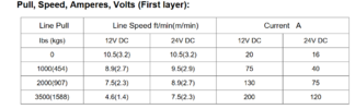

ok been searching all day can anybody tell me where to get a variable speed winch or how to determine the type of motor that I have, to then move on to how to tackle the task of making a PWM controller please, thanks

Spec says it's a permanent magnet motor. Full pull current is 200A at 12V.

That's reasonable. But applying the same factor of 5, that means the OP would be looking to source one rated at 5 x 114A = 570A !
The x5 would only apply to 'dodgy' source units. As per Bluejets saying 'quality' product, such a device would work when rated at 250A or even 200A with suitable fusing/breaker for protection.

Personally I'd use a 100A device (with suitable thermal/overcurrent trip, resettable) and be careful how I used it. I'd also use a bypass switch to run it at full current when that was necessary - probably not very often.
can I buy or is it better to make a controller?
Even a low current controller can be modified to work at MUCH higher currents by changing the switching device (probably a MOSFET) for one - probably a few wired in parallel - device rated for much higher current.
You can get N-channel MOSFETs rated at 30V and 500A (IRDS(on) value of 0.0007ohms!) for £1.20 at Farnell.
Use any good component supplier and their parametric search engines.

I have bought the winch a while ago and it's being stored at my friends till I come to use it. I'm just getting ready for when I do use it.
this seems like a good way to go, any controllers in mind? I would like push buttons to gradually increase current with each press and one to do down or a knob pot

No I want to gradually increase the speed of the winch, not just on or off, to take out the jerk, for that project a jerk would cause damage! when the winch turns on it immediatly goes from 0 m/s to 10.5 m/s I need it to be gradual! I have thought about it a lot to be fair

Its SCR is rated only 3A, not 200 !
oh I put the max amperage at 20 and multiplied by 12 for power equals 240watt so I thought the 300watt pot would work, I don't know what SCR is can you recommend a different one1706560264004.png

oooohhhhh I realised what I just did, derrrr 20 amp at no load!
