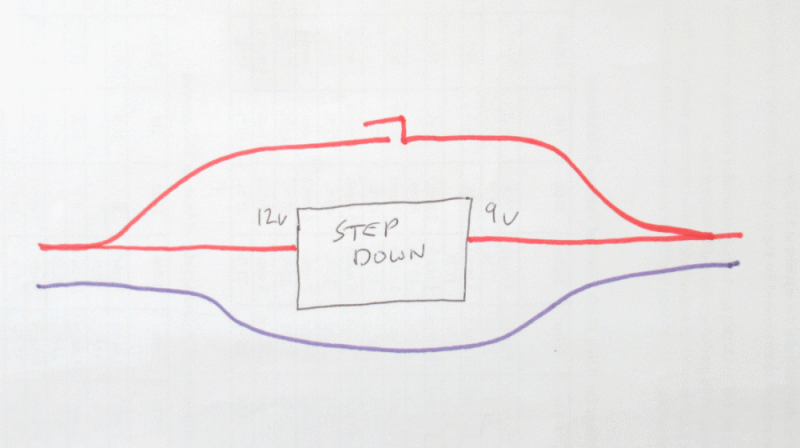

Hopefully my little diagram will make sense as to what I would like to do. My question is: would this be a safe way to switch between 12v & 9v (DC) or would this somehow damage the step down converter ?
the convertor is:
XL4015 Constant current/Constant voltage, Adjustable 5A Step Down Buck

Short answer is no. This would potentially dump current into the output of the
converter. No predicting what it would do.
A Schottky diode in output of converter then tie that to bypass switch output
and load should work. Note consult datasheet for converter, if it needs a minimum
load to stay in regulation. Note diode will drop the converter output when in use by its
forward V drop, so converter should be slightly adjusted, its output V, to
minimize diode V loss.
Note also the Schottky Vf versus T is ~ -1 to -2 mV / C, depending on Schottky
type.....
Regards, Dana.

What sort of size spec of diode should I be looking for ?
Bearing in mind I have access to a large amount of electrical bits and pieces, what am I looking for ?

Hello,
Try this, as @danadak suggested:
The SR diode will drop about 0.5 Volts at 5A.
Bertus
