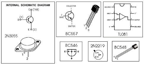

Mount the power transistor on the heatsink. To do this follow the diagram and remember to use the mica insulator between the transistor body and the heatsink and the special fibber washers to insulate the screws from the heatsink. Remember to place the soldering tag on one of the screws from the side of the transistor body, this is going to be used as the collector lead of the transistor. Use a little amount of Heat Transfer Compound between the transistor and the heatsink to ensure the maximum transfer of heat between them, and tighten the screws as far as they will go.
Attach a piece of insulated wire to each lead taking care to make very good joints as the current that flows in this part of the circuit is quite heavy, especially between the emitter and the collector of the transistor.

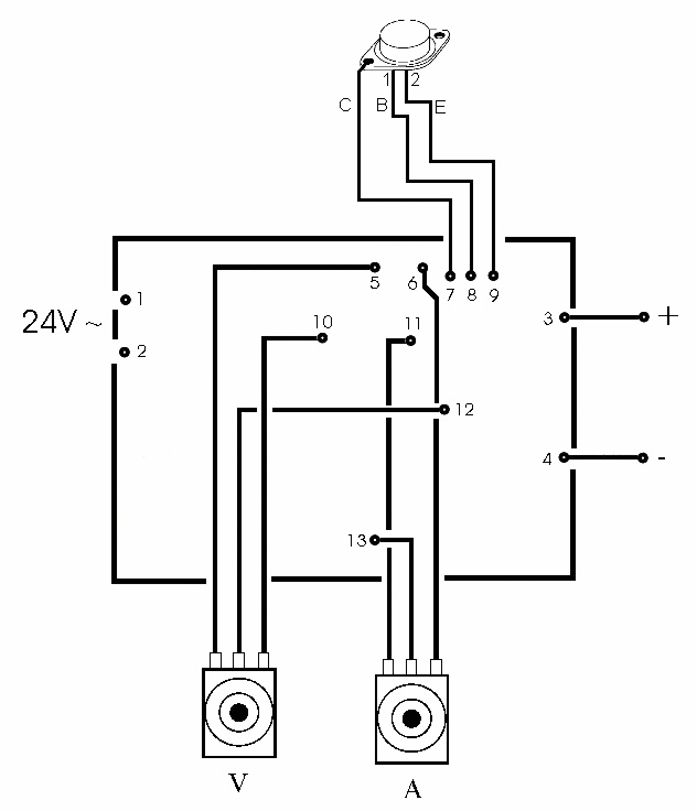

The external connections are:
  • 1 & 2 AC input, the secondary of the transformer.
  • 3 (+) & 4 (-) DC output.
  • 5, 10 & 12 to P1.
  • 6, 11 & 13 to P2.
  • 7 (E), 8 (B), 9 (E) to the power transistor Q4.
  • The LED should also be placed on the front panel of the case where it is always visible but the pins where it is connected at are not numbered.

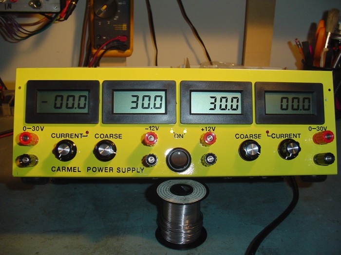

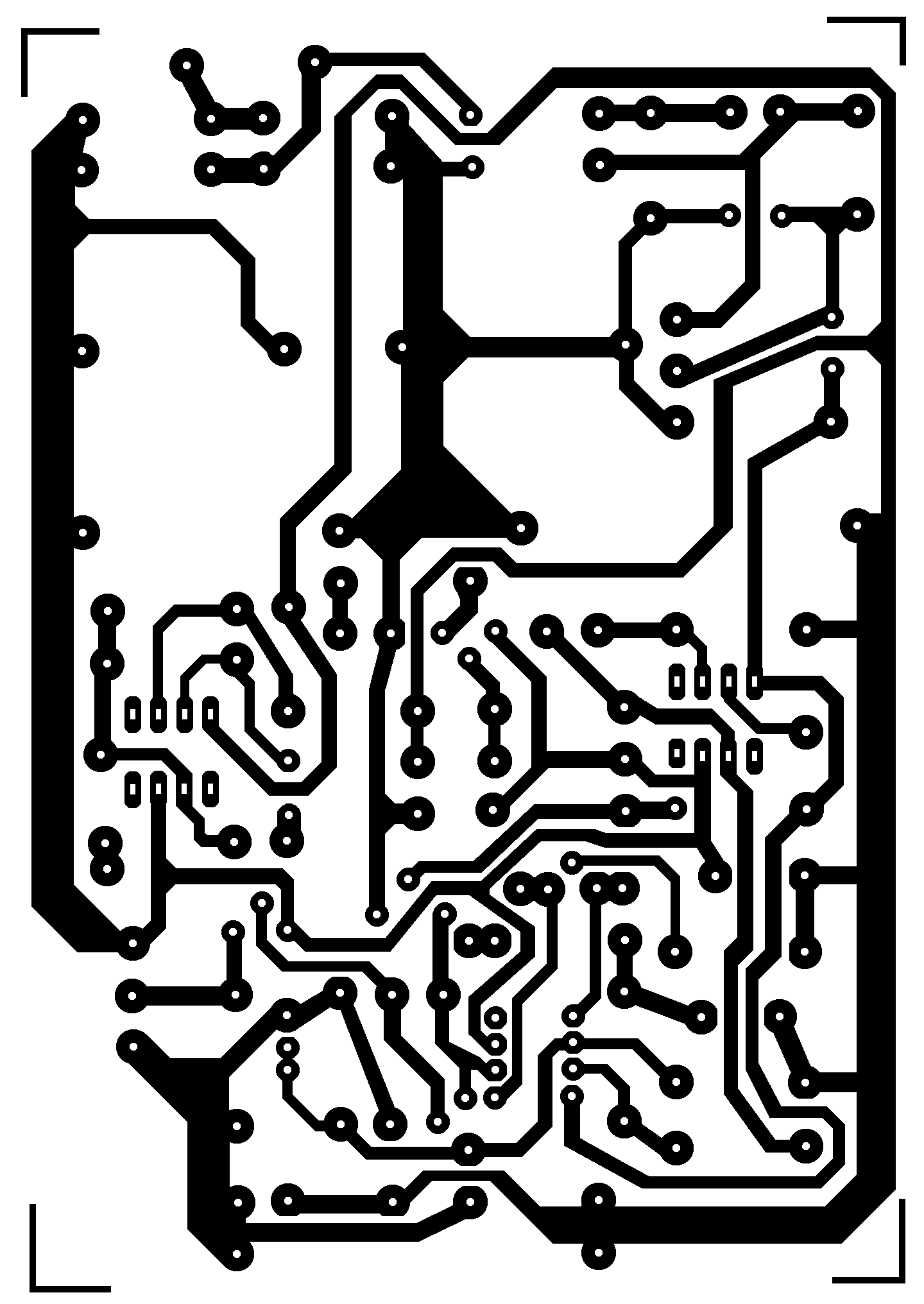

here is a board made by Sam Carmel and worked nice
photo_1

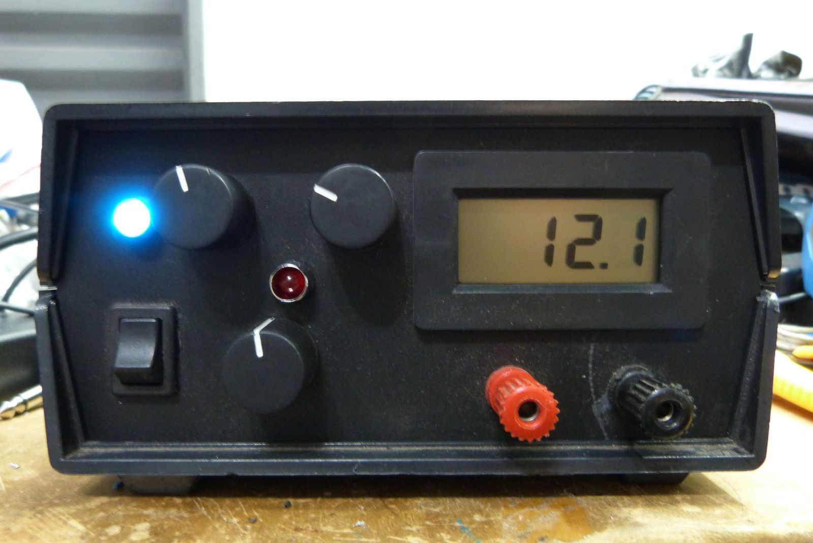

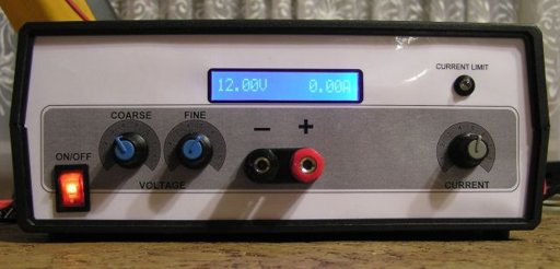

Daniel’s build of PSU – front view with LCD voltmeter
Potensiometers for coarse and fine voltage adjustment and current regulator

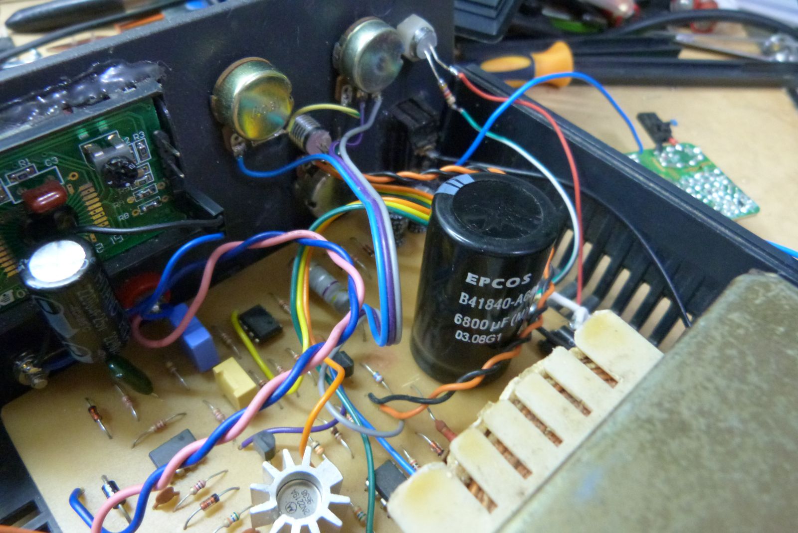

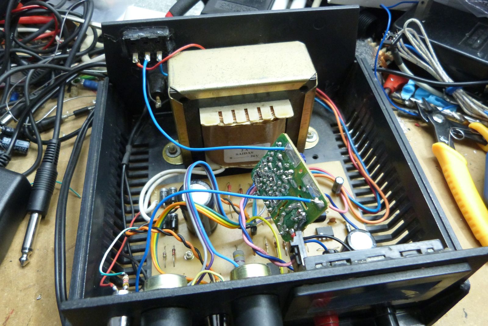

Daniel’s build of PSU – internal view. A mobile phone charger is used as power supply for voltmeter
photo_3

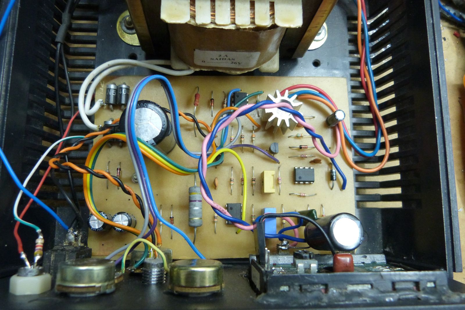

Daniel’s build of PSU – internal view. He is going to change 2200uF a 6800uF capacitor to reduce ripple in high load.
photo_5
Daniel’s build of PSU – internal view. new capacitor (6800uF x 40V) to improve ripple filtering
photo_4

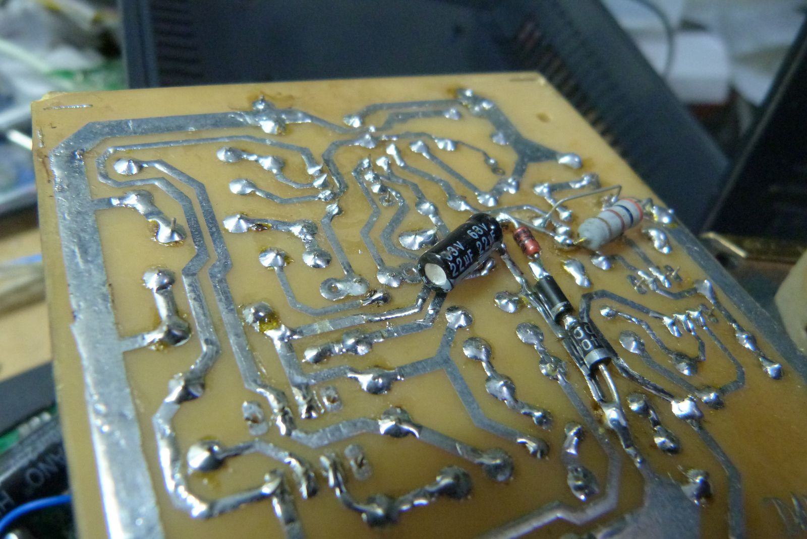

Daniel’s build of PSU – internal view. Modification to protect the LM311

Hi how can i donwload the pcb in the right size?

unfortunatelly I can’t find the 2n2219 transistor on market And I as told 2n2222 would it work?
