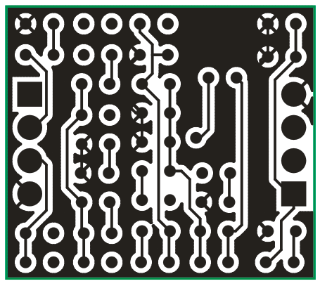

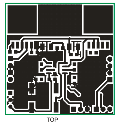

The circuit board does not match the circuit, Vin and Vee are connected on the right buffer
Ton
which means no, Vin and Vee are 2 and 3 legs of lme49600 and they are connected on a printed circuit board
Ton
No problems, be careful, pcb with errors, I downloaded gerberas, if someone repeats, then will be disappointed … i remake pcb, this my pcb http://radioaktiv.ru/engine/download.php?id=307
