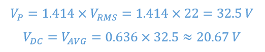

The power supply circuit of the previous article using a half-wave rectifier is used here to compare the results. The voltage source of 220VRMS with 100:1 transformer was used to supply a load of 1 kΩ Using bridge full-wave rectifier:

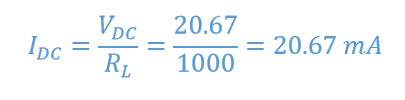

An approximate 20 VDC appears across (forward diode voltage drops are ignored to keep things simple) the load and the current flow through 1 kΩ load is:

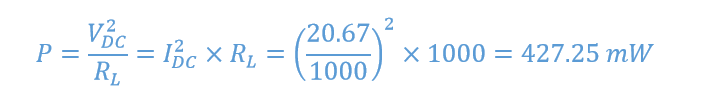

The power delivered to the load using a full-wave bridge rectifier:
The full-wave rectifier delivers twice the voltage and quadruple power to the load as compared to the half-wave rectifier. It makes the full-wave rectifier more efficient and for the same voltage power supply a smaller transformer can be utilized compared to using a half-wave rectifier. For example, using a half-wave rectifier, a 10:1 ratio transformer is used to supply approx. 10 VDC to the load when input is 220VRMS. However, a 5:1 ratio transformer can be utilized to deliver the same load voltage using a full-wave bridge rectifier.

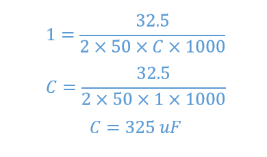

The ripple voltage for a full-wave rectifier is given by the following formula and note that ripple frequency has doubled as compared to half-wave rectifier:
For example, if the desired ripple voltage is 1V for the above example then the value of the capacitor filter is:
So, a capacitor of 325uF is required to have a ripple voltage of 1 V for a bridge rectifier power supply given in the above example.

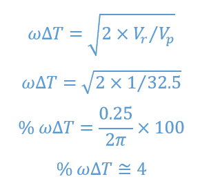

The diode conduction period can be approximated by the following formula:
The diodes will conduct during only 4% of the total period and the rest of the period load will be supplied by the capacitor.
