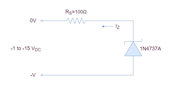

Reverse-biased Characteristics
The diode when operated in reverse-biasing mode, no current flows through it until an avalanche breakdown occurs upon reaching a certain reverse voltage. Under this condition, a large stream of electrons could damage a signal diode. However, in the Zener diode, a Zener breakdown occurs due to the strong electric field produced by a thin depletion layer of the PN junction. The voltage at which Zener breakdown occurs is called VZ (Zener Voltage). The Zener diodes are produced to have different levels of Zener voltages as per application and voltage requirements. Once Zener breakdown occurs, a further increase in reverse voltage does not cause any further voltage drop and remains constant up to a certain voltage level until an avalanche breakdown occurs. In a nutshell for a reverse-biased Zener diode, it remains off (minor amount of current flows) from 0V to Zener Voltage (VZ). From VZ to avalanche breakdown, small changes in applied voltage cause a rapid increase in reverse current flow.
Reverse-biased Zener Diode
Figure 3: Zener Diode (1N4737A) reverse-biased

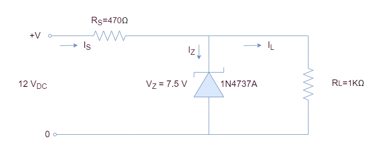

Voltage Regulator:
The most common use of a Zener diode is in power supplies as a voltage regulator. At Zener Breakdown and beyond in reverse direction, the voltage drop i.e. Zener Voltage (VZ) remains constant and any variation in applied voltage does not cause any change in it. A reverse-biased Zener diode in series with a current limiting resistor supplies a constant voltage to loads connected parallel to it. The load voltage remains equal to Zener Voltage (VZ).
Example
Zener Voltage Regulator
Figure 5: Zener Diode as voltage stabilizer/ regulator
For the circuit given in figure-5 at least, a VDC of 12V is required to produce an output of 7.5V with a load of 1KΩ.

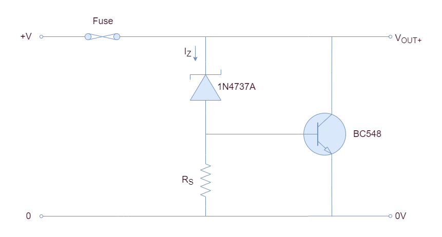

Overvoltage Protection
For the circuit shown in the figure-7, any voltage above Zener Breakdown causes a current flow through the resistor. A voltage drop occurs across this resistor which turns on the transistor and shorting the path. The heavy current flows and opens the fuse to disconnect the circuit.
Figure 7: Zener diode in over-voltage protection circuit

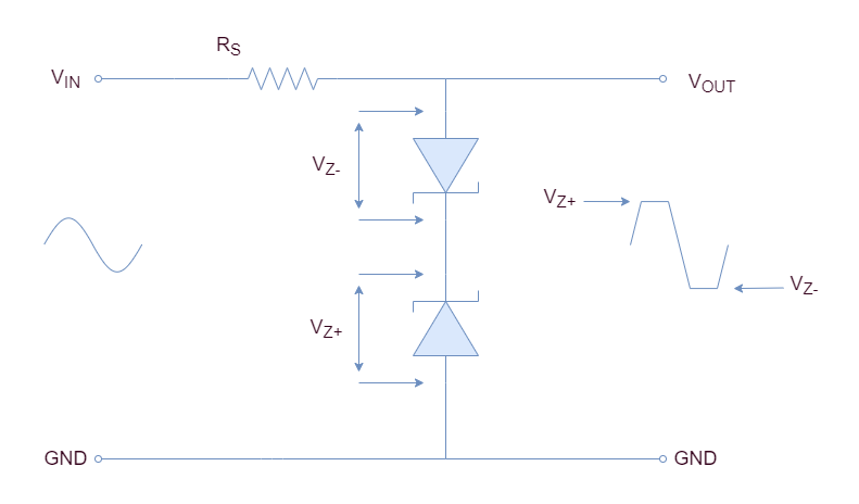

Clipping Circuits
When AC voltage is applied to the Zener diode then any voltage above Zener breakdown is clipped off. The two diodes connected in series with opposite directions cause clipping of AC in both positive and negative cycles. An example of a clipping circuit is a sine to square wave converter.
Zener voltage clipper
Figure 8: Zener diode in the wave clipping circuit
