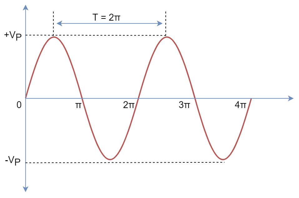

Sine Wave
Figure 2: A Sinusoidal Wave signal.

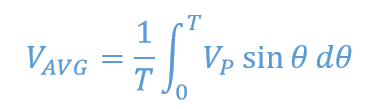

The average value of the periodic signal is given below:

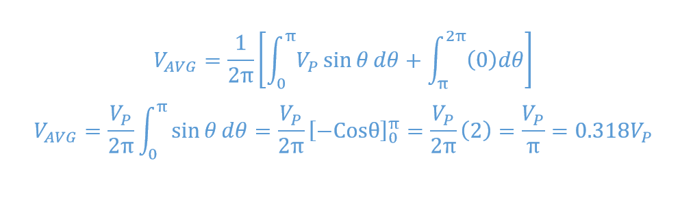

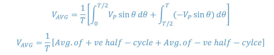

For a sinusoidal signal, the positive half-cycles equals negative half-cycles, and such cancels out to zero average. For a half-wave rectifier, the average is given as follow:

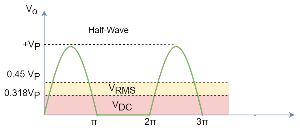

Half-Rectifier
Figure 3: Half-Rectified Sinusoidal wave.
The half-rectified figure shows, Time Period = 2π and no (zero) signal during the negative (-) half-cycle, resulting in:

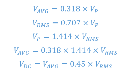

Similarly, the root means square (RMS) represents the DC equivalent of an AC signal for power calculations and calculated as:
In a nutshell, for a half-wave rectifier:

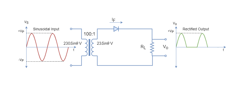

Now, consider the following half-wave rectifier circuit in which a transformer (100:1) is used to step down the mains supply from 230VAC to 23VAC.
TR Half-Rectifier
Figure 4: A typical half-wave power rectifier example.

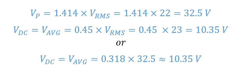

Using the above formulas on the secondary side of this circuit:

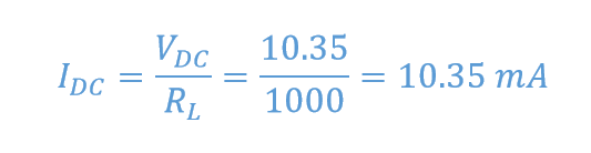

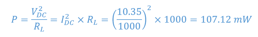

So, a 10VDC appears across the 1 kΩ load. The average current flowing through the load:
For power dissipation, the following formula can be used on the supposition that it is purely a DC signal.

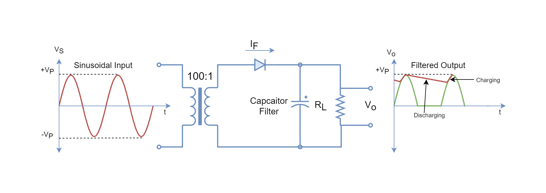

The ripples can be primarily avoided using a shunt capacitor and called filter capacitor or smoothing capacitor because of its purpose in the circuit. A half-wave rectifier circuit with a capacitor filter is shown in the following figure. The circuit is called a peak rectifier.
Filter Capacitor Half-Rectifier
Figure 5: A Half-Wave power rectifier with capacitor filter.

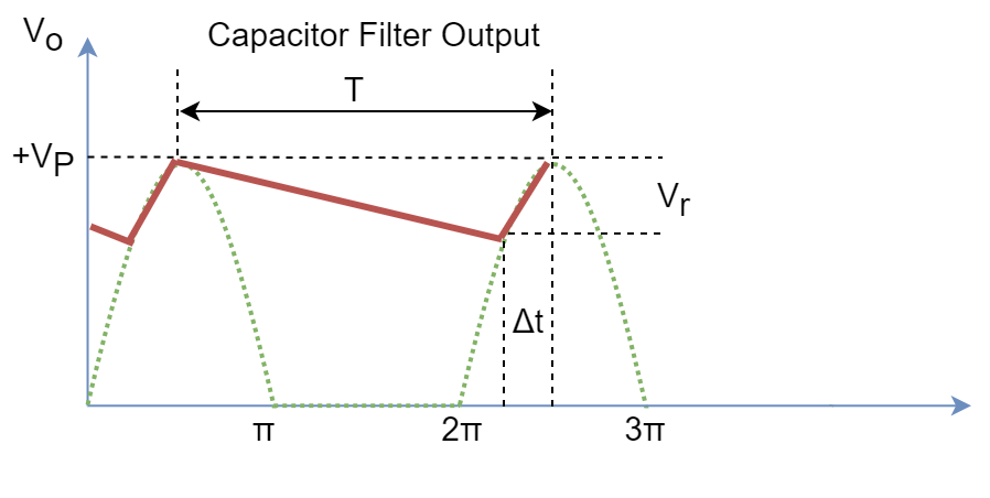

The capacitor acts as a storage or reservoir and supplies the load during the OFF period. The value of the capacitor should be large enough so that its time constant (RC) >> time period of the sinusoidal signal. The capacitor gets charged to peak voltage on the initial positive cycle and when the negative cycle starts, the diode cuts off supply to the capacitor. The diode supplies the load and charges the capacitor during the (Δt) period. For the rest of the period, the capacitor supplies the load current until input voltage becomes equal to capacitor decaying voltage during the next positive cycle. The capacitor recharge starts and the process keeps repeating.
Ripples filtering
Figure 6: Output half-wave after usage of capacitor filter.
The ripple voltage for a half-wave rectifier is given by the following formula:
