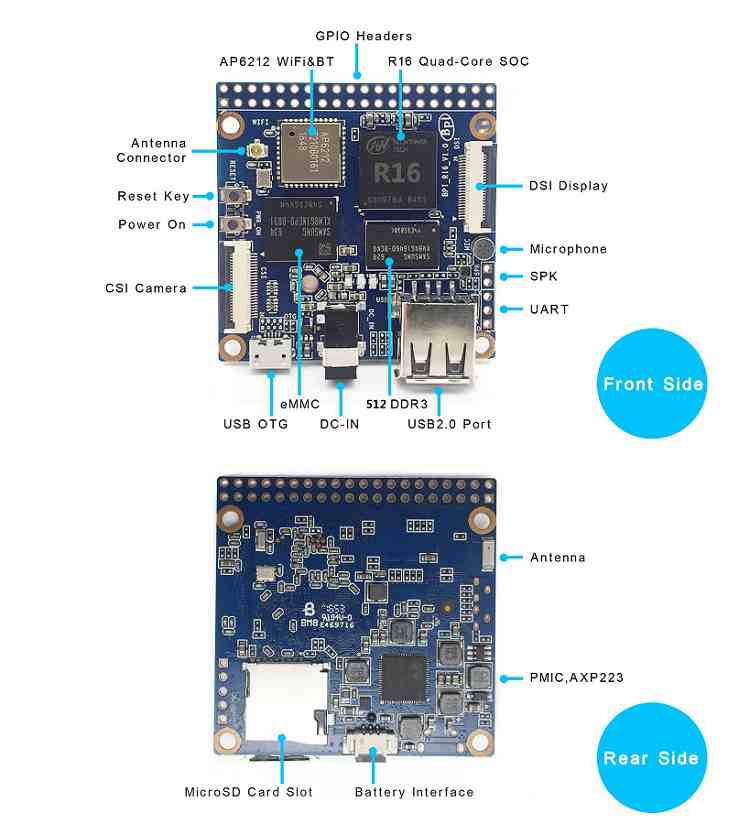

Alongside the processor and the memory at the front side of the board, you will find a 40-pin GPIO header, a DSI display slot, an Antenna connector, a CSI camera slot, a USB OTG adapter, a USB2.0 port, a microphone and a DC power jack. On the rear side, there is an antenna, a PMIC AXP223, a battery interface and a microSD card slot.
Front and rear sides
