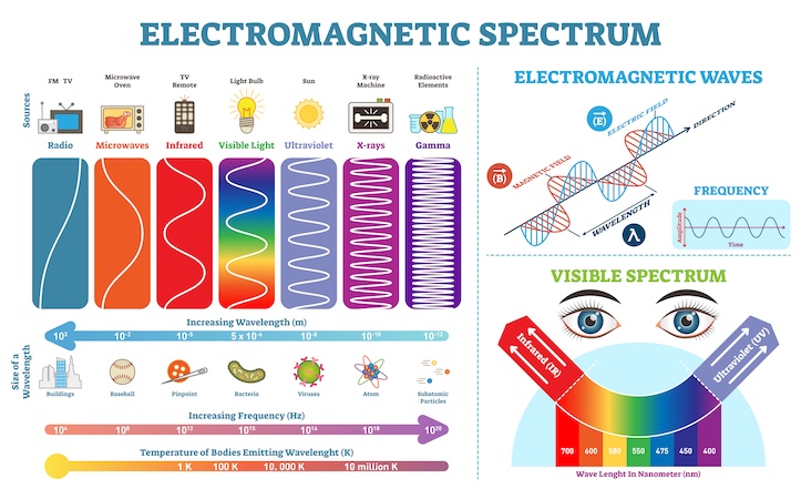

This chapter uses the term RF to describe the portions of the electromagnetic spectrum (Figure 1) used for wireless communication, data signals, power transfer, and RF-based sensing up to the lower regions of the infrared spectrum.
Figure 1: Electromagnetic frequency ranges, where radio and microwaves are designated as separate portions of the spectrum. (Source: VectorMine/stock.adobe.com)

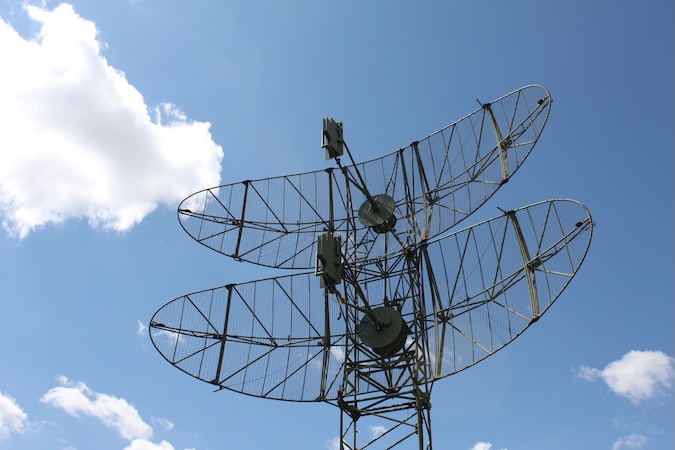

Radar is a very prevalent use of RF sensing techniques to determine the distance, velocity, shape, and structure of stationary and mobile objects, including environmental obstacles and terrain. With radar, a continuous, ramped, or pulsed RF signal is produced by the radar transmitter and directed to an RF transducer (antenna, aperture, or antenna array) that sends directed wavefronts (Figure 2). The resulting reflections from environmental features and targets are then captured and analyzed to extract radar target characteristics. Based on the radar signature of a target, it is even possible to identify characteristics, such as Doppler shifts and cross-sectional and reflection patterns. This use allows the differentiation of aircraft. Radar can also be used for topographical analysis and terrain mapping by aerial or orbiting platforms. Technologies such as synthetic aperture radar (SAR) can be used by satellites and high-altitude aircraft to pass over terrain and generate highly accurate topographical data. Other examples of common radar use are automobile safety systems that detect objects to the front, sides, and rear of a vehicle for automotive safety system use or even fully autonomous driving.
Figure 2: A legacy radar system with separate transmit and receive antennas. (Source: Koapan/stock.adobe.com)

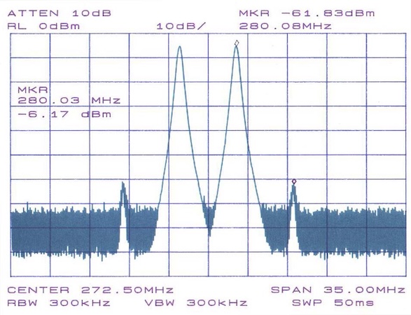

Where noise, interference, and distortion are injected within an RF signal chain dictates the significance of the nonidealities in the performance of the RF circuit. For instance, unwanted signals injected after a low-noise amplifier (LNA) do not get amplified as much as those injected before the LNA. They may have only a minor effect on the signal quality and the receiver circuitry processing the signal if the desired signal gain remains significantly stronger than the unwanted signals. However, if unwanted signals are injected before an LNA or power amplifier (PA), they will be amplified by the same gain factor as the desired signal. This can degrade RF signal processing and, in some cases, damage upstream or downstream components.
This potential degradation can be especially challenging with nonlinear components such as amplifiers and mixers, as unwanted signal content can be further unintentionally distorted or even mixed into sensitive frequency ranges that conflict with the desired performance of the RF circuit or nearby RF circuits. In communication systems with many closely spaced channels, intermodulation distortion is a common concern. With intermodulation distortion, two or more signals that enter a nonlinear circuit feature could mix, producing the sum and difference frequencies and a series of harmonics (Figure 3). If the signals are of high enough amplitude, the resulting distortions could be enough to desensitize a receiver or even overwhelm a frequency channel and prevent communications.
Figure 3: RF channel measurement showing the frequency spectrum of intermodulation distortion. (Source: RF Intermodulation at 280 MHz, © Nader Moussa, used under Creative Commons Attribution-ShareAlike 3.0 Unported)
