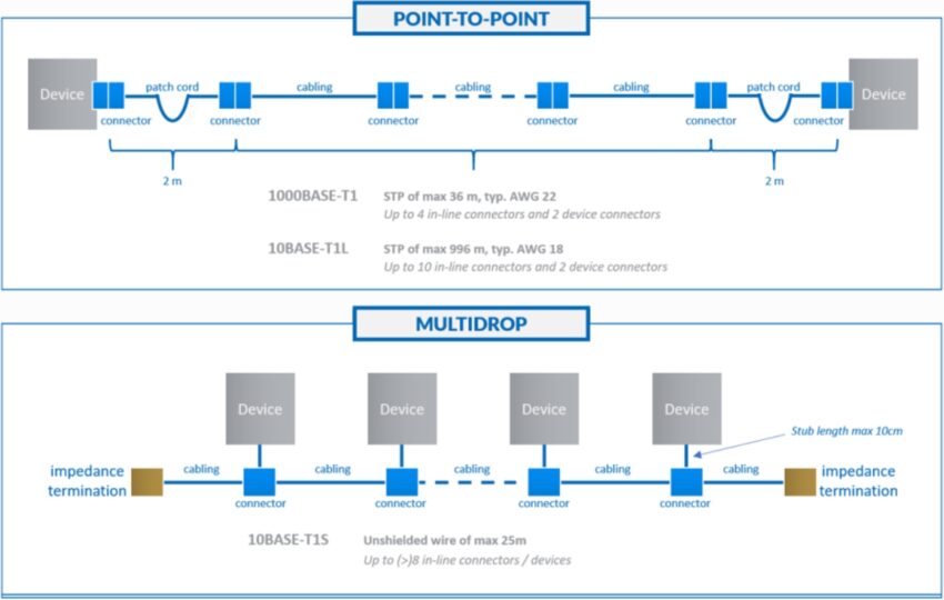

SPE is not a single specification. It is a family of specifications. Each variant balances reach and speed differently.
10BASE-T1L (802.3cg) delivers 10 Mbps over distances up to 1,000 meters. This makes it well suited for process industry field instrumentation, where sensors often sit far from a control cabinet.
10BASE-T1S (802.3cg) targets a different use case: short, multidrop links. It supports links up to 25 meters, shared among multiple nodes without a switch, using Physical Layer Collision Avoidance (PLCA). PLCA lets many devices share one pair deterministically. This is similar in spirit to older multidrop fieldbuses, but it runs native Ethernet frames.
100BASE-T1 (802.3bw) and 1000BASE-T1 (802.3bp) target higher speeds: 100 Mbps and 1 Gbps, respectively. Their reach is shorter, typically 15 meters for a 1000BASE-T1 point-to-point link. These two variants are the most widely adopted in automotive in-vehicle networks. They connect cameras, radar, and infotainment backbones.
Table 1. Comparison of the four IEEE 802.3 Single Pair Ethernet variants by data rate, maximum reach, topology, and typical application.
Variant IEEE Standard Data Rate Max Reach Topology Typical Application
10BASE-T1L 802.3cg 10 Mbps 1,000 m Point-to-point Process industry field instrumentation
10BASE-T1S 802.3cg 10 Mbps 25 m Multidrop (PLCA) Short-reach sensor and actuator networks
100BASE-T1 802.3bw 100 Mbps 15 m Point-to-point Automotive in-vehicle networks
1000BASE-T1 802.3bp 1 Gbps 15 m Point-to-point Automotive cameras, radar, infotainment backbones
Figure 2. A simple topology diagram showing a 10BASE-T1S multidrop bus next to a 1000BASE-T1 point-to-point link. Image used courtesy of SPE Industrial Partner Network

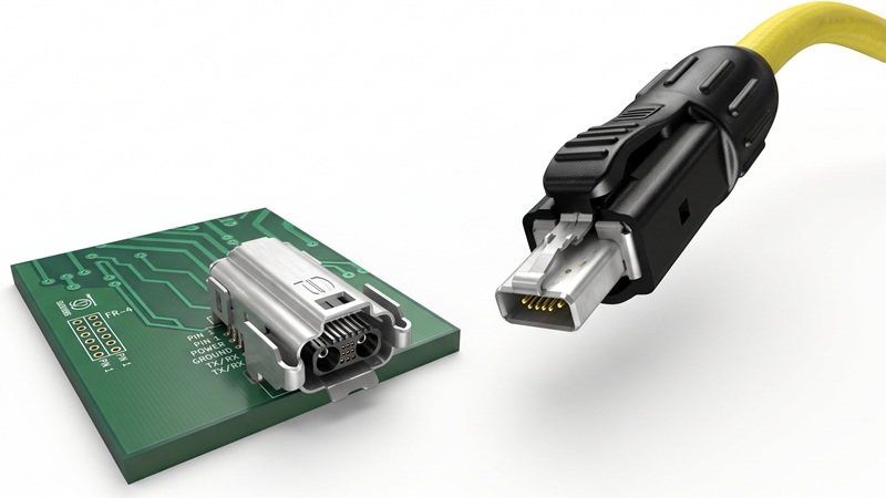

Connectors have also been standardized specifically for SPE, rather than reusing RJ45. IEC 63171-6 defines a compact, keyed connector family for industrial SPE deployments. Automotive applications typically use sealed, vibration-rated connectors instead, suited to under-hood or chassis environments. Both connector types are deliberately smaller than RJ45, supporting the density and space savings that motivate SPE in the first place.
Figure 3. A HARTING T1 Industrial connector—one of the compact, keyed designs standardized under IEC 63171-6 for SPE deployments. Image used courtesy of Mouser
