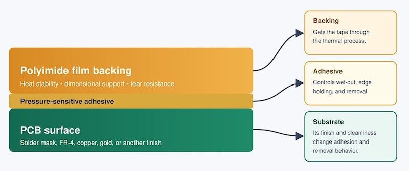

These failures are easily lumped together as “the tape did not withstand the heat.” Usually, that diagnosis is too simple. The polyimide film may have survived exactly as expected. However, as shown in Figure 1, PCB masking involves a multilayer stack. It is not just a film. What failed may have been the seal at the edge, the adhesive after thermal exposure, the way the tape was applied, or the conditions under which it was removed.
Figure 1. Masking is a complex, layered construction, not just a film
That is the useful way to approach polyimide tape for PCB masking: not as an amber film with an impressive maximum-temperature number, but as a temporary process material. It has to protect a defined area through a defined soldering cycle and then leave the board in an acceptable condition.

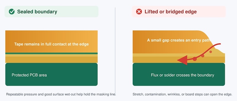

A pressure-sensitive adhesive requires intimate contact with the board. Dust, oil, fingerprints, process residues, and uneven solder-mask texture can leave channels at the boundary. Pads, legends, vias, and connector geometry make sealing harder. A stiff tape may bridge a step rather than follow it.
Application technique matters too. Pulling the tape tight may look neat, but stored tension can encourage the edge to retract when heated. Light finger contact may hold the strip while leaving the boundary insufficiently bonded. Moving to the highest-tack option can create a removal problem without correcting poor contact.
If solder or flux has crossed the mask, inspect the boundary before changing materials. The strip may remain attached while a small boundary gap allows flow or solder to reach the protected area (Figure 2). Look for a lifted corner, a wrinkle, a board step, or an unbonded path. Use an assembly-approved cleaning method, let the surface dry, place the tape without stretching, and apply repeatable edge pressure. On narrow gold fingers, width tolerance and placement may matter as much as nominal adhesion.
Figure 2. Edge effects are critical in PCB masking with polyimide tape
The practical test is not whether the roll feels sticky. It is whether an operator can create the same sealed boundary on successive boards without unusual skill or extra rework.
