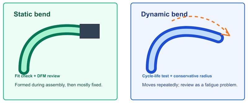

The first question is whether the flex area is static or dynamic, as they require different radius assumptions and validation plans (Figure 1).
Static vs dynamic bend
Figure 1. When beginning a new design, the FPC application must first be categorized as either static or dynamic.
A static bend is formed during assembly and then remains mostly fixed during product life. Examples include a folded interconnect inside a camera module or a flex tail wrapped once into a compact enclosure. Static bends can usually tolerate a tighter radius than moving applications, but they still need controlled geometry and good transition design.
A dynamic bend moves repeatedly during use. Examples include hinges, sliding mechanisms, wearable devices, robotic sensors, and other assemblies where the circuit bends thousands or millions of times. Dynamic flex zones need a larger radius, simpler copper geometry, and more conservative strain limits.
Many early design mistakes come from applying static bend assumptions to a dynamic application. If the bend will move in service, the layout should be reviewed as a fatigue problem, not just a packaging problem.

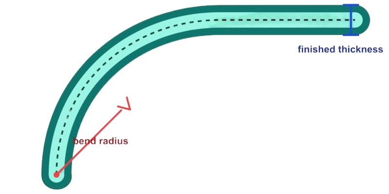

Estimate Radius From Finished Thickness
Bend radius is commonly discussed as a multiple of finished flex thickness (Figure 2). This is useful because strain increases as the bend radius becomes smaller relative to the stack thickness.
Figure 2. The ratio of the finished FCP thickness to the bend radius is an important design factor.
As a practical screening rule, simple static bends may start around a few times the finished thickness, while dynamic applications often need much larger ratios. Exact requirements depend on material, copper thickness, adhesive system, layer count, coverlay, and cycle life. The important point is that the calculation should use the finished flex thickness, not only the polyimide core thickness.
Engineers should also confirm whether the bend area is single-sided, double-sided, or multilayer. A single copper layer near the neutral axis is generally easier to bend than a thick multilayer structure. If the design requires multiple copper layers through a bend zone, the radius should be reviewed more conservatively and confirmed with the fabricator.
