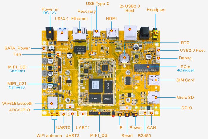

The Idea3588S is another SBC featuring the octa-core Rockchip RK3588S System-on-Chip. It features 32GB eMMC flash(Expandable up to 128GB) and 8GB LPDDR4X memory(Expandable up to 16GB).
The Idea3588S is another SBC featuring the octa-core Rockchip RK3588S System-on-Chip. It features 32GB eMMC flash(Expandable up to 128GB) and 8GB LPDDR4X memory(Expandable up to 16GB). With an additional companion board, this device can support GbE LAN, Wi-Fi/BL 5.1, dual displays, and camera interfaces.
The RK3588S features 2.4GHz Quad-core Cortex-A76  and 1.8GHz Quad-core Cortex-A55. Additionally, it has a Mali-G610 MP4 GPU and a 6 TOPS NPU. The GPU has support for support for OpenGL ES 1.1/2.0/3.2, OpenCL 2.2, Vulkan 1.2.
The Idea3588S comes with a broad range of connectivity options, including a USB 3.0 Type-C port, USB3.0 and USB2.0 host ports. It also features Gigabit Ethernet, a Mini PCIe socket, a Nano SIM card with a 4G LTE modem, a micro SD card slot, and many more.
The SBC supports up to 8K resolution at 60 FPS, while the MIPI DSI interface supports up to 4K at 60 FPS. It features a 3.5mm audio jack and 8-channel audio output via HDMI.
The board offers various RAM and storage options, with RAM available in 2GB, 4GB, or 8GB configurations and storage capacities ranging from 8GB to 128GB eMMC flash.
Specifications listed for the Idea3588S:
  • Memory: 8GB LPDDR4X, expandable to 16GB
  • Storage: 32GB eMMC, expandable to 128GB, MicroSD slot
  • Camera Interface: 2x 4-lane MIPI-CSI
  • Expansion Slot: 1x Mini PCIe
  • Display: HDMI 2.1, MIPI DSI
  • Audio: 3.5mm jack, 8-channel output via HDMI
  • Connectivity: Gigabit Ethernet, WiFi (802.11a/b/g/n/ac/ax), Bluetooth 5.1
  • I/O: Debug serial port, 3x UART, 1x RS485
  • USB: 1x USB3.0 Type-C, 3x USB2.0 Host, 1x USB3.0 Host
  • Controls: Recover, Reset, Power buttons
  • Additional Features: RTC with battery connector, IR receiver
  • Power Supply: 12V/3A DC
  • Dimensions: 145.0 x 105.0mm (carrier board), 57.5 x 45.0mm (CPU module)
The company will extend software support for Android 12 and Debian 11. Pricing details for the Idea3588S SoM have not been disclosed by Boardcon; further information can be found on the official product page.
