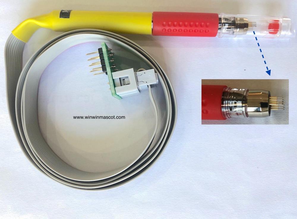

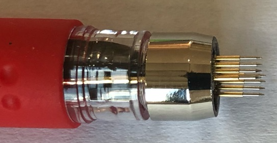

Franco Posted June 22, 2019 Report Posted June 22, 2019 I have purchased this Tssop/Msop adapter to copy or programming some devices, and this works fine. http://www.winwinmascot.com/sale-8784423-soic8-tssop8-pogo-pin-adapter-for-eeprom-93cxx-25cxx-24cxx-ar32-vvdi-2-tools-programmer.html Quote
