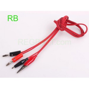

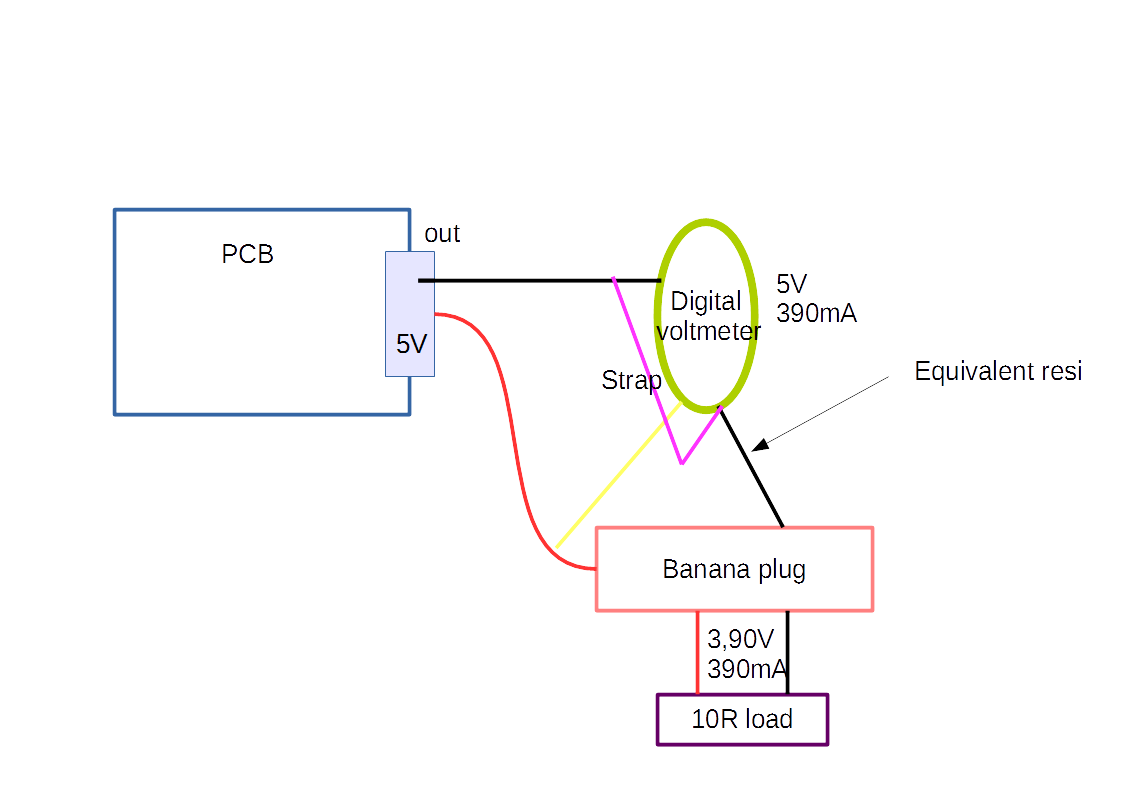

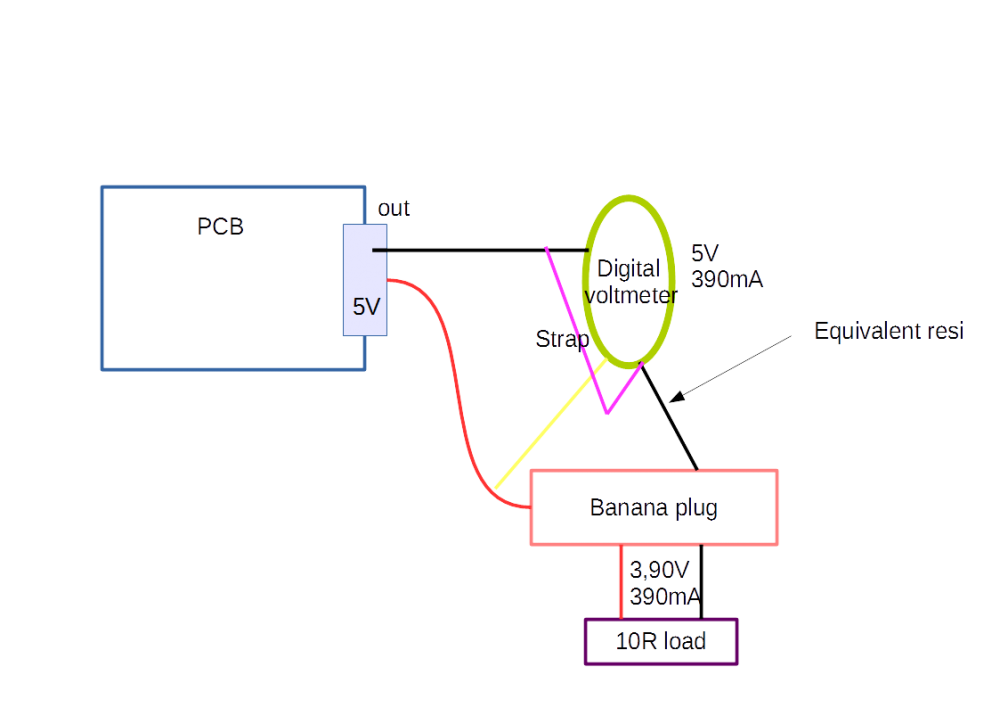

Tintin Posted March 13, 2018 Report Share Posted March 13, 2018 If my theory is good, the wire between output and banana plug have a resistance of 2.82R. How to calcul it : R1=U*R2/U2 - R2 R1=5V*10R/3.90V-10R=2.82R. That explain : a) why the chinese voltemeter "see" 5V and not 3.90V after bananaplug why with 10R load for 5V =>3.90V at output for 8V = >6.90V output for 10V =>7.50V output c) why, when i test with my electronic load, with 100mA on my electronic load I have a current of 282mA ! This evening I try to measure the resistor of the wire, I will change it tomorrow. Quote Link to comment Share on other sites More sharing options...
Tintin Posted March 13, 2018 Report Share Posted March 13, 2018 I find the problem of the fallen voltage, it is due to a Fucking wire like this who have a 2.8 ohms resistor : So I can test now the current limiter function correctly ! Quote Link to comment Share on other sites More sharing options...
audioguru Posted March 13, 2018 Report Share Posted March 13, 2018 I use copper wire, not rice wire. They put rice in everything they make, especially batteries. electron234 1 Quote Link to comment Share on other sites More sharing options...

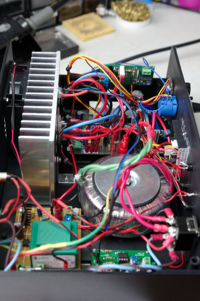

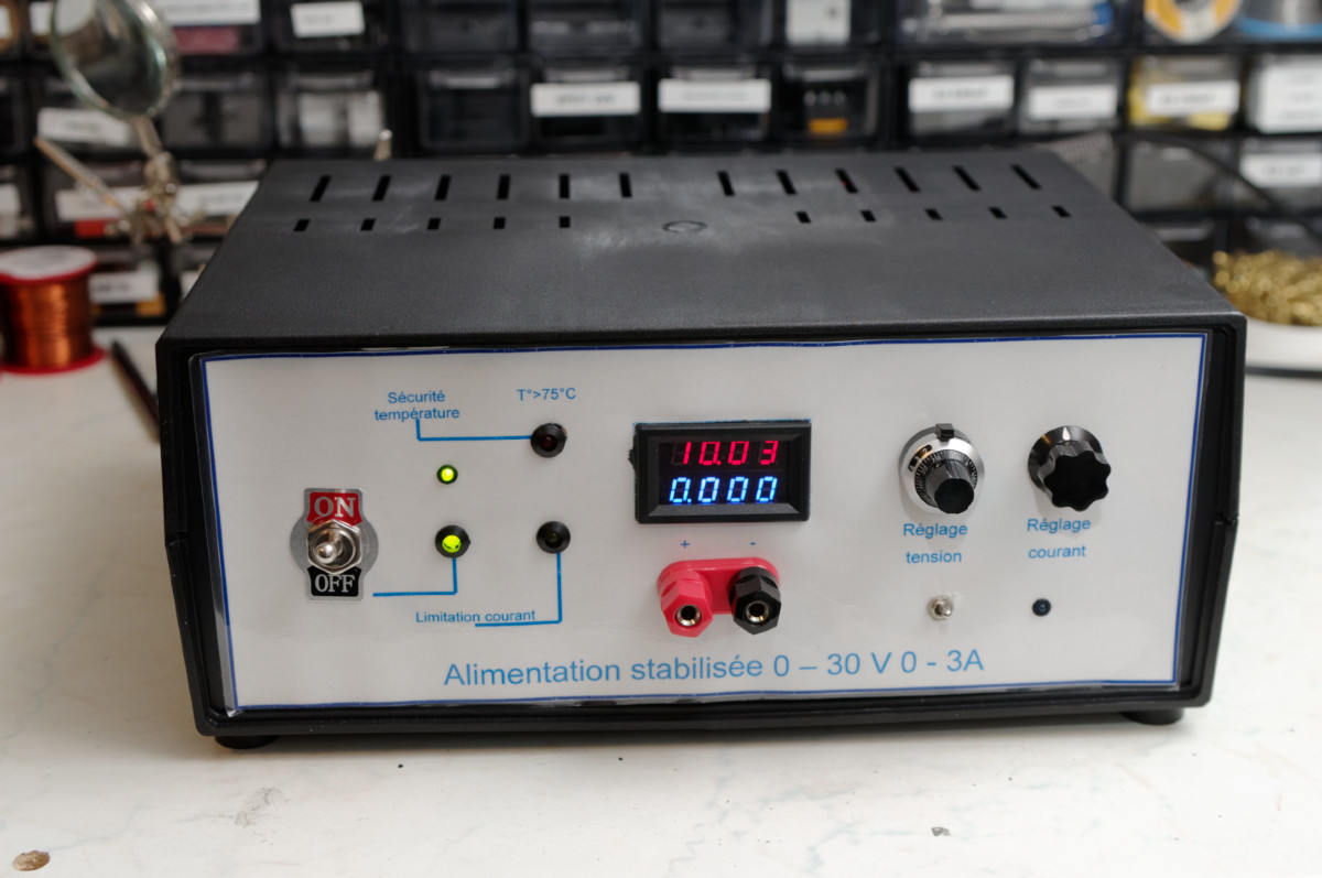

Tintin Posted March 18, 2018 Report Share Posted March 18, 2018 Hi, I just finish my power supply ! I made a PDF document (with a lot of picture and explanation) who resume all the story about this adventure, and made a lot of measurment ! It is in French but I will translate in English soon. I thank all this community, who made a great job ! I join you some photos and my work on a PDF format. Alimentation0_30V.pdf johanh 1 Quote Link to comment Share on other sites More sharing options...

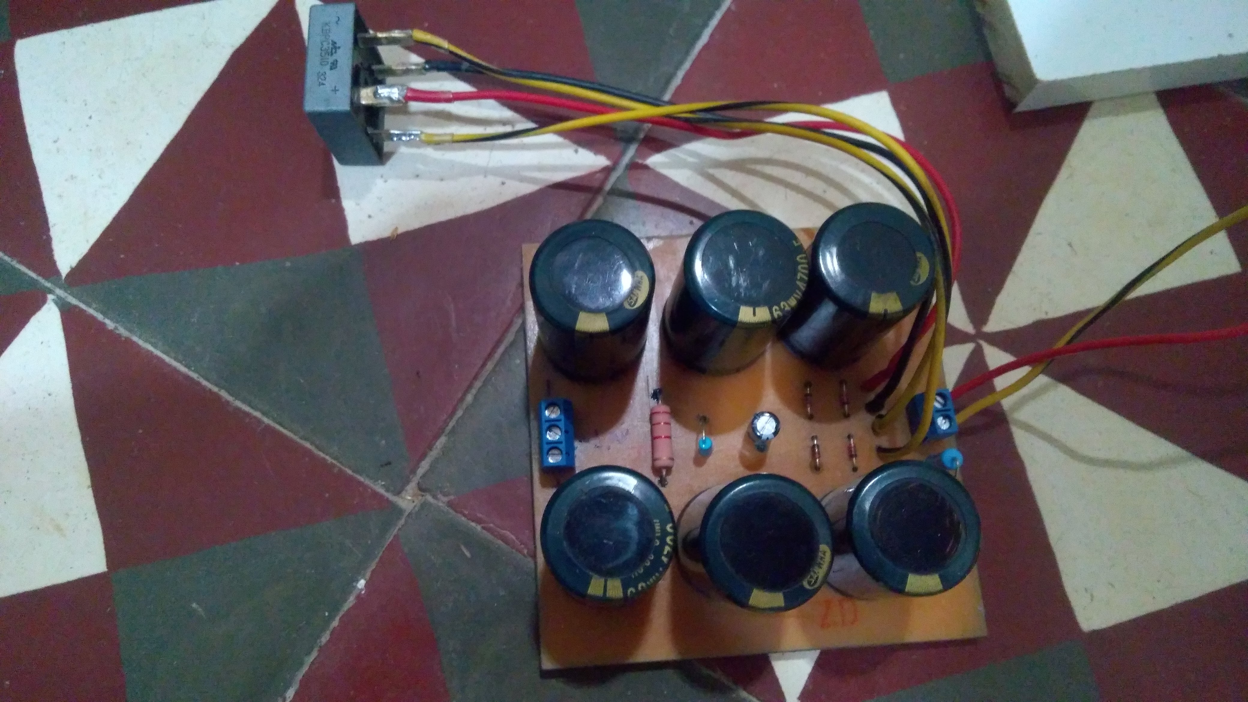

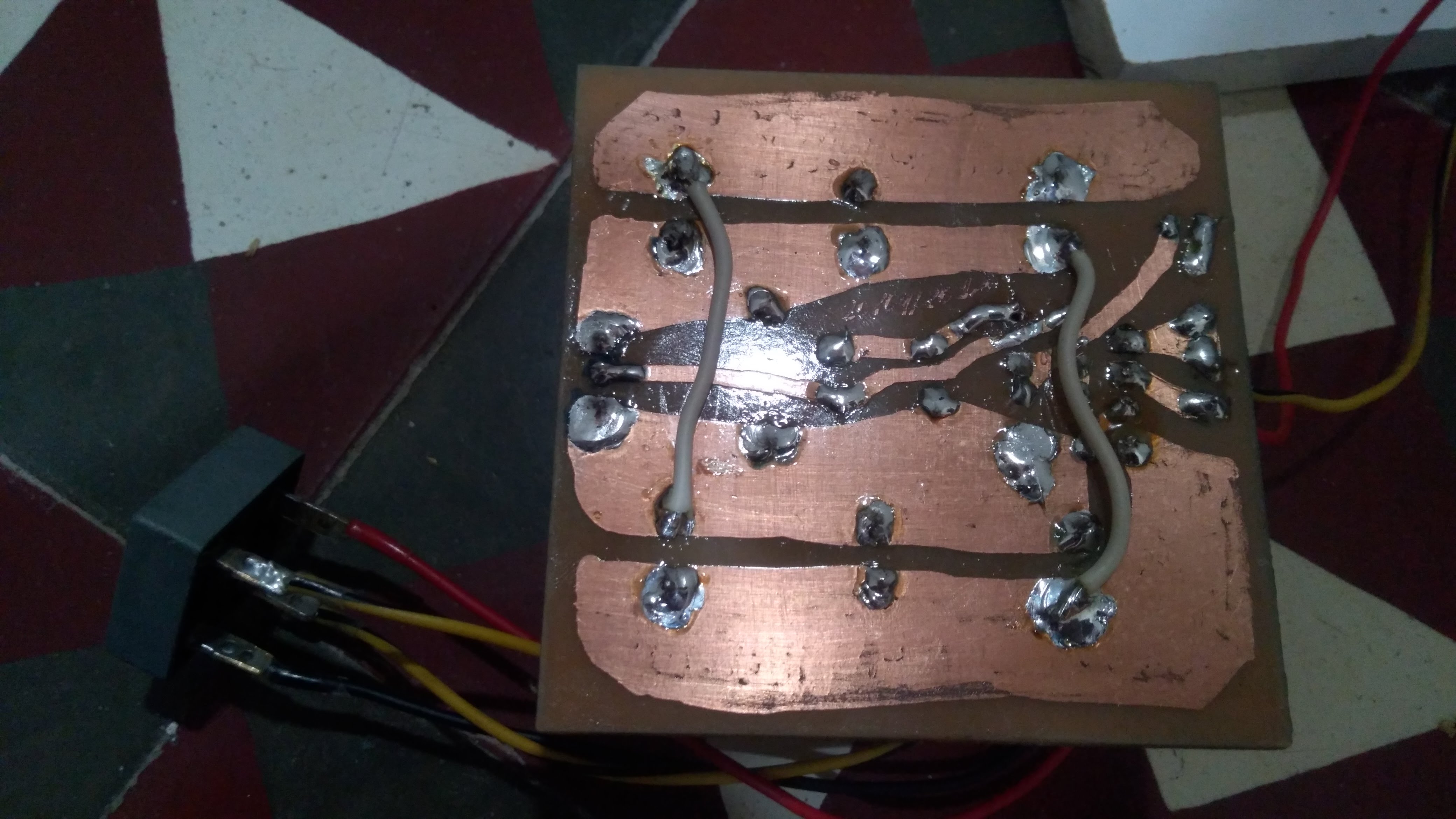

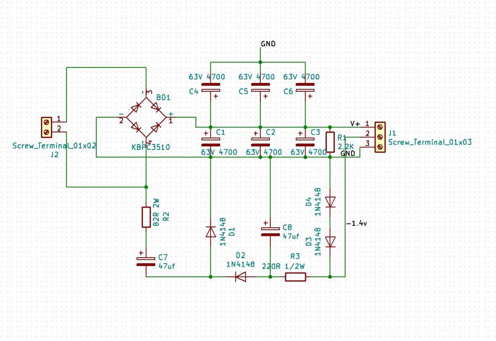

detonatorinf Posted May 6, 2018 Report Share Posted May 6, 2018 Hello. I have a question about the rectifier part of this project. I recently made a transformer and a rectifier board that outputs the GND, 30VDC and -1,4VDC lines. Since the winding was made by hand, the output voltage got a little off. Instead of a 28AC output, i got something around 30,5AC. The problem starts when i connect the transformer to my rectifier board. The positive output gets to 45VDC and begins to slowly rise until it hits 49VDC. The negative line stays at -1,6V. I'm more worried about the positive supply since the OPAMP can only take 44Volts. Quote Link to comment Share on other sites More sharing options...
audioguru Posted May 6, 2018 Report Share Posted May 6, 2018 The peak of 30.5VAC is 30.5V x 1.414= 43.13V. The bridge rectifier has diode voltage drops of 1.4V when there is no load so the positive supply will be 43.13V - 1.4V= 41.73V. If your mains electricity voltage rises then the opamps might be destroyed. I do not know why your voltage measurements are wrong. A 28VAC transformer is about 29VAC with no load. Then its peak is 41.0V and the bridge rectifier reduces it to 39.6V with no load which is fine for the 44V opamps. Quote Link to comment Share on other sites More sharing options...
detonatorinf Posted May 8, 2018 Report Share Posted May 8, 2018 Then i should assume that my 30.5VAC transformer has a number of widings for a 29.5VAC. The widings are at a ratio of 2,44 turns per volt. So i need to remove 2 or 3 turns to get something near the ideal 28AVC. Quote Link to comment Share on other sites More sharing options...
Tintin Posted May 8, 2018 Report Share Posted May 8, 2018 On 06/05/2018 at 7:28 PM, detonatorinf said: Hello. I have a question about the rectifier part of this project. I recently made a transformer and a rectifier board that outputs the GND, 30VDC and -1,4VDC lines. Since the winding was made by hand, the output voltage got a little off. Instead of a 28AC output, i got something around 30,5AC. The problem starts when i connect the transformer to my rectifier board. The positive output gets to 45VDC and begins to slowly rise until it hits 49VDC. The negative line stays at -1,6V. I'm more worried about the positive supply since the OPAMP can only take 44Volts. I, I had the same problem of you. To fix it, make a minimum load with resistor. For me a 25mA load was the minimum to decrease this. See there : Quote Link to comment Share on other sites More sharing options...
detonatorinf Posted May 8, 2018 Report Share Posted May 8, 2018 Thank you, Tintin. Adding another 2k2 resistor in parallel solves the problem. Now the rectified voltage is 40,5 VDC and will not rise. Quote Link to comment Share on other sites More sharing options...

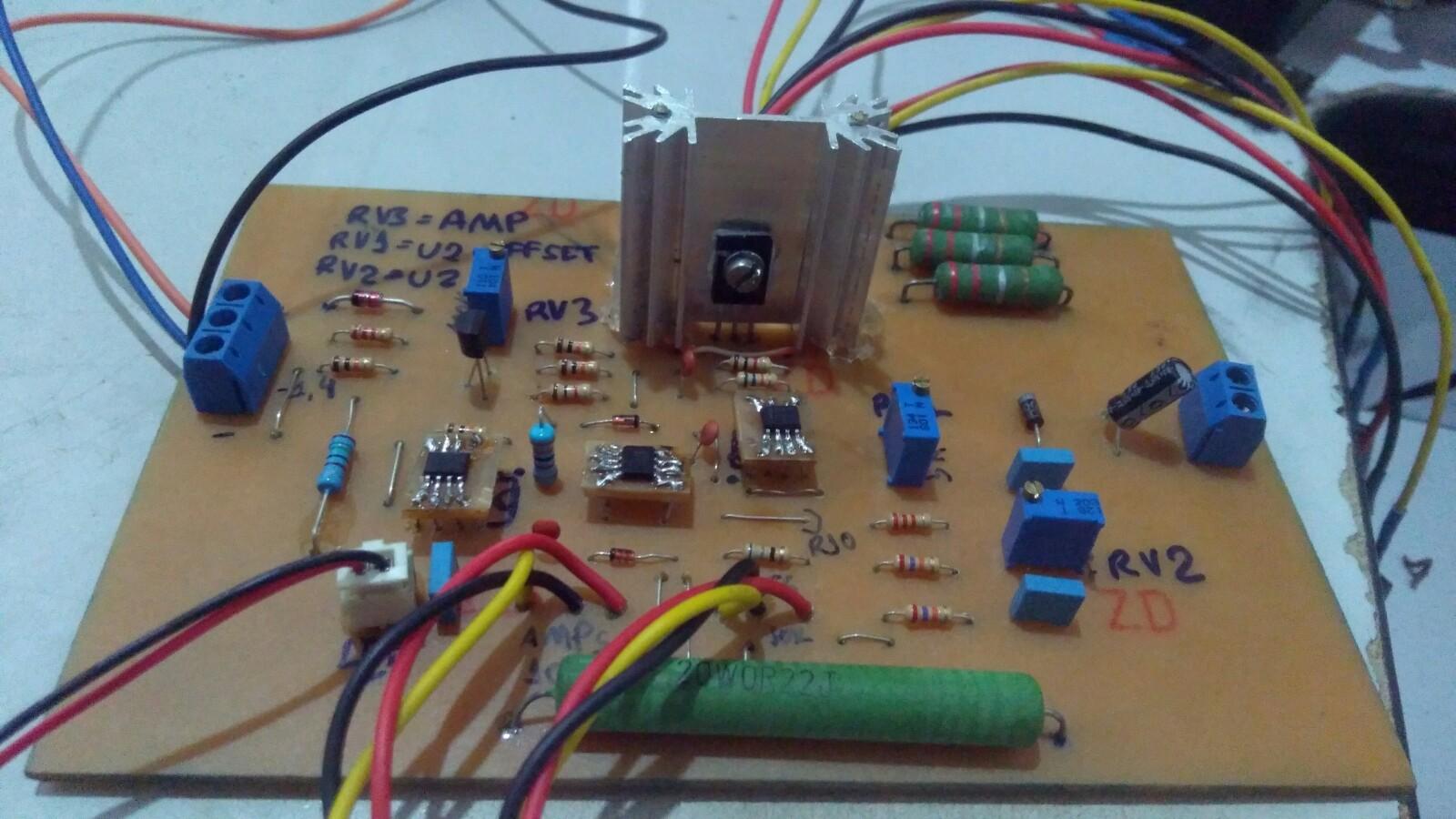

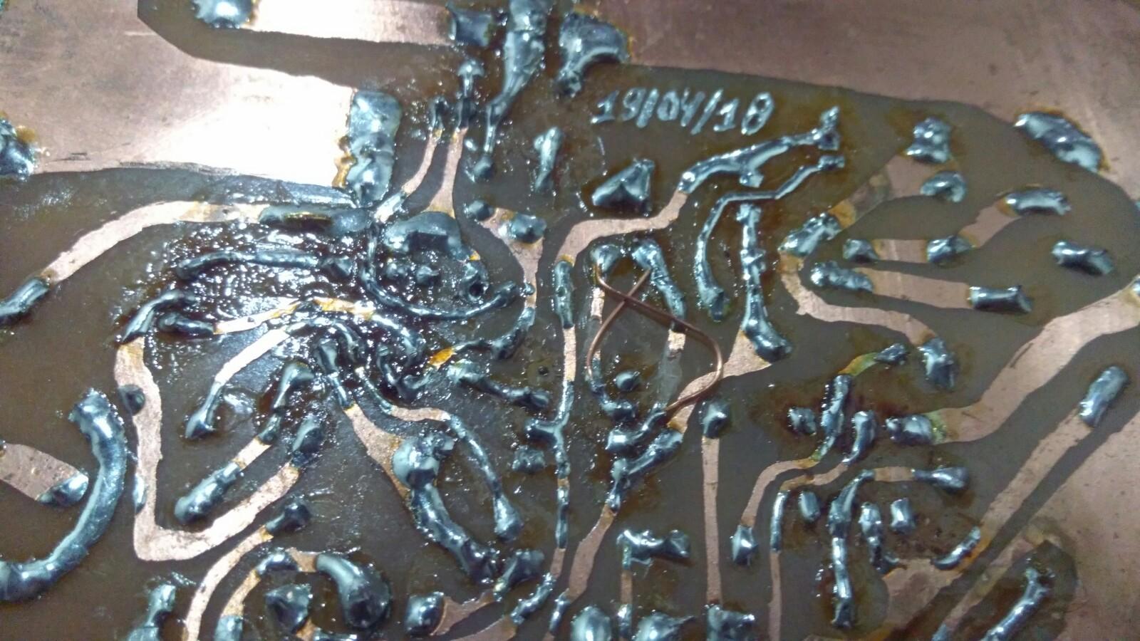

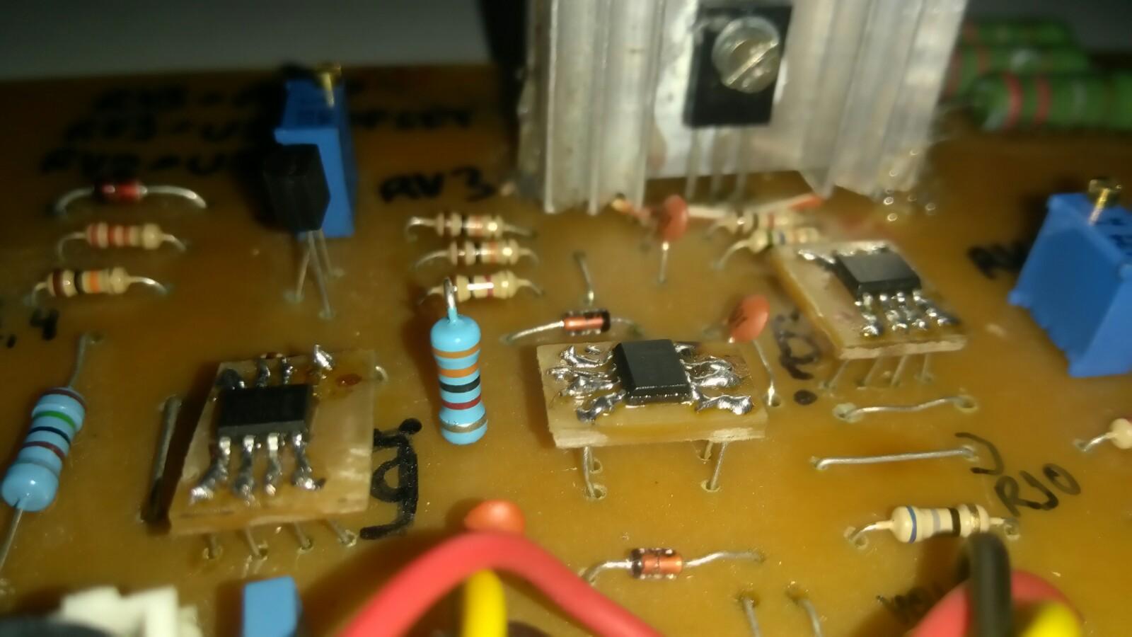

detonatorinf Posted June 12, 2018 Report Share Posted June 12, 2018 Wow! After long 4 months of waiting, my package with five TLE2141CP finally arrived from China. And for my "surprise" none of them worked. Both U1 and U3 got extremely hot and began to smell. Turns out two resistor got burned!! Just minutes ago i found a store in my country that sells the original MC34071. God... so much time wasted. I'm ordering them tomorrow ASAP. Just a advice for Brazillians interested in building this project. The online store Proesi is selling the SMD version of the MC34071. Quote Link to comment Share on other sites More sharing options...
audioguru Posted June 12, 2018 Report Share Posted June 12, 2018 I did not calculate it but I think a tiny surface mounted opamp for position U2 will get too hot if the hFE of the driver and/or output transistors is low. Quote Link to comment Share on other sites More sharing options...
detonatorinf Posted June 12, 2018 Report Share Posted June 12, 2018 2 hours ago, audioguru said: I did not calculate it but I think a tiny surface mounted opamp for position U2 will get too hot if the hFE of the driver and/or output transistors is low. U3 only outputs 0,640 volts. When the voltage control pot is rotated to the left or right, the variation in the readings are minimal. The voltage only raises to 10v when U3 gets too hot. U1 outputs 33v and also gets hot. RV2 has no effect on the readings. Quote Link to comment Share on other sites More sharing options...
audioguru Posted June 12, 2018 Report Share Posted June 12, 2018 My Rev 6 July, 2014 schematic shows that opamp U1 makes the 11.2V reference, U2 is for the voltage control and drives the output driver transistor with 0V to about +32V and U3 is for the current control and has an output from -1.0V to about +27V. If the output has a low voltage (or is shorted) and a high current then the NPN output transistor in U2 will get hot. A tiny little surface mount package cannot dissipate much heat. Quote Link to comment Share on other sites More sharing options...
detonatorinf Posted June 12, 2018 Report Share Posted June 12, 2018 4 hours ago, audioguru said: My Rev 6 July, 2014 schematic shows that opamp U1 makes the 11.2V reference, U2 is for the voltage control and drives the output driver transistor with 0V to about +32V and U3 is for the current control and has an output from -1.0V to about +27V. If the output has a low voltage (or is shorted) and a high current then the NPN output transistor in U2 will get hot. A tiny little surface mount package cannot dissipate much heat. Sorry. You're right. I confused the order of the ICs. U1 (reference voltage) outputs 33v and U2 (voltage control) outputs 0,640V to the base of the BD139. Quote Link to comment Share on other sites More sharing options...
audioguru Posted June 13, 2018 Report Share Posted June 13, 2018 1 hour ago, detonatorinf said: U1 (reference voltage) outputs 33V and U2 (voltage control) outputs 0,640V to the base of the BD139. No and No. U1 has a gain of 2 times and a 5.6V Zener diode. Therefore its output is 11.2V, not 33V. A 5.6V Zener diode does not change its voltage when its temperature changes but an 11.2V Zener diode increases its voltage if it gets warmer. The BD139 and the output transistors are emitter-followers. Their emitter voltage follows their base voltage but at high current, their base voltage is 1V to 1.5V higher than their emitter voltage. Then when the output voltage is 30V the output of U2 must be 32V to 32.5V. Quote Link to comment Share on other sites More sharing options...

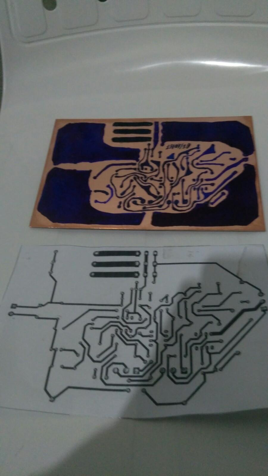

detonatorinf Posted June 22, 2018 Report Share Posted June 22, 2018 Sorry, audioguru. My post sounded like i was describing how the circuit should work but i was just explaining the behavior of the opamps. None of the 3 opamps were working as intended. The problem was caused by my lack of atention while copying the schematic to Kicad. The opamp footprint for U2 was printed with the negative and positive inputs inverted. Two jumpers solved the problem and now i have a working power supply. I attached some images. Really ugly, ain't it? But it was my first time learning how to make one. R7 resistance is 0R22. I couldn't find the 0R25 resistor recommended for a 5A power supply. Also, three 2sc5200 in parallel are used as output transistors. Quote Link to comment Share on other sites More sharing options...
audioguru Posted June 23, 2018 Report Share Posted June 23, 2018 Surface mount ICs on adapters? Solder that was dripped on from up high and heated with a blow torch? All I can say after seeing your project is "EEK!". Quote Link to comment Share on other sites More sharing options...
