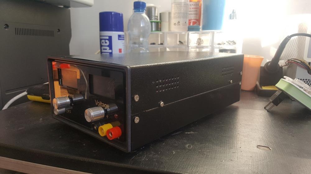

Amiir 0 Posted July 27, 2017 Report Share Posted July 27, 2017 hey guys. im new here. i made this power supply for my small workshop and i have some question about it. first Q : how can i add Fine volume for voltage and current! (Coarse and Fine) second Q : this circuit cut off the output voltage when we take more than 3.0 Amperes. its ok. but my transformer can deliver 4.0 Amperes and i want to change this cutoff option to 4Amp. third Q : can we use 24v 10a (or 30v 10a or 48v 10a) Switching power supply instead of transformer in input and make it more powerful ? thanks guys. in attachments you can see my power supply v1.0 i make this one for my friend and now im about make another one for myself. please answer my question. after completing the project i will upload Corel Draw files (Front and Rear Panel Plaxi Laser Cut) * That "Made in IRAN" is just for fun all parts purchased from china images are for v1.0. in this new one i made a lots of changes in front and rear panel. this one has no volt/amp meter yet. but the rectangular cuts are place for them. thanks guys and im sorry for my bad english Quote Link to post Share on other sites
audioguru 36 Posted July 28, 2017 Report Share Posted July 28, 2017 If you use fine and coarse controls then one will always be in the wrong position. Use larger knobs instead. Higher output current will cause a heat problem in the output and driver transistors. The improved version of this project already uses two output transistors to share the heat produced at 3A. Use a huge heatsink and a fan for 4A output. Change R7 to be 0.35 ohms/10W. A 24VAC transformer is too low for this project to produce 30VDC output at 3A or 4A but the original TL081 opamps will have a voltage too high for them if the transformer voltage is increased. The improved version of this project uses TLE2141 opamps rated at a supply of 44V and a 28VAC or 30VAC transformer. A transformer rated at 24V/4A has a limit of 24V x 3A= 72VA. But here the 24V is rectified to produce a peak voltage of 34V. Then if the load on this project is 3A the transformer produces 34V x 3A= 102VA. It must be rated for 102VA/24V= 4.25A. If the output of this project is 4A then the transformer must be rated for 5.7A. Quote Link to post Share on other sites
Amiir 0 Posted July 29, 2017 Report Share Posted July 29, 2017 On 7/28/2017 at 6:39 AM, audioguru said: If you use fine and coarse controls then one will always be in the wrong position. Use larger knobs instead. Higher output current will cause a heat problem in the output and driver transistors. The improved version of this project already uses two output transistors to share the heat produced at 3A. Use a huge heatsink and a fan for 4A output. Change R7 to be 0.35 ohms/10W. A 24VAC transformer is too low for this project to produce 30VDC output at 3A or 4A but the original TL081 opamps will have a voltage too high for them if the transformer voltage is increased. The improved version of this project uses TLE2141 opamps rated at a supply of 44V and a 28VAC or 30VAC transformer. A transformer rated at 24V/4A has a limit of 24V x 3A= 72VA. But here the 24V is rectified to produce a peak voltage of 34V. Then if the load on this project is 3A the transformer produces 34V x 3A= 102VA. It must be rated for 102VA/24V= 4.25A. If the output of this project is 4A then the transformer must be rated for 5.7A. thank you so much for your reply sir. forget about using hi amp switching power supply instead of transformer. it was just a Curiosity question. but about increasing the output amperes as you said for taking 4A from output i should change my transformer with 24v 5.7A. so if i use 24v 4A transformer then how much amperes i can take from output? cooling 2N3055 is not a problem. best heat sink and turbo fan used for that. each 2N3055 can handle how much amperes in best cooling situation ? Quote If you use fine and coarse controls then one will always be in the wrong position. Use larger knobs instead. in Chinese power supplies coarse and fine works well. they use same opamp and other parts for that. volumes are : Voltage Coarse : 50K - Voltage Fine : 5K Current Coarse : 10K - Current Fine : 1K Quote Use larger knobs instead. before i asking my questions here i decided to use larger knobs as you said. but fine volume works better. *i just completed the rear panel laser cutting file Designed with extreme accuracy. so if anyone use the box just like mine then he/she can use this files without any changes. but of course you can change it as you like. the front panel will be done soon. ebay link for used parts will be placed here. Quote Link to post Share on other sites
audioguru 36 Posted July 30, 2017 Report Share Posted July 30, 2017 If you use a 24V/4A transformer then its maximum allowed output is 24 x 4= 96VA. Then the project maximum output current must be calculated with the 34V peak voltage (96VA/34VDC= 2.8A). You can simply calculate how much heating (volts times Amps) a 2N3055 will survive by its thermal spec's and the heatsink thermal specs on their datasheets. Quote Link to post Share on other sites
Amiir 0 Posted August 11, 2017 Report Share Posted August 11, 2017 i dont understand. in projects Bill Of Material said use 24v 3a Transformer for making 0-30v 0-30a power supply. but u said if i use 24v 4a i will get 0-30v 2.8a !? how can its possible ? so if we use 24v 3a transformer we will get less than 2.2a! so its not 0-30v 0-3a dc power supply! the circuit current cutoff (short circuit protection) is 2a or 3a? if its 3a and we use 3a transformer for making project (taking 2.1a) its never cutoff the output for short circuits! anyway my heat sink were bought from local stores and they do not provide datasheet for this items! Quote Link to post Share on other sites
audioguru 36 Posted August 12, 2017 Report Share Posted August 12, 2017 The original Greek kit and the first Chinese copy wrongly said to use a 24V/3A transformer that does not work and becomes overloaded. Its voltage is too low for the project to produce 30VDC at 3A and its voltage is too high for the opamps with a low maximum supply voltage rating of only 36V. The original opamps also needed an additional negative supply with a fairly high voltage. We corrected the circuit and used opamps with a 44V maximum supply voltage rating and a 28V/4.24A transformer (the peak of 28VAC is 39.6V). With an output current from the project of 3A then the transformer must supply 39.6V x 3A= 188.8VA. Then the current rating of the transformer must be 118.8VA/28VAC= 4.24A. The improved circuit also works with a 30AC transformer and you can calculate its current rating needed. The current limiting is variable from about 2mA to 3A and has excellent current regulation. If the output is shorted then the current will not cutoff, instead it will be at the current setting. Many stores do not provide datasheets that are available online from the manufacturers. Wakefield is a heatsink manufacturer and has datasheets of all their heatsinks at their online site. Quote Link to post Share on other sites

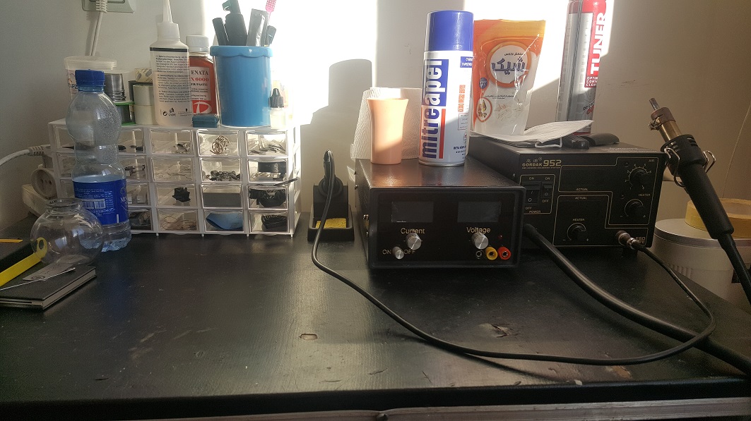

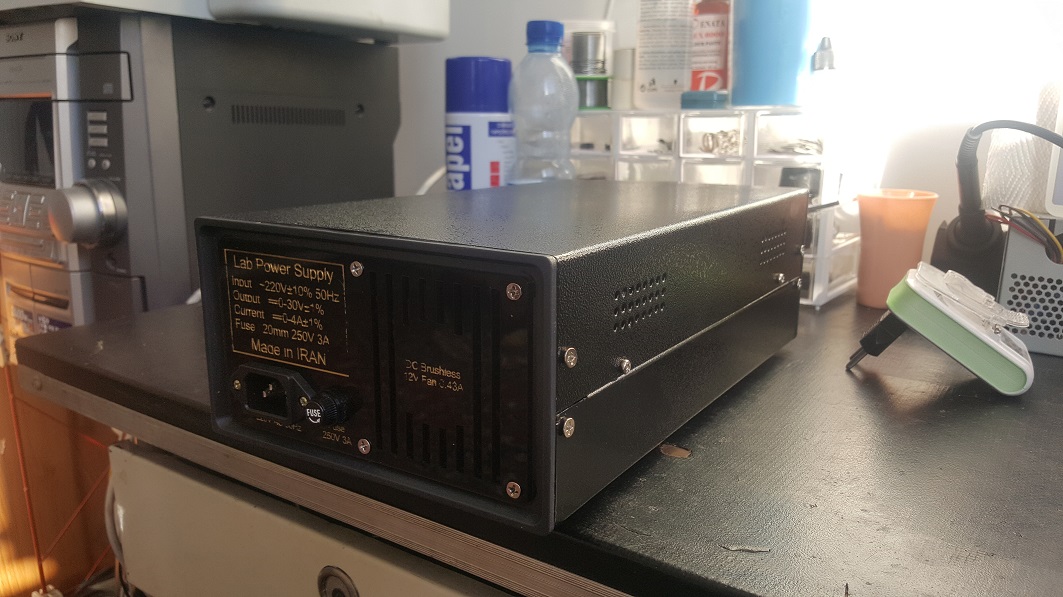

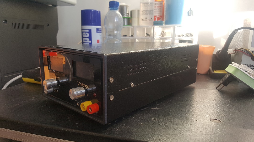

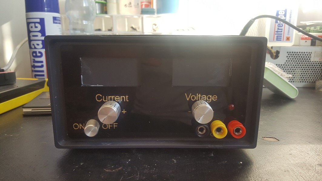

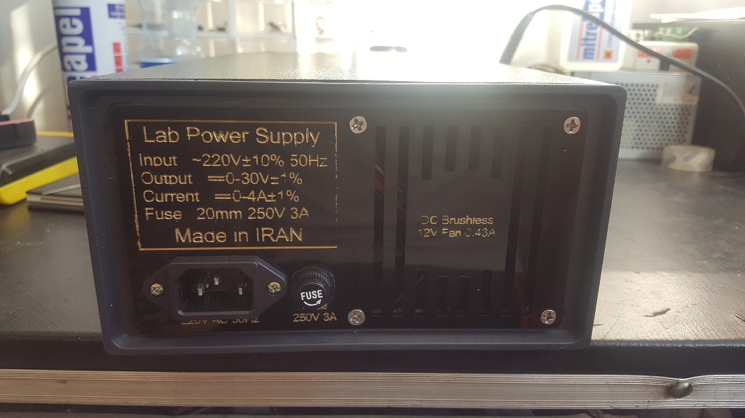

AJ777 0 Posted November 24, 2017 Report Share Posted November 24, 2017 I created the previous build for this project from this link : http://www.electronics-lab.com/project/0-30-vdc-stabilized-power-supply-with-current-control-0-002-3-a/ I couldn't get the required TL081 so I replaced it with TL071. Now the circuit works well and good. But I have some doubts : 1. The power transistor 2n3055 is connected to a massive heatsink, but the wires drawn from it are single lead wires. Im not sure of how much current it can carry. I did test the PSU using a 100 ohm 5a rheostat and found the transistor heating up. But even at 3a in the output, the wires drawn from the transisitor didn't burn off. I didn't test it for long duration. so my question is what wires should I replace in the connection. is the single lead wire capable enough to carry 3a? should I get multi threaded wire? If so, of what guage? 2. the PSU when loaded using rheostat couldn't reach the peak voltage of 30v. as soon as the rheostat was connected , the output voltage dropped to he range of 20-22v. Is there any way I can hold the output voltage in the value I deserve? or did the output voltage drop so as to limit the current using the current limiter circuit(which was not turned on when loaded, current knob kept at zero position. 3. how can I test the current varying capability ? at constant voltage obviously... help out a brother... cheers Quote Link to post Share on other sites
audioguru 36 Posted November 24, 2017 Report Share Posted November 24, 2017 The original project had many overloaded parts including the power transformer. It used TL081 opamps but your TL071 opamps are simply TL081 opamps selected fo low noise (audio applications). Their absolute maximum supply volyage is 36V but this project with a 24VAC transformer produces about 25VAC when the load current is low then its peak is 35.4V which is reduced to about +34V which is the positive voltage for some of the opamps and -5.6V is the negative supply for them. Then they get 34V plus 5.6V= 39.6V which is too high for these opamps so they will fail soon. The improved modified circuit uses opamps rated at 44V and the -5.6V supply is reduced to -1.3V. Of course the output transistor gets hot when loaded, even with a huge heatsink because it and the driver transistor are overloaded. The improved modified circuit uses a better driver transistor with a proper case that can be bolted to a larger heatsink and TWO output transistors are used to share the heat. Use a fan if you want. It is easy to find a table of wire size and the current it can handle, and use Ohm's law to calculate its voltage drop. Use #18 AWG wire and solid core or stranded are both able to carry many amps of current with a low amount of voltage drop. The overloaded transformer is rated at 24V x 3A= 72VA but needs a transformer that is 28V x 1.414 x 3A= 119VA instead then its voltage will not collapse when loaded. But then the 44V opamps must be used. It should be obvious to you that when the current setting is set low (you cannot turn it off) then any load current higher than the setting will reduce the output voltage. It should have excellent voltage regulation. If the current setting is 2A and you load the project with 1.5A then the output voltage might be 25.0V with the load and the voltage set to 25.0V and when the load is disconnected the voltage might rise to 25.005V, or be 25.0V with 2A and drop to 24.095V without a load. Quote Link to post Share on other sites
