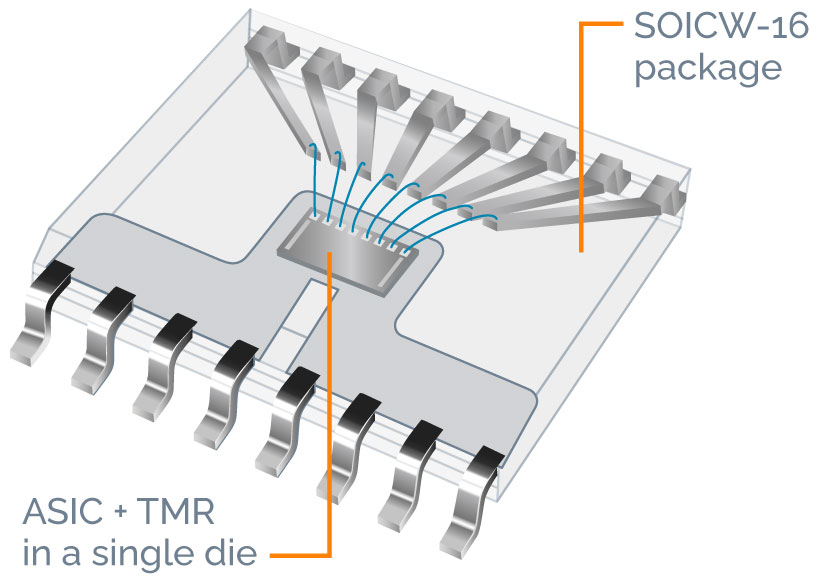

Crocus Technology 0A to 65A Integrated Current Sensors have a 1MHz Bandwidth and better than 1% accuracy. The sensors feature high-speed operation and accurate output to optimize system design for smaller sizes and higher efficiency.
Crocus Technology 0A to 65A Integrated Current Sensors have a 1MHz Bandwidth and better than 1% accuracy. The sensors feature high-speed operation and accurate output to optimize system design for smaller sizes and higher efficiency. The XtremeSense TMR sensor is a design solution that combines high bandwidth response and high accuracy.
  • Supports AC and DC
  • Resolution (SNR) <10 mARMS
  • Common mode field rejection
  • 1MHz bandwidth
  • High accuracy (up to ±0.5%)
  • Up to 5kV isolation
  • Over-current detection
