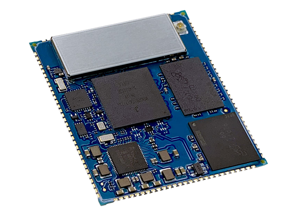

DIGI ConnectCore® 8M Nano System-On-Modules (SOM)
DIGI ConnectCore® 8M Nano System-On-Modules (SOM) are designed for industrial reliability and the 10+ year product lifecycles of embedded devices. These SOMs feature up to 4x power efficient Arm® Cortex®-A53 cores and 1x Cortex-M7 core that minimizes power consumption while maintaining a high standard of performance.
DIGI ConnectCore® 8M Nano System-On-Modules (SOM) are designed for industrial reliability and the 10+ year product lifecycles of embedded devices. These SOMs feature up to 4x power efficient Arm® Cortex®-A53 cores and 1x Cortex-M7 core that minimizes power consumption while maintaining a high standard of performance. The 8M Nano SOMs feature TrustFence® for critical security and data privacy capabilities, XBee® integration, and Remote Manager® for remote monitoring and management. These SOMs operate at -40°C to 85°C temperature range, -50°C to 125°C storage temperature range, and 5%RH to 90%RH (non-condensing) relative humidity range. The 8M Nano SOMs are used in a wide range of industrial, medical, agricultural, transportation, Internet-of-Things (IoT), Human-Machine Interface (HMI), edge computing, and machine learning.
  • Peripherals/interfaces:
    • 1x USB 2.0 OTG controllers with integrated PHY interfaces
    • 3x Ultra Secure Digital Host Controller (uSDHC) interfaces
    • 4x Universal Asynchronous Receiver/Transmitter (UART) modules
    • 4x I2C modules
    • 3x SPI modules
    • 1x Quad SPI
    • 10x PWM channels
    • 1x 16-bit ADC module with accurate internal voltage reference, up to 20 channels
    • 5x Synchronous Audio Interface (SAI) modules supporting I2S, AC97, TDM, codec/DSP, and DSD interfaces
    • 1x S/PDIF input and output, including a raw capture input mode
    • 8-channel Pulse Density Modulation (PDM) input
    • Up to 112 GPIOs
  • Power management with both hardware and software support for low-power designs
  • Application processor:
    • NXP® i.MX8 Nano
    • Up to 4x Cortex-A53 cores at 1.4GHz
    • 1x Cortex-M7 core 600MHz core for real-time processing
  • Memory:
    • Up to 8GB eMMC, up to 1GB of LPDDR4 (16-bit)
  • Security:
    • Digi TrustFence®, TRNG, TrustZone, secure RTC, secure JTAG, and secure element
  • Seamless cellular modem and Digi XBee® integration
  • Bluetooth 5 support
  • 1×1 802.11a/b/g/n/ac dual-band wireless Wi-Fi
  • 1x 10/100/1000M Ethernet + AVB
  • -40°C to 85°C industrial operating temperature range
  • 5%RH to 90%RH (non-condensing) relative humidity range
