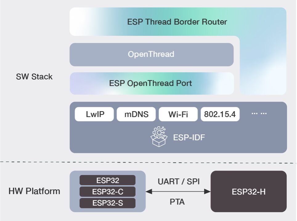

The ESP Thread Border Router supports the latest Thread 1.3 standard, including features like IPv6 connectivity, service discovery, multicast forwarding, and NAT64. Additionally, it offers product-ready functionalities such as a web configuration interface, automatic updates, and optimized radio performance.

    • Interfaces (ESP32-S3 <-> ESP32-H2):
      • UART, SPI
      • RESET, BOOT
      • 3-wire PTA for RF coexistence
