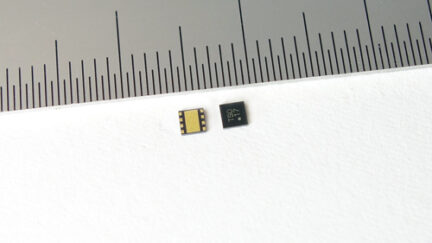

MORNSUN has introduced two new drivers SCM1201BTA and SCM1212BTA that feature integrated MOSFETs for the primary side of a push-pull power and can be used in the 1-2W applications with 3.3V and 5V inputs. These new series with wide input voltage range of 2.7-5.5V will not be damaged even under the high input voltage up to 9V within 1s.
These devices contain, two drive systems and two power MOSFETs that are highly symmetrical and reduce the degree of magnetic bias in the push-pull topology. Moreover, these drivers are integrated with three key technologies to improve reliability meet the AEC-Q100 automobile standard to ensure reliability.
