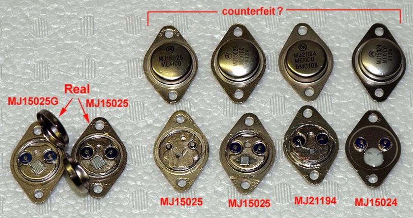

Something went wrong now  ???
U2 is always at 30 V in the out pin, the opamp is ok, voltage in the pin 3 is variating normally.
I'm lost  :p
Edit:
Found it! Those crappy transistors burned without even get much warm.
Fake parts? Never heard of this brand.

LOL, I expect find something worst inside that (yeah, I'm open it).
Now I'm with ST transistors.  ;D

Look the difference.
audioguru2
Apr 6, 2004
12,026
Apr 6, 2004
12,026
The MJ21194 has very powerful specs on its ON Semi datasheet. But yours has a tiny little chip inside and is marked Mexico and with the same date as the cheap ones sold by a Chinese company shown in Google Images. Why are American transistors made in Mexico sold cheaply in China?? Because they are fakes?
The name Motorola Semi was changed to ON Semi in 1982 when all their transistors became marked "ON" instead of "M". Maybe counterfeiters don't know that.
Here is an expert who discusses fake transistors: http://sound.westhost.com/fake/counterfeit-p1.htm
