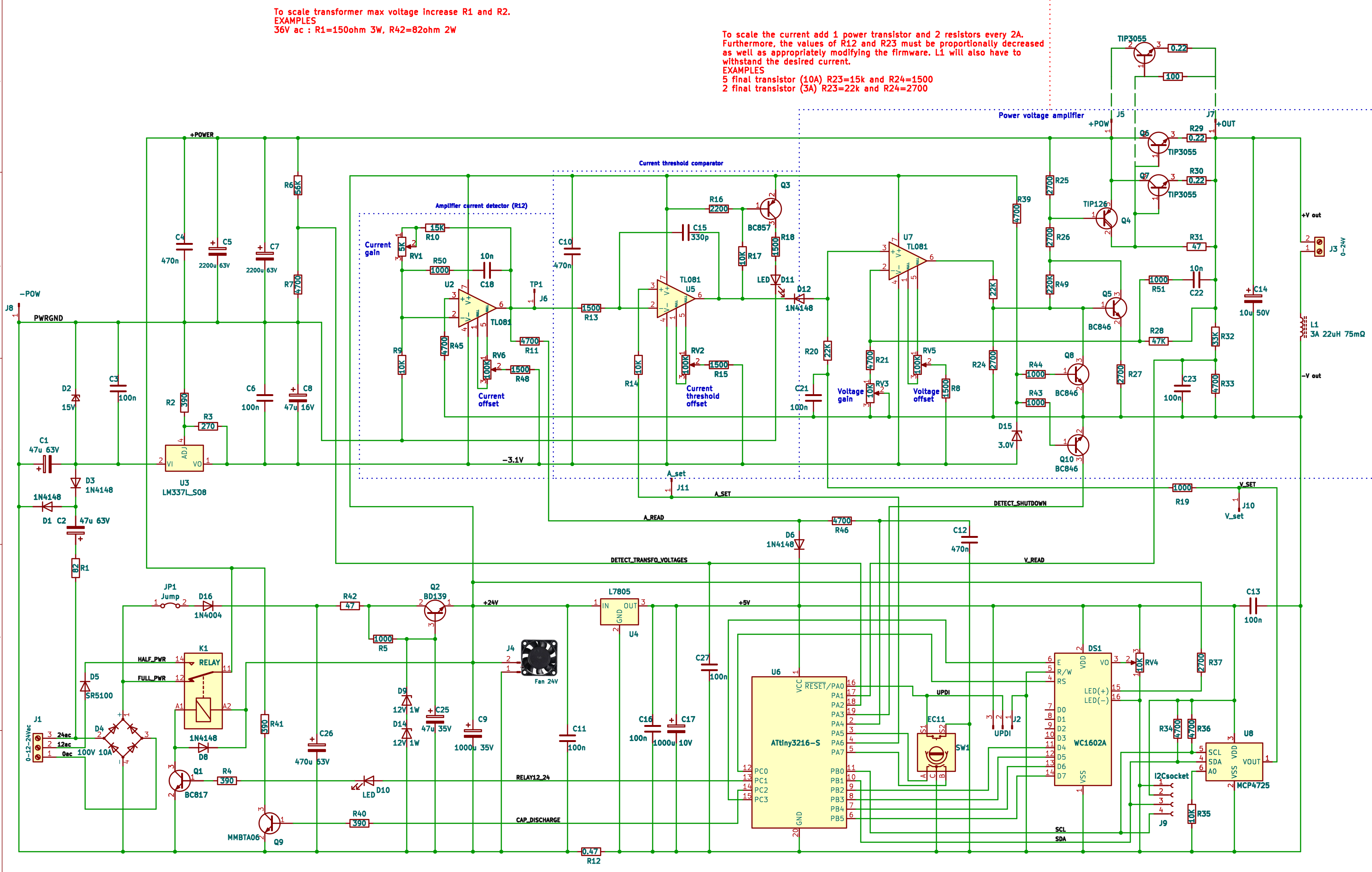

Hi everybody,
I improved by digitizing this circuit and replaced the final stage with that of the equally famous K7200.
You can scale it both in voltage and current by changing a few components because the three opamps are always powered at 27V
Sorry, article is not complete and not yet translated into English
