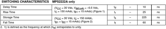

Hi Liquibyte,
On your measurements it looks like Q1 turns on a little too late to completely squash the voltage spike but it reduces it a little.
Are we barking up the wrong tree?? (I haven't said that for about 50 years)
Without Q1 the 'scope photo from Redwire shows 24MHz ringing when the power is turned on and when it is turned off. But in post #? (this site does not have post numbers) he shows no ringing when he replaced U1 with a voltage regulator. I don't think he uses Q1.

Here's the fun part.  The board he sent me and the one I'm doing this testing on is the one with the linear regulator on it in place of U1.  I've added Q1 into this board but perhaps I'm not using a fast enough transistor.  The one I'm using is from Radio Shack which is marked on the package as a 2N2222A but is more than likely a MPS2222A made by either Motorola or ON Semi.  I found the datasheet here, sorry they zipped this one for some reason.  The package came with 3 types, 2N4401, 2N3904 which is actually a MPS3904, and the above 2222.  I have a few others laying around that I got in a grab bag from Jameco to play around with but would have to look up datasheets to see if I can find something faster.
From oldest reference of the added regulator to the newest that I could find quickly.
http://www.electronics-lab.com/forum/index.php?topic=19066.msg1016994#msg1016994
http://www.electronics-lab.com/forum/index.php?topic=19066.msg1017015#msg1017015
http://www.electronics-lab.com/forum/index.php?topic=19066.msg1017302#msg1017302
MPS2222A_datasheet_2.pdf
  • MPS2222A_datasheet_2.pdf

Doesn't the linear regulator eliminate the voltage spikes caused by U1? Redwire said it did.
Does the linear regulator produce less noise than the zener diode/U1 circuit?
When the mains power is turned off then the 47uF filter capacitor C3 for the negative supply takes time to discharge. The speed of any little NPN transistor is much faster.
Then the slow discharge time of C3 delays activation of Q1. Then the voltage spikes are not completely squashed.
When a powered inductor is suddenly unpowered then it produces a voltage spike.
Then does a powered transformer that is suddenly unpowered when its mains current is at a peak also produce a voltage spike?

I think the bigger issue here is the surge that's happening.
I have also been told that keeping the TLE2141 at its limit may be causing unexpected issues and reliability could be an even bigger issue.  U3 probably isn't going to suffer as much from this due to D13 but the other two may.  I'm starting to think that xristost was on the right track with his V3 with it's positive and negative regulators and more common op amps.
The bottom line is that I'm getting a transient at 61V at the V+ inputs of U1 and U2 on power up which is why I can't seem to eliminate the spike at the output which can't be good for the op amps by any stretch of the imagination.
While a few people have tested this design and at least two are in the process of doing so, no one has really documented the results.  Since you've never built one and are relying on the math to fix the design I'm not too confident that this is working out.  Having said this, I'm in no way saying that you're calculations are wrong but I'd have more confidence on the redesign if it had been built and tested by you personally and as you've stated several times that you haven't, well...  I guess what I'm saying is that while the original design may have been bad, this one is still not finished.  I know you're going to get pissed for me saying this but the reality is different from the theory and I've got issues that the theory isn't addressing.
At the point where I can see no transient issue at the output I'll recommend people build this but at this point I suggest anyone wanting to build this, other than trying to help fix the issues, to stay away from it.  It's a waste of money for no added benefit over just buying something off the shelf that works.
