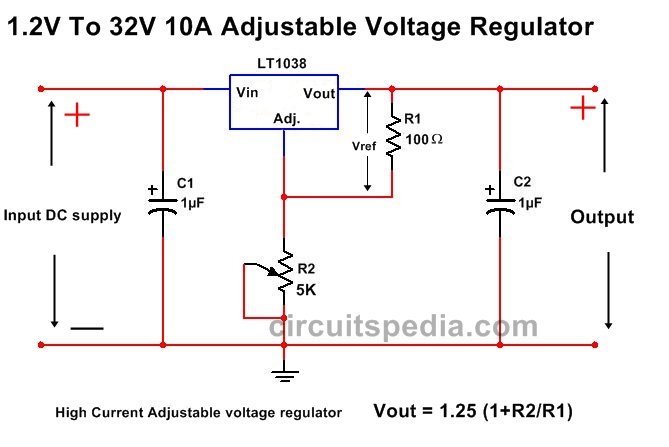

10A High Current Adjustable Voltage Regulator using LT1038
http://www.circuitspedia.com/10a-high-current-adjustable-voltage-regulator-circuit-diagram-using-lt1038/

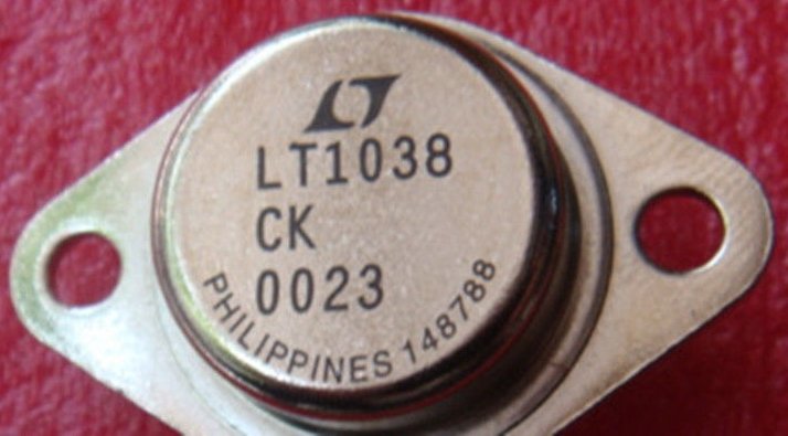

Why do you show an LT1038? it is obsolete and is not made anymore.
It is impossible for it to dissipate 32V x 10A= 320W. Its datasheet shows that with a huge heatsink with fan or with liquid nitrogen for cooling it can dissipate only 120W. Its control circuit gives 10A only when its input to output is a few volts and cuts the max current to 2.5A when the input to output is 30V.
