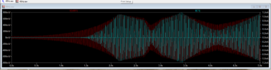

red is before the diode and after the signal generator and green is between the cap and ground!

Hello,
What happens in the envelope?
What kind of diode do you use?
A shottky diode has a smaller voltage drop.

Your first question, I don't know I don't see anywhere else to put the probe apart from after the diode and before the cap and resistor, which yields a flatline at zero volts, secondly just the standard one from the from the button at the top of the LTSpice program I'll put in a shottky now

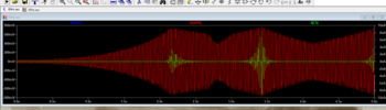

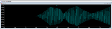

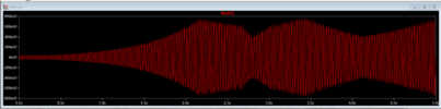

before the diode and after the signal = red
after diode and before cap and resistor = green
after capacitor = turquoise
signal before diode (red) after cap (turquoise)1702072109746.png1702070748668.png

Hello,
You used a resistor of 1 mili ohms in stead of 1 mega ohms.
Try the attached .asc and see what happens.
