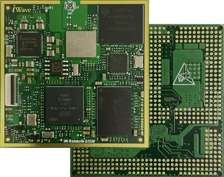

iWave launches iW-RainboW-G50M: The Solderable NXP i.MX 93-based LGA System on Module (SoM). The SoM incorporates NXP’s powerful i.MX 93 applications processor and is built on the OSM v1.1 solderable SoM standard, providing extensive interfaces in a rugged and compact form factor.
iWave launches iW-RainboW-G50M: The Solderable NXP i.MX 93-based LGA System on Module (SoM). The SoM incorporates NXP’s powerful i.MX 93 applications processor and is built on the OSM v1.1 solderable SoM standard, providing extensive interfaces in a rugged and compact form factor. Evaluation Kits of the System on Module will be ready to purchase in March 2023.
NXP’s i.MX 93 SoC is the first in the industry to integrate the Arm® Ethos-U65 microNPU and the first in the i.MX Family to integrate the scalable Arm® Cortex®-A55 core features the latest Armv8-A architecture extensions with dedicated instructions to accelerate machine learning (ML).
Key features of iW-RainboW-G50M
  • NXP i.MX 9352 SoC
    • 2 × Cortex-A55 + 1 × Cortex-M33
    • NPU up to 0.5 TOPS
  • 2GB LPDDR4X RAM & 8GB eMMC Flash
  • 2-Lane MIPI-CSI and 4-Lane MIPI-DSI Interface
  • 2 x RGMII, 2 x CAN-FD, 1 x LVDS
  • 1 x USB 2.0 OTG, 4 x USB 4.0 Host
  • Wi-Fi 6 & Bluetooth 5.2 Connectivity
  • Size-L Form Factor: 45mm x 45mm
  • Solderable LGA Package in OSM v1.1 Standard
  • 662 Contacts
The System on Module is built on a 45mm x 45mm OSM Size-L standard with the provision for 662 contacts, offering the highest pin-to-area ratio across SoM standards. With the ability to directly solder the SoM onto the carrier card, the SoM ensures high levels of robustness and is ideal for products prone to vibrations.
The SoM supports the MIPI-CSI camera interface to leverage the integrated NPU while supporting a 4-lane MIPI-DSI with 1080p60 resolution for 2D graphics processing through a high-efficiency pixel pipeline. The availability of high-speed interfaces such as USB 2.0, Gbit ethernet, and CAN-FD makes the SoM ideal for industrial and automotive market segments.
