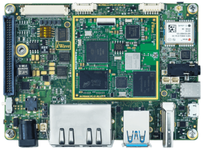

The System on Module is built on a 45mm x 45mm OSM Size-L standard with the provision for 662 contacts, offering the highest pin-to-area ratio across SoM standards. With the ability to directly solder the SoM onto the carrier card, the SoM ensures high levels of robustness and is ideal for products prone to vibrations.
“The i.MX 91 applications processor family from NXP provides an ideal mix of high performance, pricing, and security; fit for entry-level Linux edge processing solutions for applications such as EV Charging Stations, Industrial Gateways, and HMI Displays,” said Immanuel Rathinam, Vice-President of System on Modules Unit at iWave.” The i.MX 9x family of i.MX 91 and i.MX 93 provides customers scalability with reduced development cost and time to market and provides consumers with efficient power management and advanced security features on the edge
The i.MX 91-based System on Module is integrated on a carrier board, which is positioned as a Single Board Computer and also doubles up as an evaluation kit. The production-ready Single Board Computer is built on a Pico-ITX form factor and integrates the necessary interfaces for applications such as smart home hubs, metering gateways, and industrial automation solutions.
Key features of the Single Board Computer
  • NXP i.MX 91 SoC
  • 2GB LPDDR4 RAM, 16GB eMMC
  • Wi-Fi 6 & Bluetooth 5.3 Connectivity
  • 15.4 Connectivity
  • GNSS receiver Module – GPS/GLONASS/Galileo/BeiDou
  • Dual 1000/100/10 Mbps Ethernet
  • USB 2.0 OTG (microAB Receptacle Connector) x 1
  • Dual USB 2.0 Host (TypeA) x 1
  • USB Header x 1 & USB Type-C Connector x 1
  • Micro SD
  • 5mm Audio In & Out Jack through I2S Codec
  • 2 Connector Key B
  • Expansion Connector – UART, CAN, ADC, Tamper, PWM
  • RS232 Header x 1
